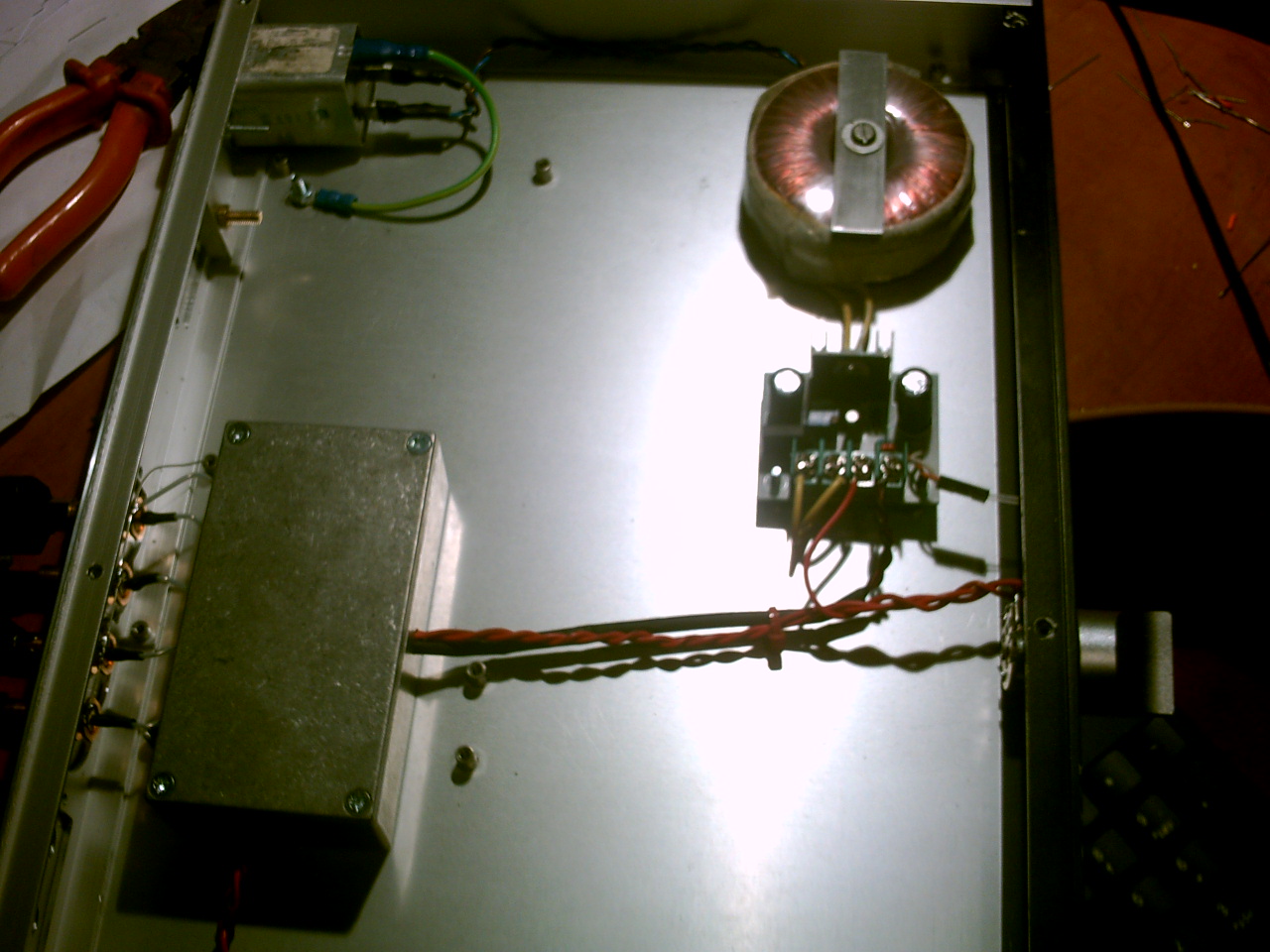

Hi
I very occasionally have a balance problem too so I get up and adjust the balance knob and sit back down again - it's excellent !!
The lightspeed is of course inside the small box - installed after George worried me about temperature fluctuations and the effect on the LDR's
Needless to say, it's still one of the best things I've put in my system.
( Before you say anything....I agree the LM317 based power supply is cr.. but I'm going to do something about it soon )

The box you have the LDRs and (I assume) wax in looks pretty nifty. Maybe I should try that, plus you get some shielding if you ground the box. I have not had a transformer inflicted noise problem in my short memory but people that put the LDRs in DCB1 configurations often seem to have to reposition their transformer to get the noise to go away. Your box would do the trick and allow a smaller enclosure since transformer could be close to the LDRs.

Andrew hi, I don't know about a LM317 based power supply, but the one that's in the production Lightspeed Attenuator is double regulated, first with a 12v regulated 300-500mA transformer plug pack this is of course external, then this feeds via a 2.1mm plug to the socket on the Lightspeed Attenuator then inside the alloy shielded chassis we have a secondary 5v regulated super smoothed power supply (no transformer), based on National Semi Conductors or TI (Texas Instruments) LM7805.
We have found in listening tests 2 years or so years back with about 40 x "golden ears" at an audio club meeting, that there was no conclusive difference between the standard power supply that comes supplied, when compared on a very high res system directly on the run to pure dc Lithium Ion battery, which was large enough to power 10 x Lightspeeds.
Only a half a dozen "golden ears" thought they could detect something but were not sure, those same "golden ears" have their own Lightspeed Attenuator's and are using the supplied power pack, not battery.
Cheers George
The little box was only installed to add an element of resistance or insulation to heat / cold - of course I also hoped it would maybe add some shielding from it's basic ps and the amps underneath it.
I have not had to touch it in the months I've had it - just the odd tweak to the balance.
George, if I improve the PS further ( a proper one ) can I really expect anything in the way of seriously noticeable sonic gains...like...wow.. sort of improvements ?
I don't mind either way - I'm a very satisfied user already, period
Andrew

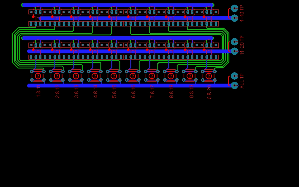

Okay,
Was contemplating this and now am sure I am going to do it. I am going to offer you guys a board/circuit to match your own LDRs so you can build as many Lightspeeds as you want. This way instead of paying me a matching fee you can buy 20 or so LDRs with your money plus the kit and for the rest of your life have the ability to match LDRs for your project/s.
It will be able to match 10 or 20 at a time. Will have a spot for your DMM to connect to and a momentary switch for each LDR. This way you plug them all in to their on board connectors and wait for them to warm up. Then attach your DMM to the clip-ons and hit a momentary switch for each LDR. Your DMM will tell you the resistance of each LDR as momentary switch is engaged and voila you have matched LDRs for you and maybe even your good buddy who you are kind enough to share your LDRs with :)

Test setup
I like LM334 and they are cheap. Board will have several of those on board with trimmers on each of them to set current and I think I will do a current sense resistor so you can test at exactly the same current again if you like. I have not used that ever in testing in the past but it sounds like a good idea right now. So you may actually come back tomorrow and test, as long as it's in same temperature, at exactly the same current output. Maybe a big zener before the current sources to set voltage and a 9V as a supply. No, I dont think batteries are the best for an LDR attenuator but certainly a fine solution for a test board. I could put a led string after the zener to ground with a 10k or so series resistor to the LEDs so that once it falls below the zener voltage the LEDs will dim significantly and then shut off. Well, maybe better to give the string their own zener 1Volt higher than the current source' zener so we dont go testing LDRs at to low voltages. Small on/off switch of course.
Probably any more complex than that is getting silly.

DIY LDR TEST JIG FOR LIGHTSPEED BUILDS
Probably all I will do today.
Its double sided so not all circuitry is obvious but there is not a lot to see either.
You might notice 3 test points. The ALL TP you leave your DMM lead on that one for the whole procedure. The 1-10 the other DMM lead attaches to when testing LDRs 1-10 and obviously switch that same DMM lead over to 11-20 when testing the last 10. This saves a little board space and a bit of cash because we get to use the same momentary switch to test two LDRs rather than just 1.
Imagine 2 resistors in series. To find the value of the first you tie DMM to the middle where they meet and then to the other side of the first resistor and then leave the DMM lead in the middle and move the other to the end of the second resistor to measure it. Same idea here.
Dont worry about the traces being a few inches long. It will make only milliohm differences which we dont care about.
I now have to add power supply circuitry but figured I would give you a look.
