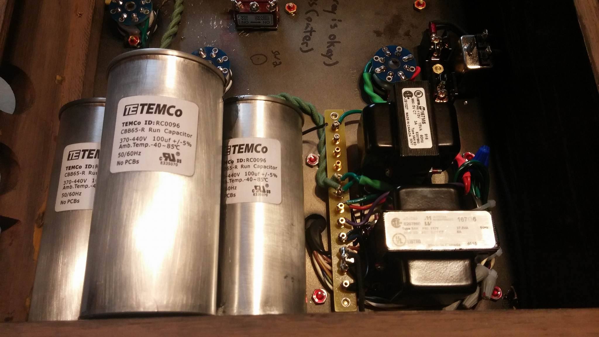

Regarding the capacitance of the PS; I already have the capacitors listed in the schematic.. would there be any detriment to having that much capacitance? I can fit them in the chassis (it's quite large).

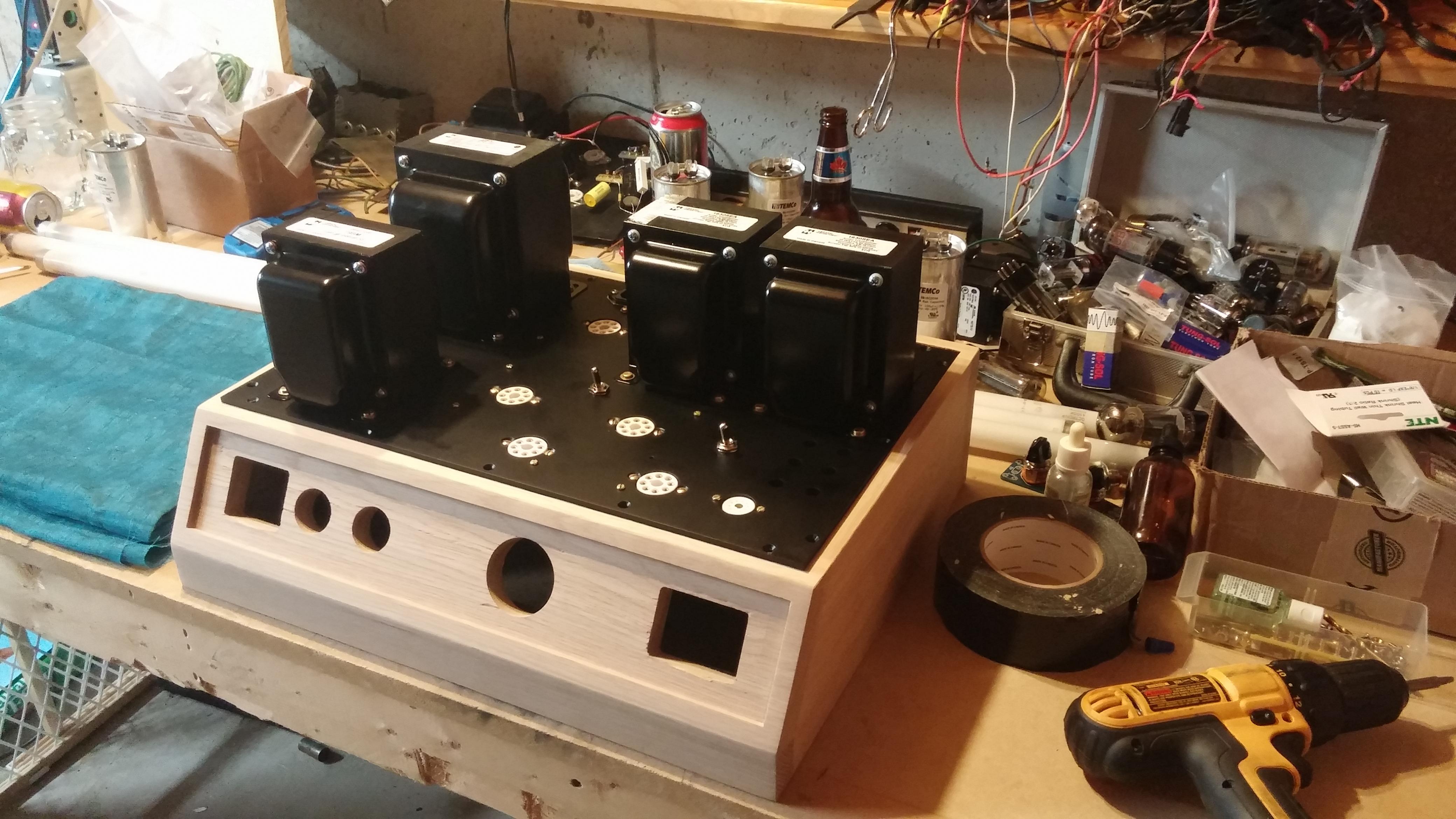

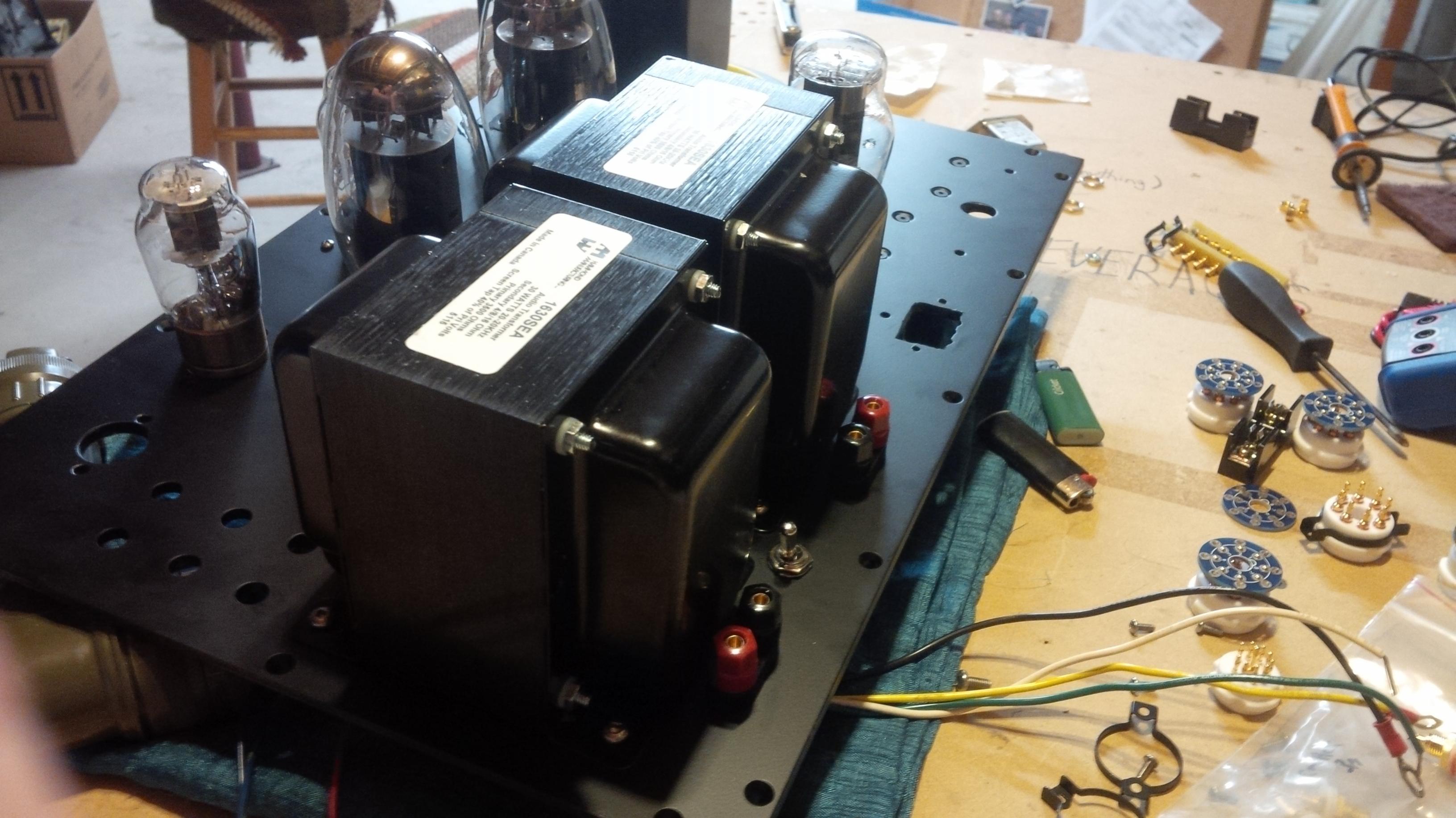

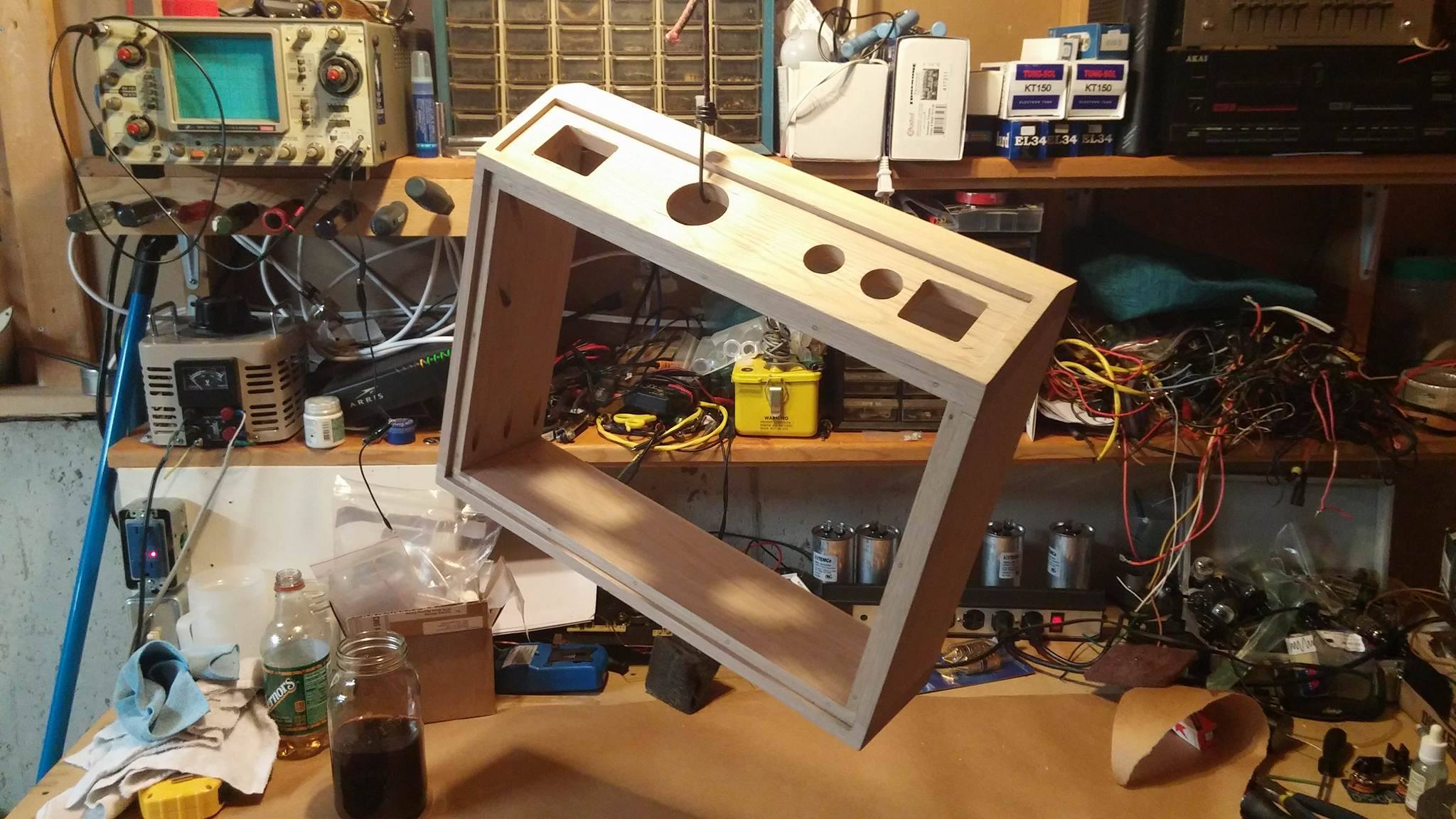

Rough assembly, making sure everything fits. Already found something that doesn't! Replacing all the stainless steel fasteners with brass.

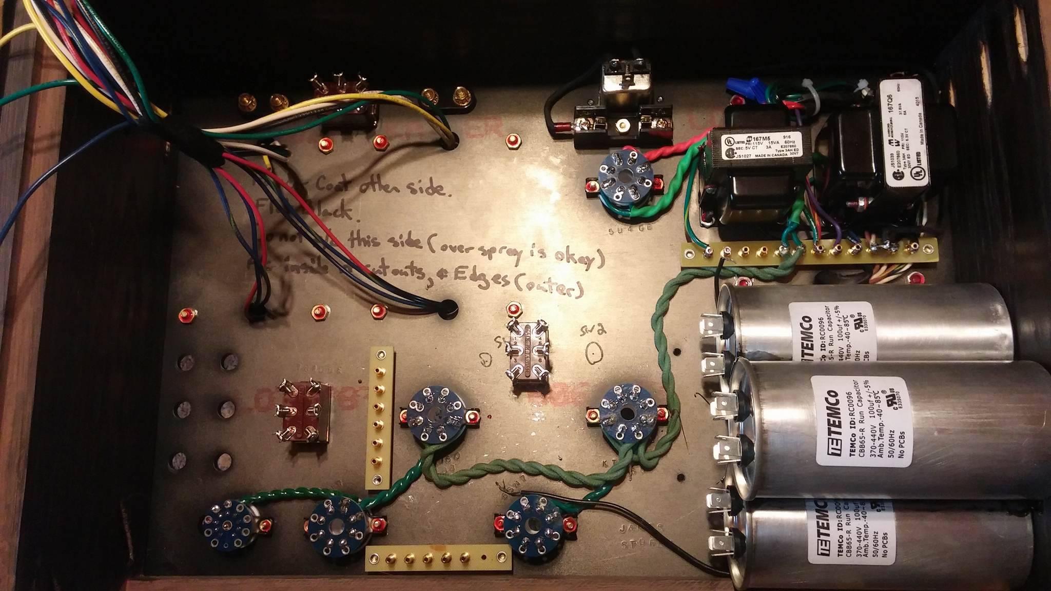

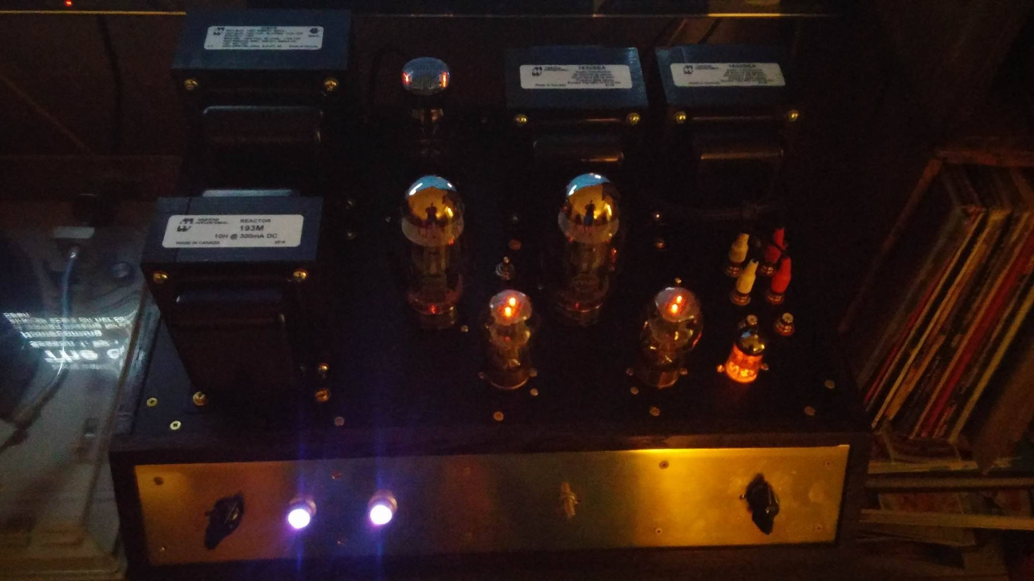

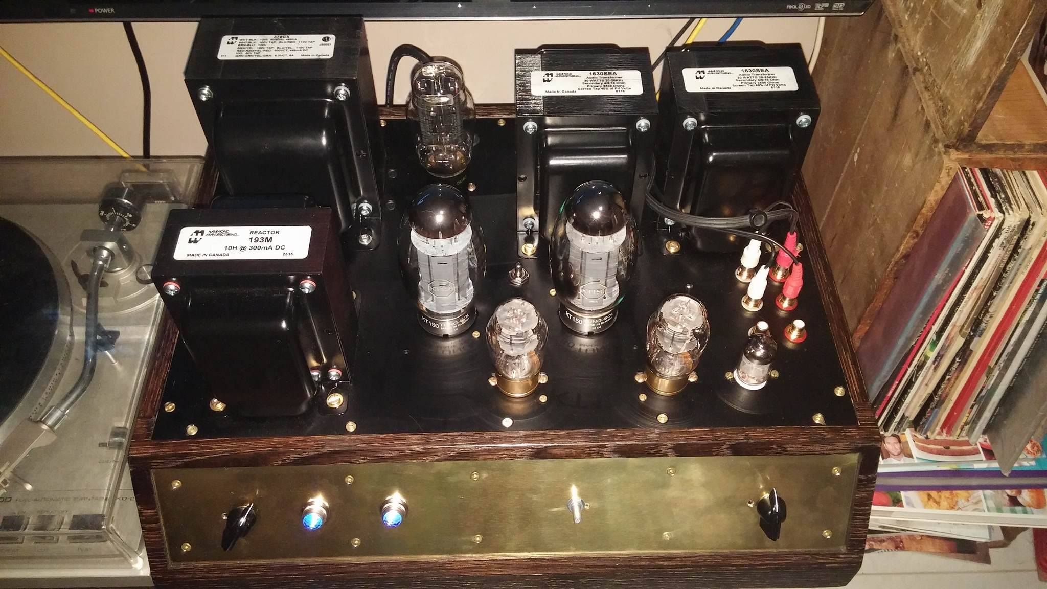

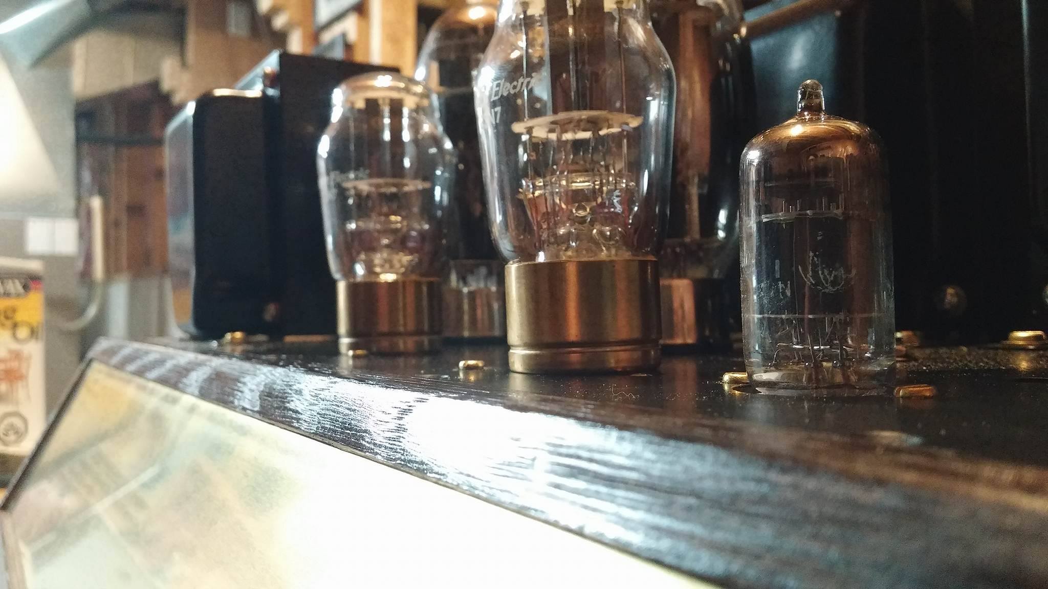

It's Alive
Well, it's alive. It amplifies.
The circuit ended up being slightly different then the schematic I posted earlier, so I will post an updated version of the schematic when I've tweaked it to my satisfaction. The basic topology is still parallel 6SN7's driving KT150/KT120/KT88/6L6GC/EL34 power valves in U/L or Triode mode.
Power output is a little low, I think I need to refine some of the values to get more gain. Sound is CLEAN though, definitely loud enough for living room use.

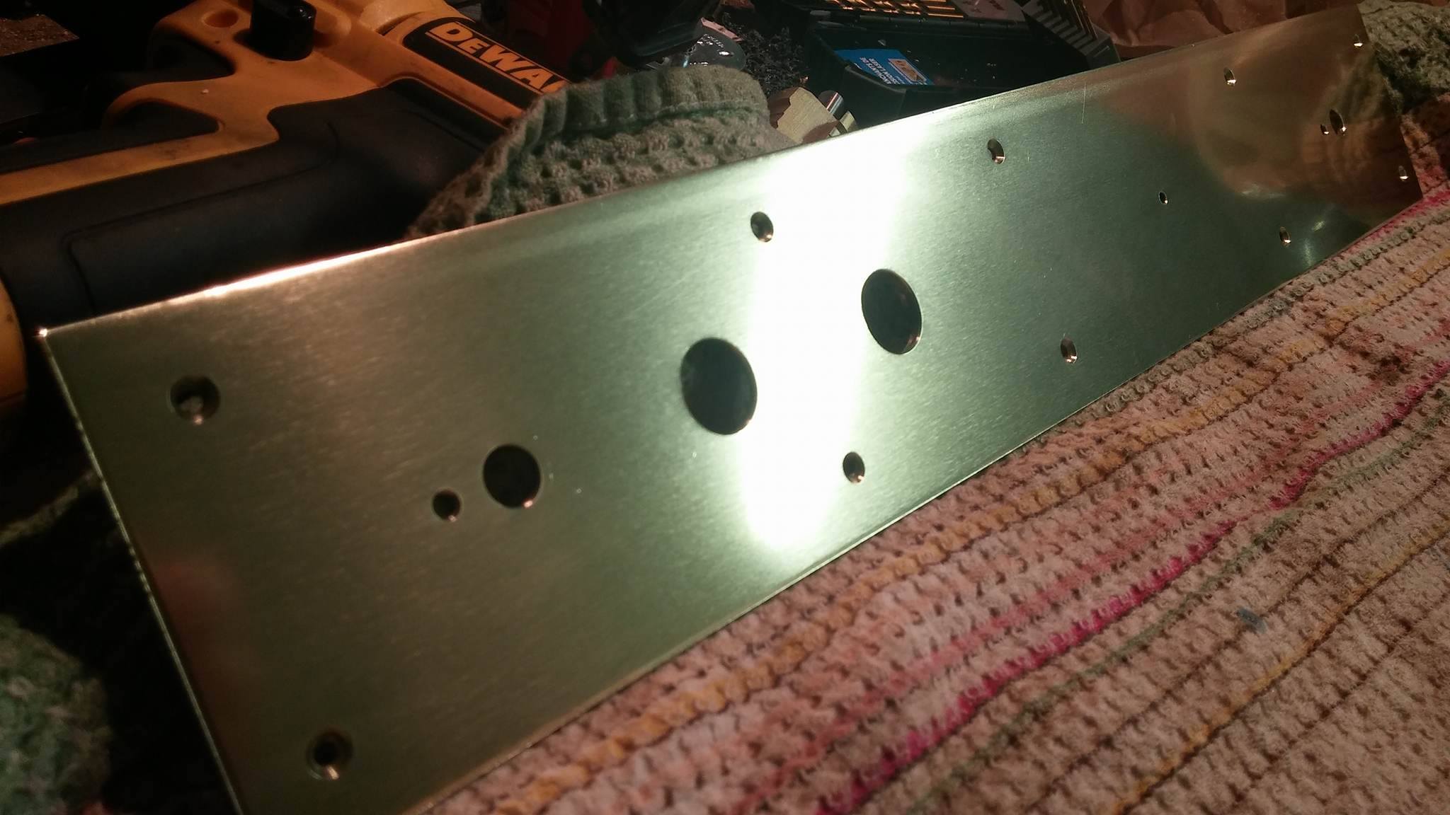

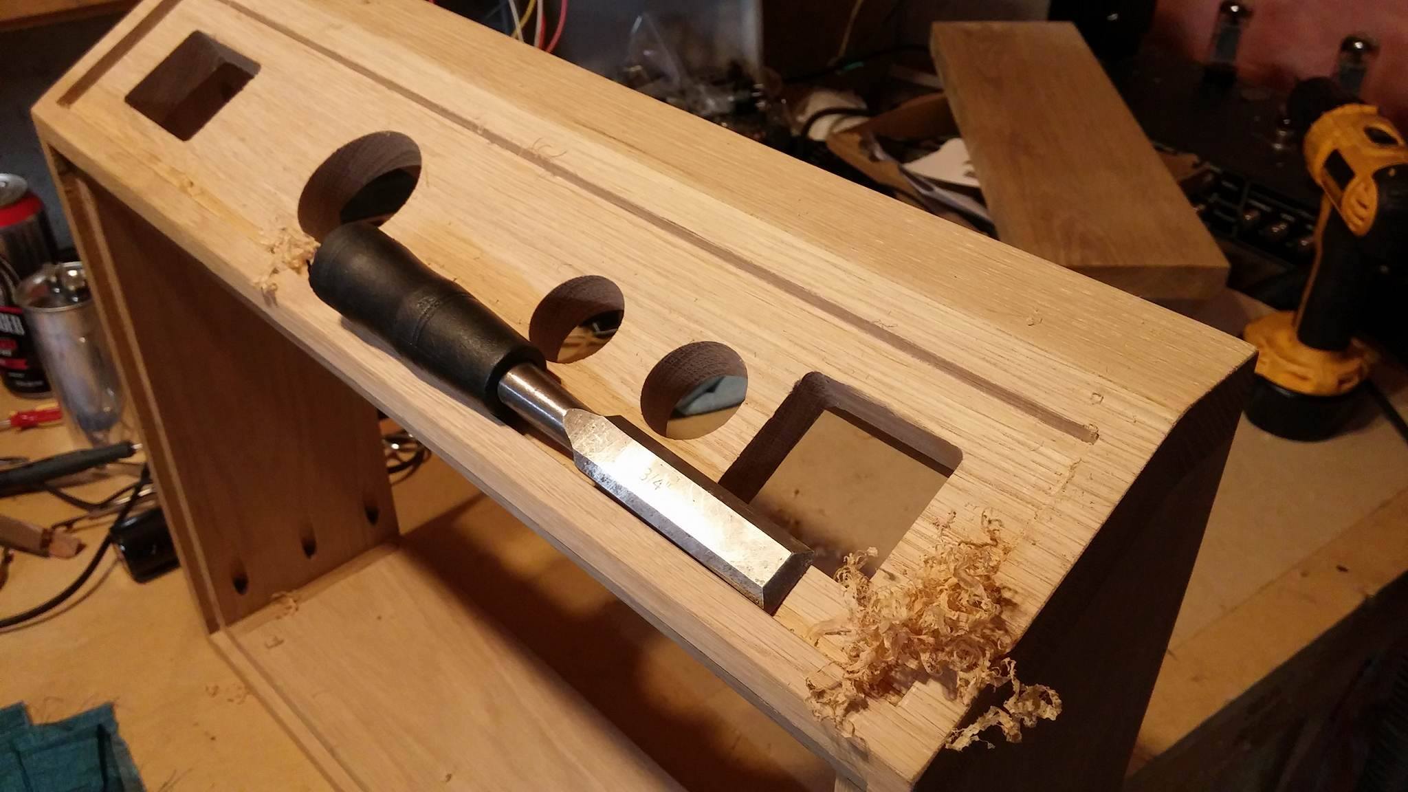

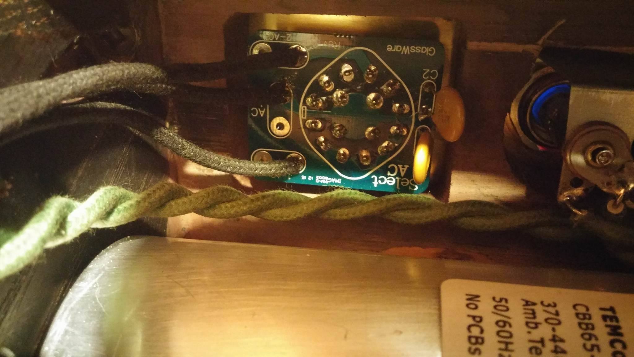

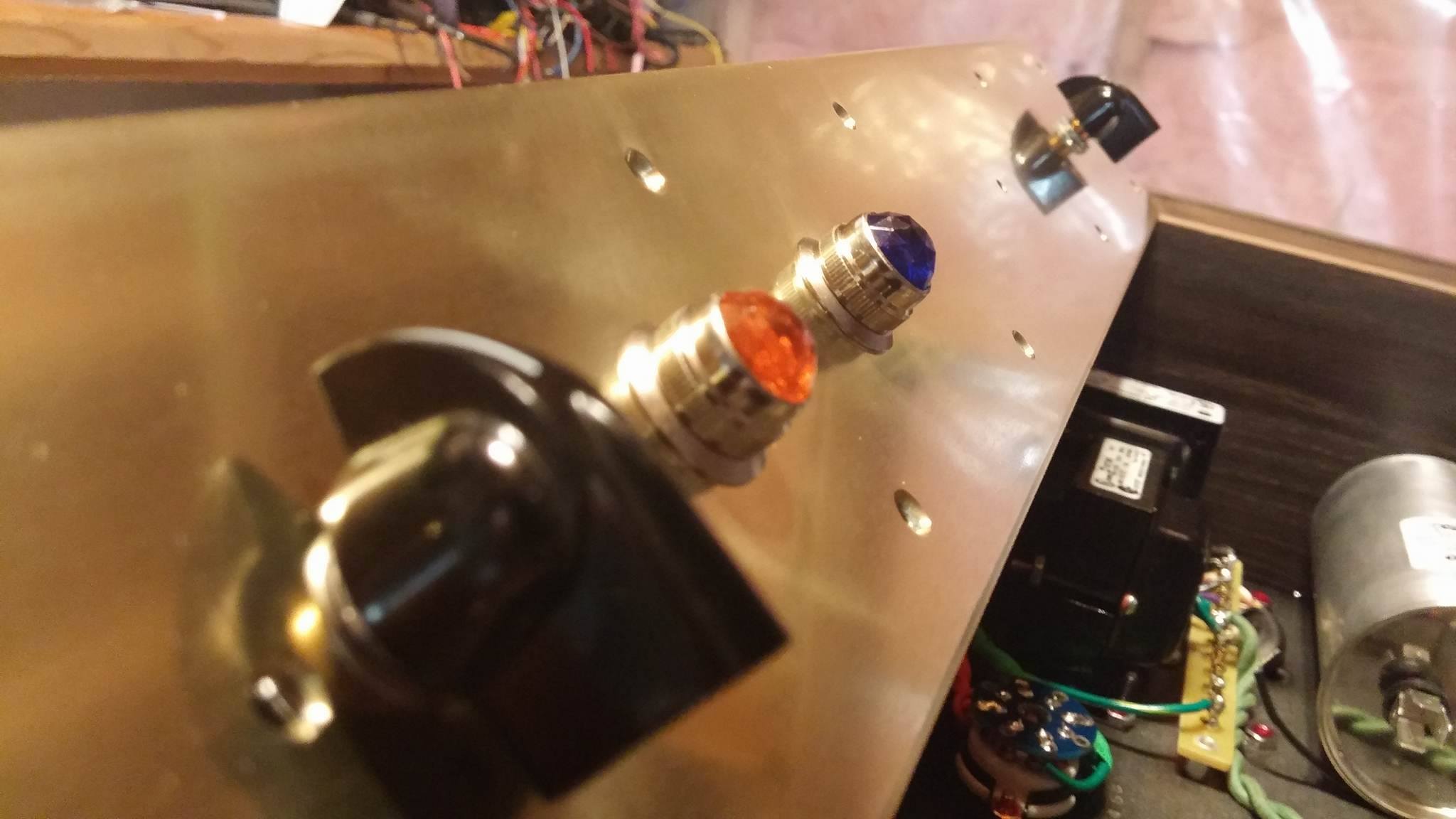

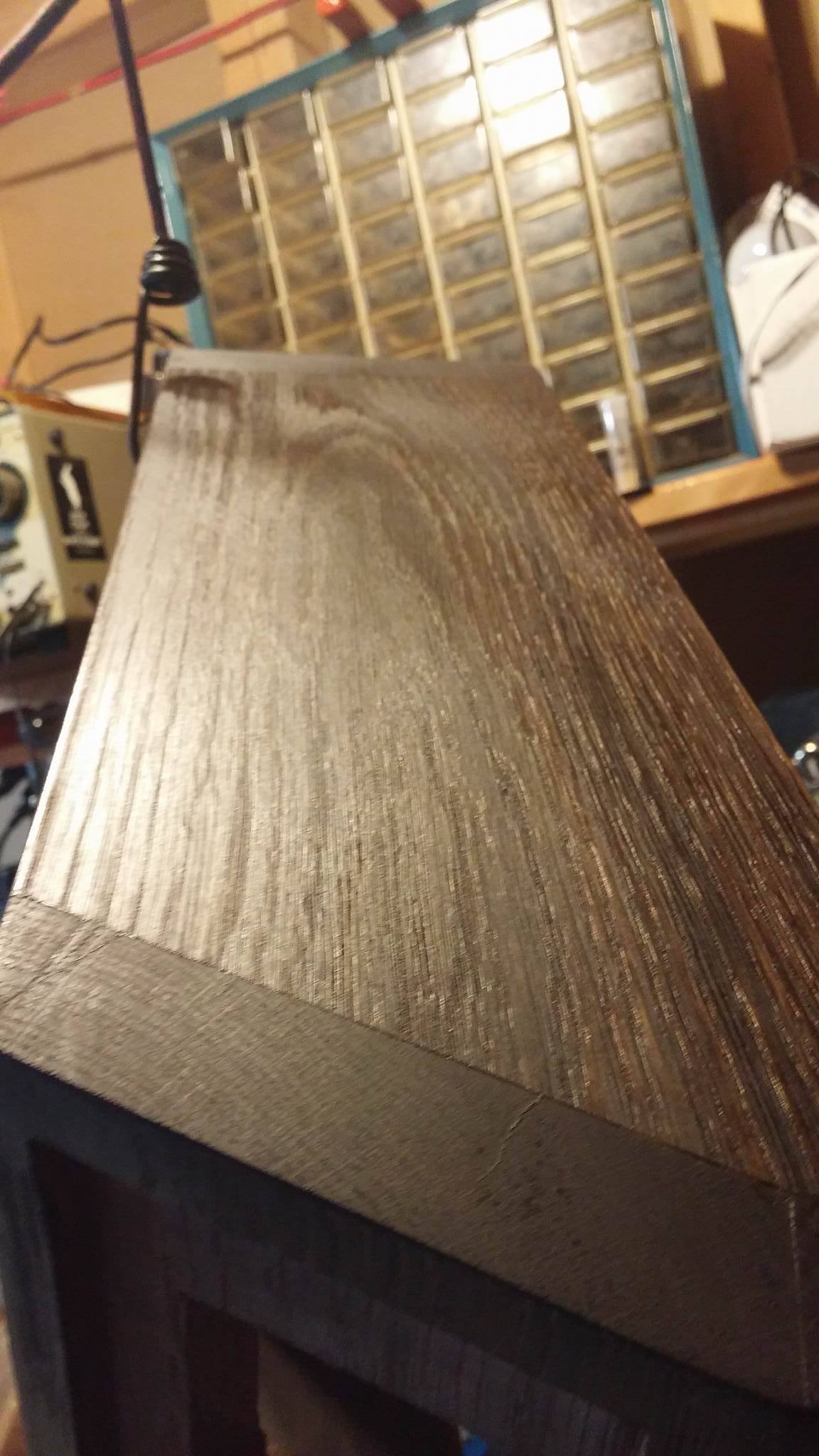

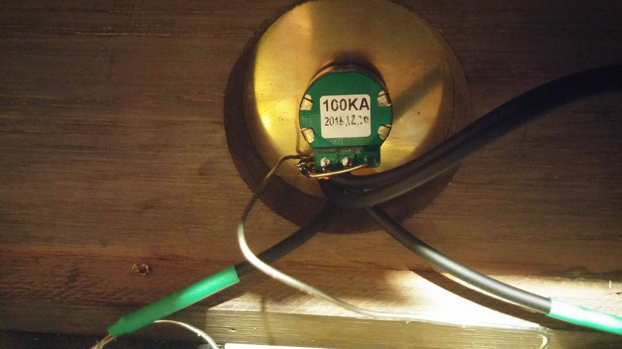

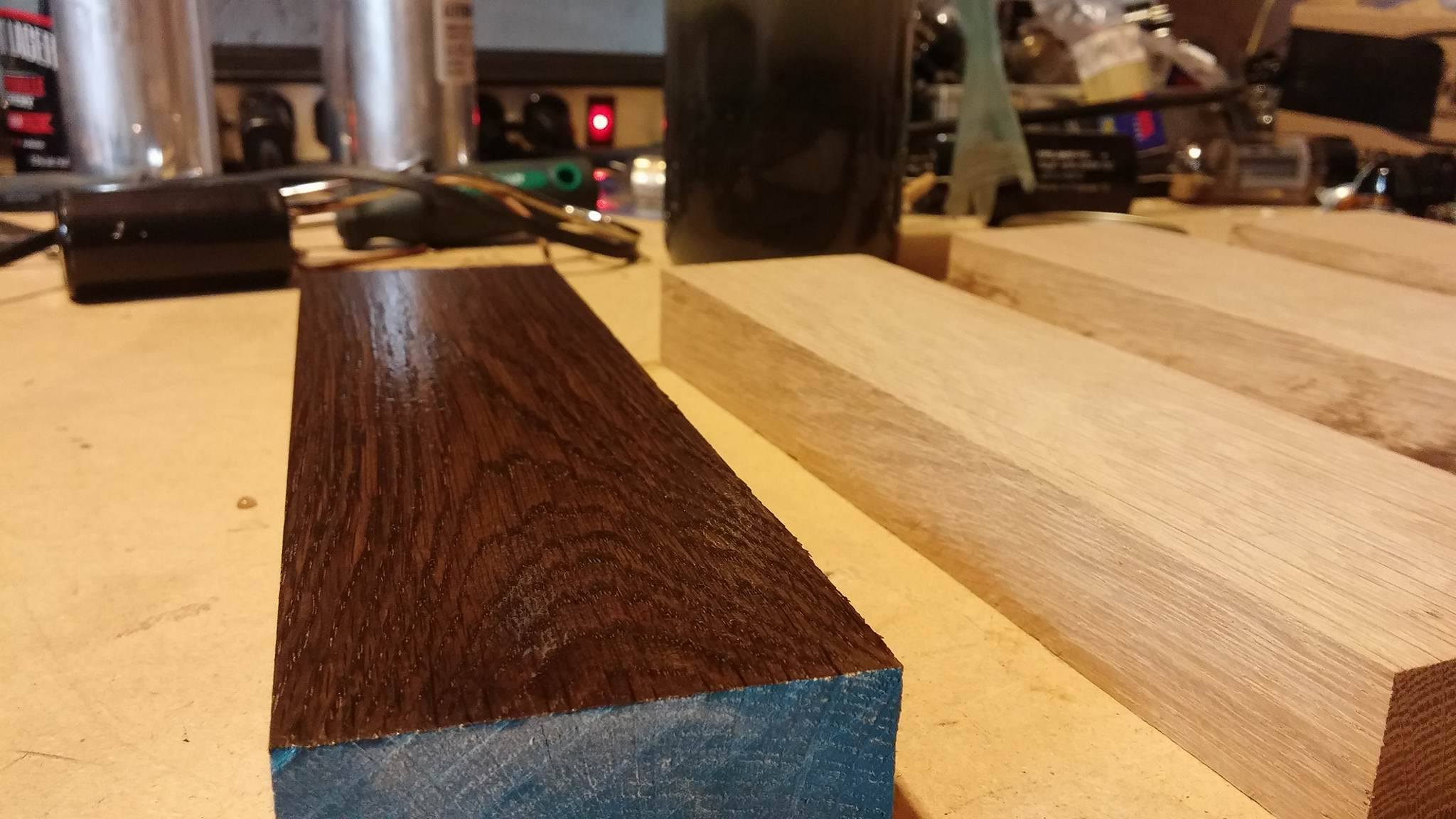

Chassis is White Oak finished with Iron Acetate (google it, pretty cool) and Tung Oil. Top plate it 1/4" 6061 Aluminum, and the Face Plate is 3/16" Cartridge Brass. Fender indicator lights and Glassware Audio power and input select switches.
I'm going to post a crap load of pictures below. I'll also post all of my power calculations for the different tubes running in different modes. There are two switched on the top plate; One for U/L and Triode, the other switches out the cathode bypass capacitor on the power tubes (560 and 360 Ohm - Low/High power). Once the values and schematic are posted, I would appreciate opinions on how to improve the performance of this amplifier.
Thanks for everyone's help so far. This project is operational, but now the fun part begins... Listening and tweaking.
Oh, and it's heavy. Really. Heavy.

Amp Continues..

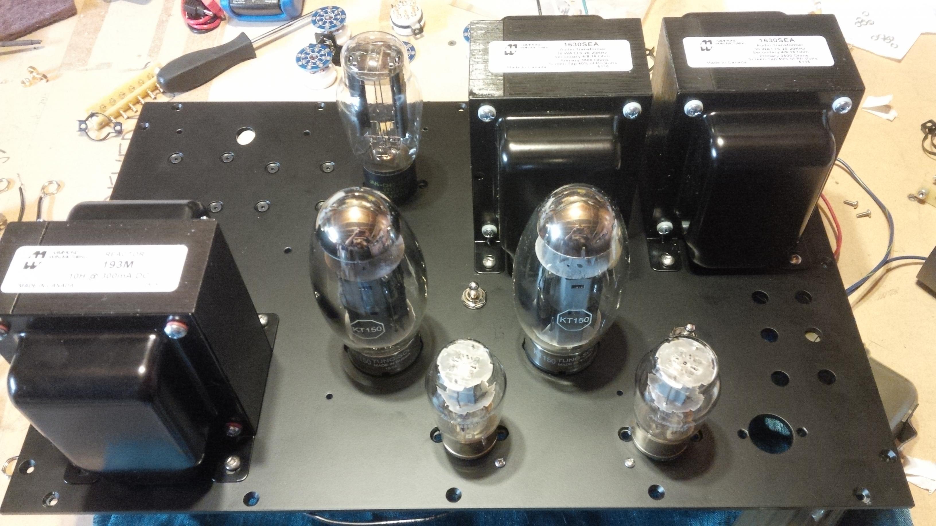

I cut the top plate to accommodate a 6N1P tube that I didn't end up using because I changed the design, it's just there to fill a hole. Need to find something clever to do with one 6N1P.
Schematic will be forthcoming, I need to make a few alterations. The amplifier operates, but I'll have to adjust the operating points.

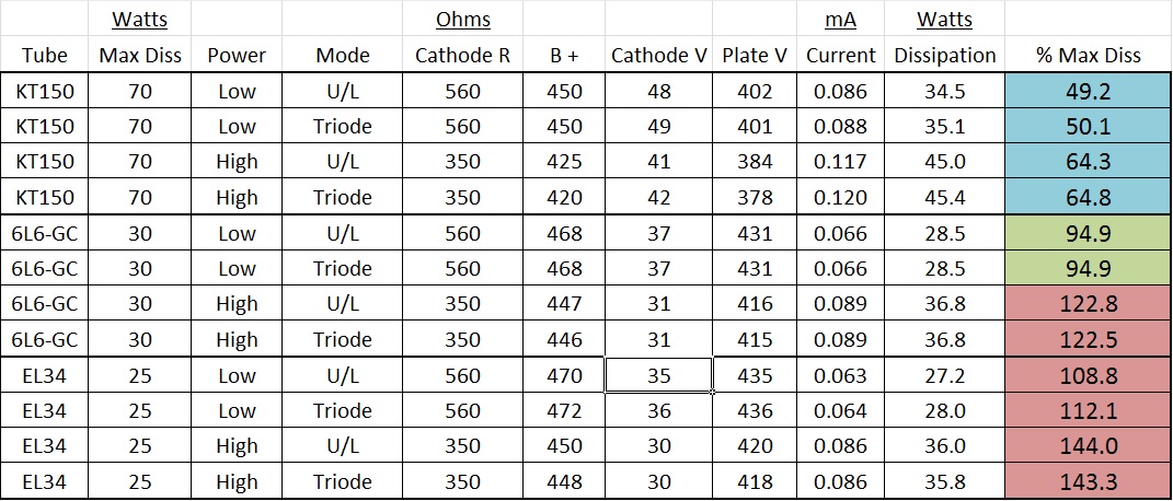

Here are the voltages and such that I'm getting from this amplifier at the moment with KT150's, 6L6GC's, and EL34's
The EL34's are being operated outside their ratings, especially in the "High Power" mode, they red plate a little bit, but WOW do they sound good! I've got all kinds of EL34's and 6L6's from back when I was a gigging musician, so I'm not too worried about toasting a few during testing.
The "High Power" mode is for the KT150's, I don't think I'll end up subjecting the poor EL34's and 6L6's to this mode, despite the fantastic sound they put out.
The "Low/High Power" switch is for a 560 and 350ohm cathode resistor on the power tubes.
