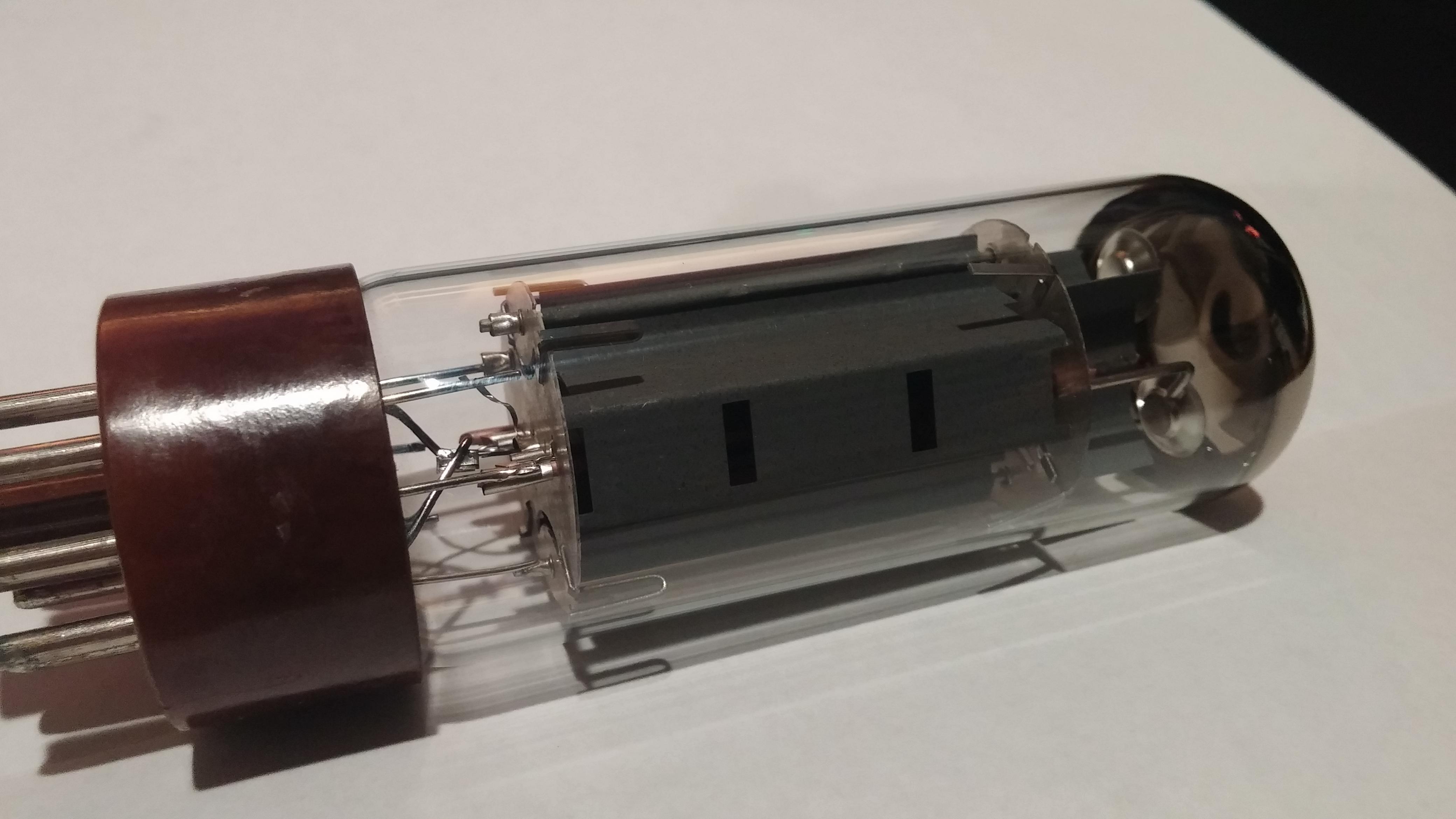

So far I haven't incinerated any power tubes, I have no idea who manufactured the EL34's I have.. I'll post a pic.
