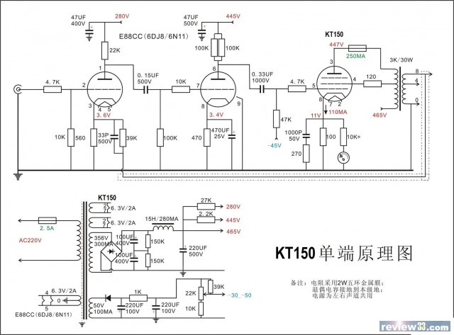

Edit. Added a schematic I found that might help you.
With big tubes as expensive and rare as these, some form of delay circuit in the high voltage side will be very worthwhile.
I have a pair of KT150, but haven't put them to use yet.
Like schematic. How many milliamps will a KT150 pull through the output? Any output xmers recommended?
If you look closely at the schematic, there is 110mA current being passed by the KT150, and the output transformer is a 3kohm 30watt unit.

Cool. It looks like the drive requirements are pretty modest for a KT150 though. An additional linestage probably isn't going to be necessary at all. You'll just end up throwing gain away in the volume control.

I haven't seen any curves for a KT150 in Ultralinear, but looking at the KT88 curves, I'd guesstimate you'll want to bias around ~40-45V. That should be manageable for a 6N1P with a 2V input. KT150 (pentode mode) has an input capacitance of 20pF according to the data sheet and this will be a little higher in Ultralinear, but not enough to roll off HF.
That said, there are much more knowledgeable people on the forum and you should get a second opinion, too!

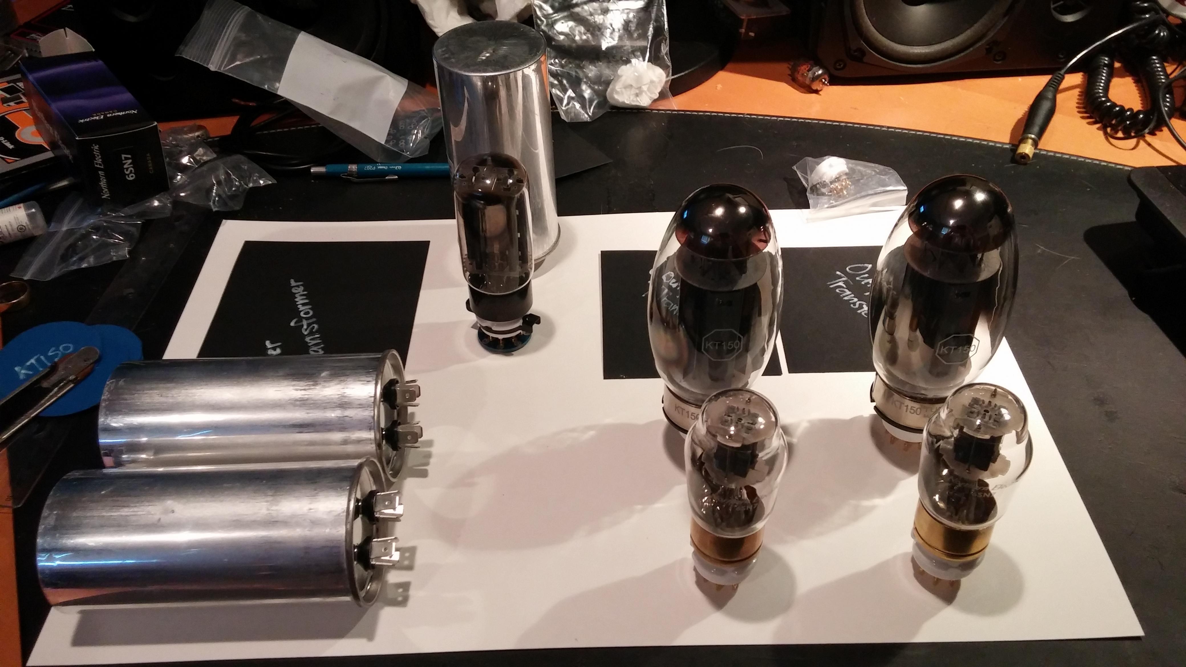

Update
I'd like to drive the KT150's with 6SN7's. I've come up with the following layout for the components.
First image is assuming only SS rectification.
Second is assuming valve rectification, or perhaps being able to select between valve/SS rectification.
There will be a choke positioned at the front left corner, in front of the PTX. The two motor run caps in front would be mounted under the chassis with a turret board holding all the PS bits and bobs.
I'm still working out a circuit. There's another thread on here that discusses using one 6SN7 to replace the 6N1P. I figure with two, using both sides of the 6SN7 following one another, I could get the level of gain I would need to push the KT150's.
Opinions? Critique? Am I anywhere near a workable idea?
Discuss..
Discuss..
