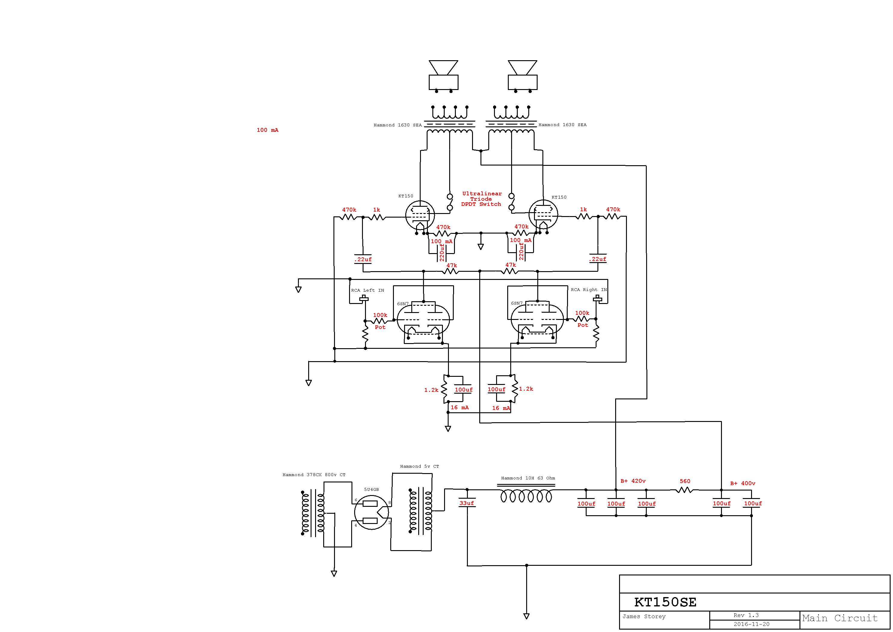

Just looked at your schematics.
The amp shows 400V on the 6sn7's but the power supply shows 250V.

There have been changes to the circuit I intend on using. It has been simplified, and I will most likely be attempting to drive the KT150's with the 6SN7's running as parallel triodes. The 6N1P may not be used.. although I already have it mounted on the chassis. In which case I will need to find something interesting to do with a single 6N1P.
Based on my testing, I believe the B+ will be much higher that 400v. More like 450v-500v, I'll have to see how everything settles once the circuit is complete, and energized. I would still like to run KT88's/6550's but I may need to have some sort of switchable B+/cathode bypass resistor in order to bring the voltage and current down to a level where they will operate without going into atom splitting mode. I'll try and post updated schematics this weekend. I admittedly don't know a whole lot about the ins and outs of constructing a valve amplifier, which is why I really appreciate and assistance you fine people can provide.

I've put a circuit together, but I'm not sure if the values I've used for the resistors and caps are correct (I think the power supply is good). Parallel 6SN7's going to KT150's in SE Class A.
I'm really hoping for some opinions before I start soldering. I may have missed something, and the more eyes the better.

I assume the 470K cathode resistor on the KT88's (KT120's) should read 470 ohm's?
yes I saw that too.
