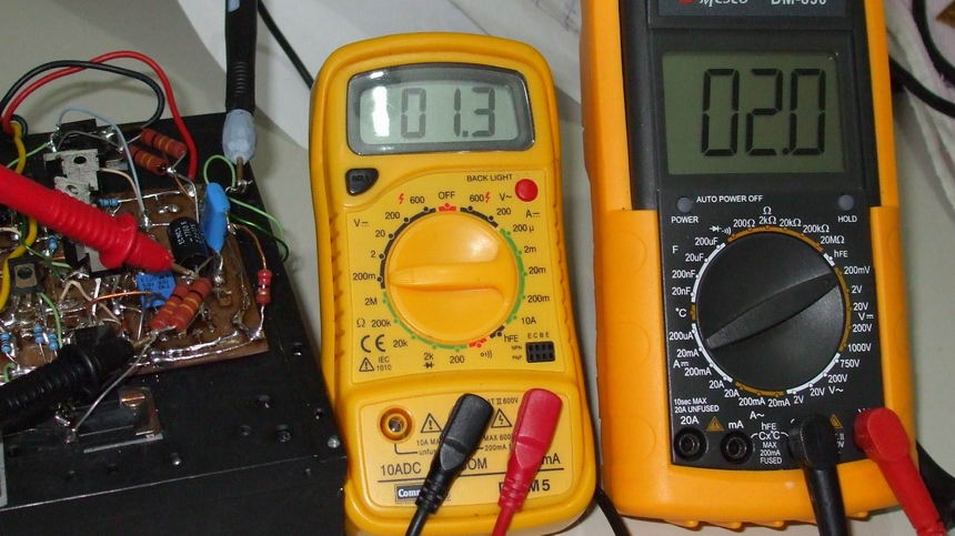

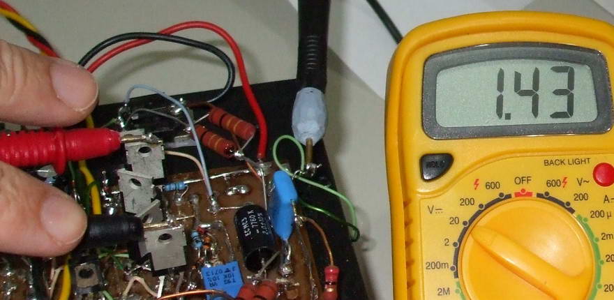

Not now because i am busy..but later i will solder multimeter proble points into
those transistor colectors...and the voltimeter will be reading the voltage...so... this will remove doubts if i have measure correctly or not.
I could not find more than 1.5 volts into my simulator... reason why i do not turst on it... this happens... and not a rarity to produce fake readings.

Yes Greg... i have fixed errors into the simulator and i have re-adjusted ...
And i am sorry... really the voltage is around 1.5 volts.... was misadjusted last time.
Now i have the amplifier better in adjustment...continue to sound very good.

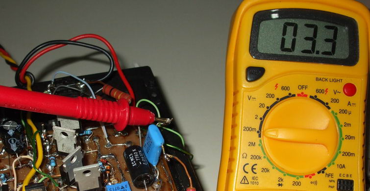

Here you have the current over the output emitter resistance,
So, it is the output stage current.... transistor just conducting...class A operation with very small iddle consumption.
Also you have the off set.... depending the adjustment you can have something from -5 milivolts to +5 milivolts.
My power on sub sonic non audible "thump" disappeared with better off set adjustment as Steve Dunlap said.

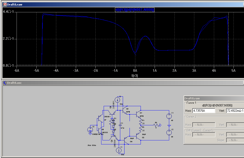

Transconductance of the whole output circuit plotted as a function of output current. It gets better the more *mismatched* parts you use because the deadband will be moved outside the working range of the amplifier. So with real parts it will be better but why do an output configuration that depends on mismatching to work correctly?

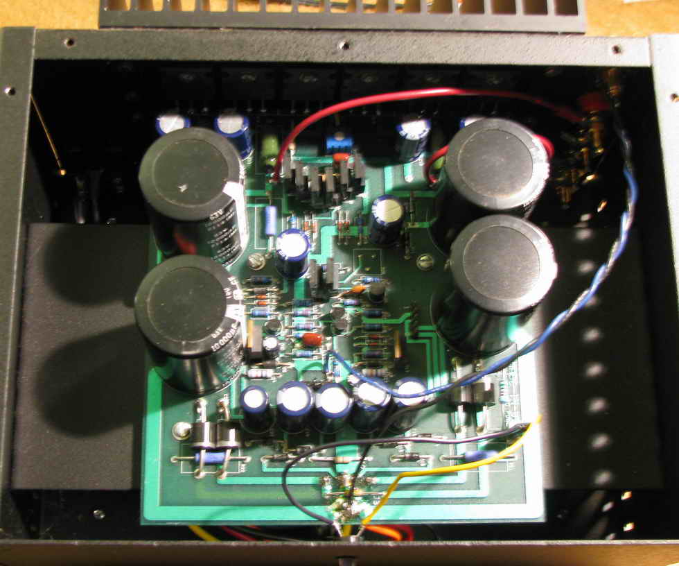

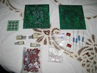

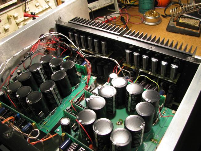

I drove over for a visit with Steve D. today and we put together a little Christmas package for Carlos -
The circuit boards in the photo are for Steve's old monoblock amps - but they are much less complex than the standard boards he used when he was manufacturing units for resale. Those boards - and the amplifiers - were very complex and not for the average DIY type of project. That's why Steve redrew the schematic for the DIY crowd. Some redraws have been done after the original to correct some things and juma did a very nice redraw that makes the circuit very clear.
I know that Steve is willing to help out all that he can with a PWB layout - and he has a number of parts (box's of nice xformers) that could be used in a GB if there is enough interest to get one going.

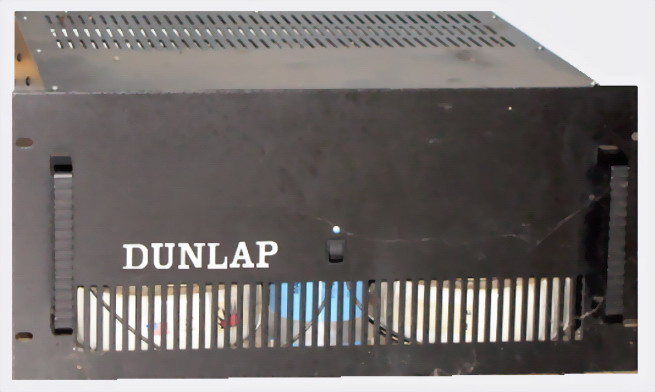

Photo of Steve's commercial unit - this one is like 7 or 8 years old. It might give you an idea why Steve doesn't think it would be a good candidate for a DIY project.
It weighs 90 lbs (45 kilo). This unit was dropped in shipping and it busted a couple of the circuit cards loose - but the case didn't get hurt a bit. Ya gotta respect a case like this one - if you don't it will hurt you!
