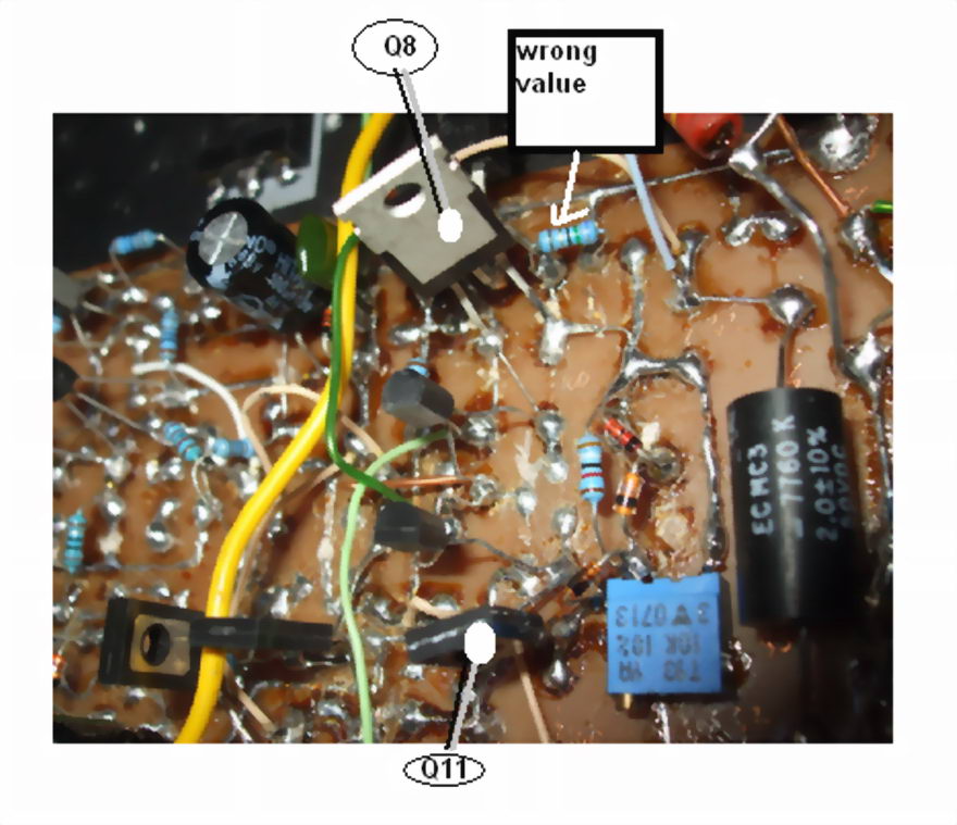

Mine has 2.34 Volts Mihai
I hope you are healing because that bone broken.
It operates class AB.... 0.55V each transistor.... well... at least mine is working this way.
I am not sure mine is perfect... i have a big mess of parts, wrong resistances, unmatched transistors and all kinds of mess.
Even this way it is sounding great.
Your amplifier sounds special too.
regards,
Carlos

Hi Carlos,
The bones are healing well. Thank you for asking.
In simulator I never get more than 500 - 600mV Vce over Q8 and Q11 transistors, which is strange. It is impossible to simulate this output stage.
Anyway, I trust Steve and you also and I will build for evaluation a version with three pairs of ThermalTrack power devices.
Mihai
