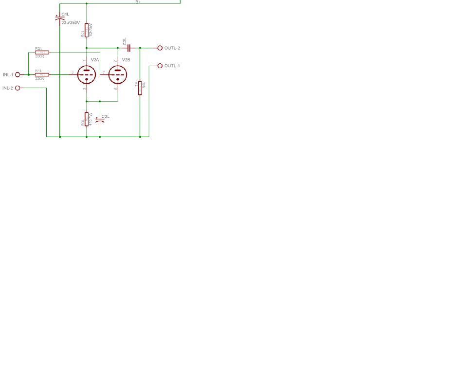

On a sidenote, is it not advisablke to raise the input impedance to say 47k from 22k (or whatever it is) on the krell KSA-50 clone?
What drastic effects may it have on the sound quality?
My worry is my pre's ability to drive the Krell (Homebrew AN M7 clone with LED Bias)
See attached - the Cathodes now has 3 Red LED's (either 7 or 9 volts bias) - I really like this pre I made...sorry for the crappy attachment - has a blue velvet 100k on front end and if I remember a 1M resistor on output.
8k to 10k sounds more like Zin not Zout of the attenuator.john65b said:I believe the Lightspeed is somewheres between 8k - 10k if I remember correctly...
Actually, I think its around 7k...from the Lightspeed Forum (I asked Georgehifi about this)...
A Lightspeed or even a passive 20K pot will be around 7k ish.
That could well be right.john65b said:Actually, I think its around 7k...from the Lightspeed Forum (I asked Georgehifi about this)...
7k would indicate that each opto was sitting @ around 28K when both are at the same value and outputting -6db to the next stage.
If 28k are the -6db values, then this is the worst case and for all other attenuation levels will, just like any other passive pot, drop to lower Zout
Will the next stage like a variable source impedance on it's input and no buffer between them?
