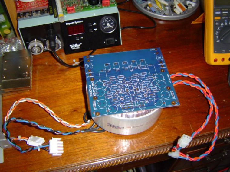

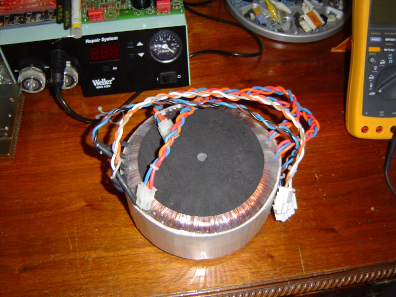

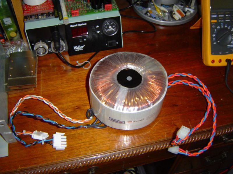

Hey guys, I found a GREAT deal on transformers for the KSA50 and KSA100 MKII projects.
There is a guy selling 1240va transformers with dual, center tapped, braided, 14AWG stranded secondaries at 30-0-30 each.
They are really nicely built with a potted center, flux band, and 18AWG braided, stranded primaries.
The really cool thing about these transformers is that they have dual 100v & 120v primaries for lots of different possibilities. If you use the 100v primaries with the typical 117v-120v input, you get 36.5-0-36.5 output.
I bought two of them to use with this project and after I received them I was so impressed with their build quality and versatility that I bought two more. I will post some pictures of them in a little bit.
The best part about them is the price. I talked to him about DIYAudio and he said he would sell them to anyone here that wanted them for $59 SHIPPED to your door!! In the US of course, but he seems like a nice guy and I'm sure will ship elsewhere also. He said he has ~50 of them left.
I am not associated with this guy and I don't know him other than I am a satisfied customer. This is just a heads up for anyone looking for nice transformers for these projects without breaking the bank.
His e-mail is dbslam@gmail.com. Tell him you are from DIYAudio.
1240VA Transformer Pictures
Here are a couple of pictures of the transformers;
Hopefully this will help some of you out that were looking for transformers for this project.
