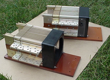

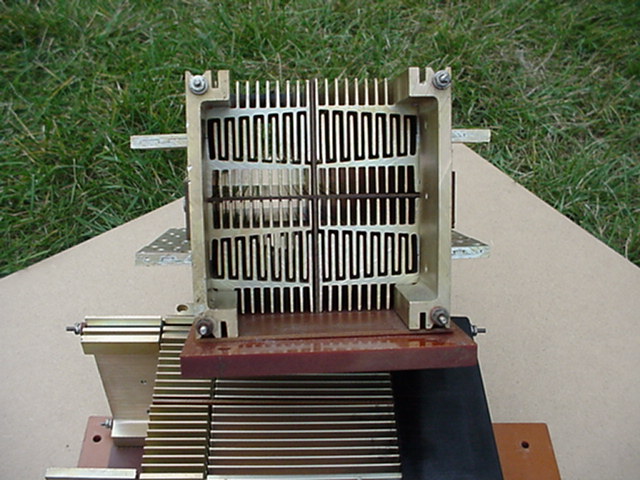

Jozua, I can't email you directly, but I have a pair of heatsink tunnels that might be of use to you. Shipping would be problematic, but the tunnels themselves would be inexpensive. They are modular and can be broken down and built up as you need. As they sit, each one is made up of 4 larger pieces (3 TO-3's each) and 4 smaller pieces (1 TO-3 each), plus shroud and end blocks. They might be OK, but I don't think they are a nice as the ones Jacco found.
Steve.

Thanks - Your heatsinks look perfect and if they still are available I am definitely interested.

if i had Spind's sinks i'd close the open sides with 90 degree folded alloy plates that slide into the slots.
(no Al, i'm not falling for the sloth trap a second time)
The fan mounted on the other side of the tunnel with help of a homebrew adapter plate would enable airflow across the entire heatsink cross-sections.
Those extension profiles are pretty cool.
Anyone interested in the ducts i linked to is welcome to pm.
