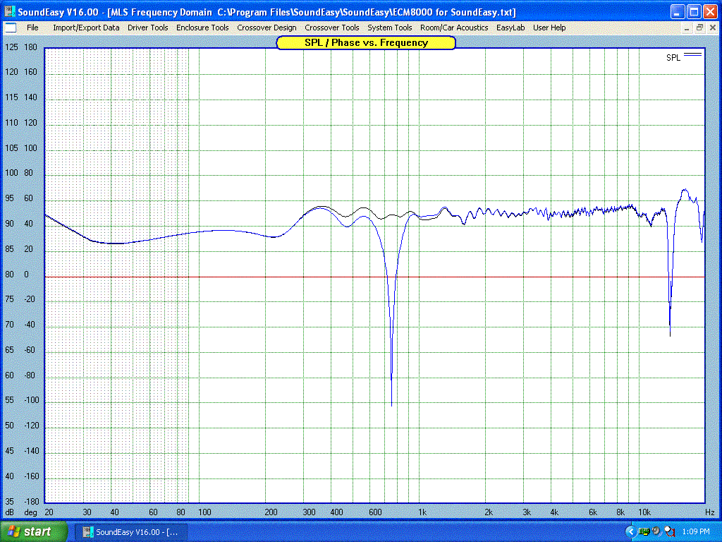

The Raptor has a crossover around 750 Hz (and "steep").. so at least with a design similar to that it should be more than acceptable:
