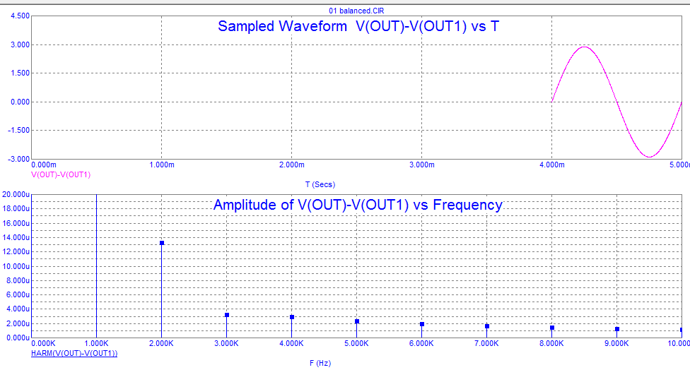

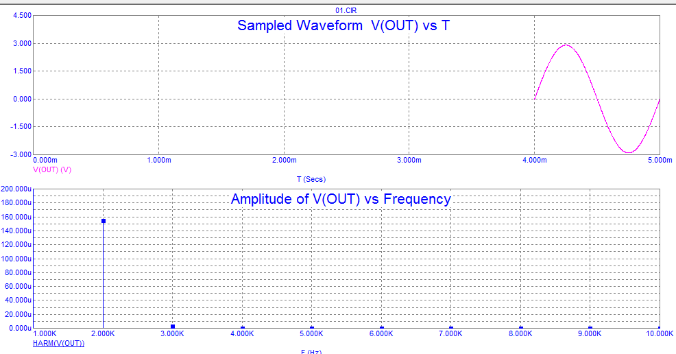

This is what I got in simulator PMA used! It`s my version of complementary jfet/bjt preamp circuit with NO global negative feedback. The circuit needs buffer because the output is (10K) resistor loaded like in a JC2 preamp, so results of simulation are without output buffer.:)
That would be 0.00016% second harmonic for a 3V peak output for a single ende in/out and a much less for a balanced outout!:)

John, I would like to ask a 'practical' question. Is there a big difference between my simulation results, for some 2.8Vpeak output amplitude, and your measurement on a real circuit? Also, is there a big difference between simulation and measurement in spectral content for SE and balanced input drive?
http://www.diyaudio.com/forums/showthread.php?p=1931538
I don't think so, Pavel. I got .02% harmonic distortion at 2.5V out, with 3rd dominant and 2n'd about 20db below third, at 4KHz. This, of course, is beyond clipping level of my JC-1 or similar power amps or about 800+ watts output/channel into my loudspeakers with the JC-1, so it should be a high enough level for consideration.

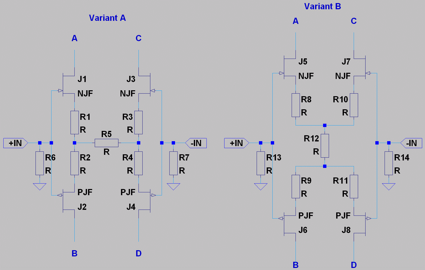

One question I'm wondering since some time....
Which of the shown variants of input differential would you prefer (I think you used both?)

To be fair, a differential pair of vacuum tubes, such as the 7788, with variable screen regulators and properly designed by a real engineer, can do amazing things in terms of distortion. If you what to know more about this configuration, please contact Bascom King, of Santa Barbara, CA USA, as he helped design this configuration. It is not as quiet as fets, but the dynamic range is at least, the same as the best 4 jfet configuration.
Even a single triode tube, operating open loop, can be very good, as shown by the Audible Illusions line stage, if you want to not use differential input.
The real advantage of the 4 quadrant configuration over other approaches is the self biasing aspect, so that the S curve can be extended, and linearized, especially at extreme current swings. The differential pairs are in parallel, so the noise floor can be 3dB lower.
The biggest weakness is that the p channel fets have more capacitance for the same amount of transconductance i.e. Gm, and this can get in the way of extremely high Z input operation.

I think this is an especially good point you make about the S-curve extension for the four-quadrant JFET design. It is a very nice feature. I am not aware of any BJT implementation of the complementary differential pair input stage that has this nice feature.
