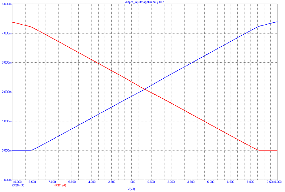

I am not aware of any BJT implementation of the complementary differential pair input stage that has this nice feature.
Bob,
I am. But on expense of noise.

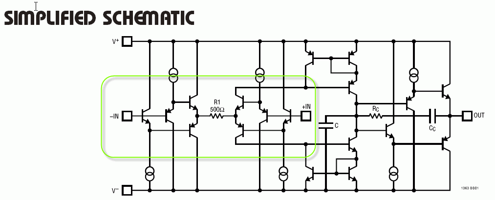

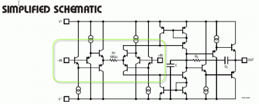

The closest I am aware of is the multi-tanh principle:
J. C. Schmook, “An input stage transconductance reduction technique for high-slew-rate operational amplifiers,” IEEE J. Solid-State Circuits, vol. SC-10, pp. 407-411, Dec. 1975.
Gilbert, B., "The multi-tanh principle: a tutorial overview," Solid-State Circuits, IEEE Journal of , vol.33, no.1, pp.2-17, Jan 1998
Thanks Bob, for your input. Yes, the LT1362. in many ways, is the bipolar equivalent of the CTC Blowtorch topology. It sounds good too. Bob Crump, my deceased business partner, modified a number of designs using conventional IC's with the LT1362, or another member of the same family. It is considered by 'us' the hi fi gurus, as being one of the best parts in the business.
