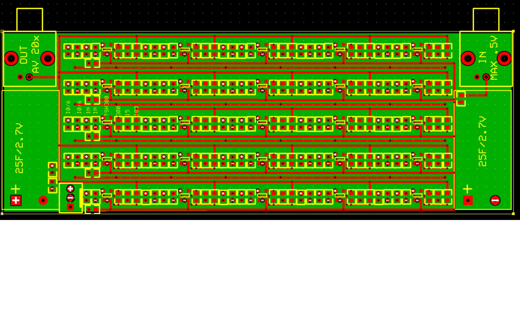

My goodness - a lot of JFET's in there.
Did you consider going parallel single ended:-
-potentially less noise - BF862 is the lowest noise JFET available at <1nV/rt Hz with very low 1/f corner. Parallel 8 of 'em and you are in <0.3nV/rt Hz territory. They cost pennies at Mouser
-second harmonic dominates the distortion spectra - not odds - pleasing sonic signature
- certainly easier to source parts
- marry to a good quality 'Scottie' (aka AD797) and all active feedback RIAA EQ for >35dB OLM
- = best of all worlds
See Syn08's website for inspiration and Dennis Colin's LP797 for a good primer.
