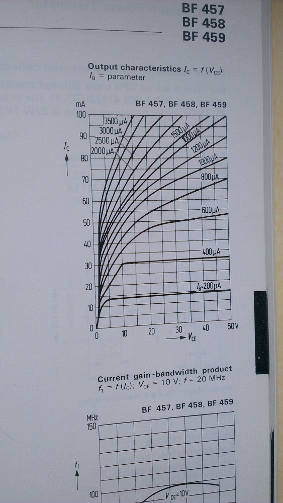

I have even better: the unabridged paper datasheet from the epoch they were released (thank hoarders like me!).
It is true that the characteristics are seriously sloped, considering that they are HV transistors, but at that time, simply making complementary video transistors was a feat in itself, and honestly on a video picture nobody notices moderately severe amplitude distortions.
Of course, the datasheet makes no mention of Vaf or any other spice parameters, but it can be guesstimated from the graphs: I reckon it is a little over 50V worst-case for Ib=5mA.
These are typical curves, and maybe in the spice model they went for the worst-case?
That said, they probably refined the process in the subsequent years, but they kept the initial model based on the historic type; they probably didn't care too much about spice, because they have their own in-house modelling: Mextram
This is Siemens from 1975/76 probably predecessor of BF469. Vaf does not looks so bad at collector current below 30mA.

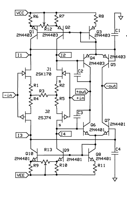

A couple of years ago I demonstrated (both built and simulated) that the complementary JFET input with trims on the current ratios of both pairs obviates any need for matching. Not that anyone cared.

I did buy a pile of the little metal clips to hold pairs in thermal equilibrium. You can choose any two degrees of freedom to trim. If offset and drift are trimmed (possibly a little tedious in practice) servos are not necessary except possibly for huge DC gains.
On another point, if you look at the ideal JFET equations you will see that the cancellation of the quadratic term requires both Vp AND Idss to be the same. This would require exact complimentary pairs not just Idss selection.

Scott, can you pls show trims on the current ratios?A couple of years ago I demonstrated (both built and simulated) that the complementary JFET input with trims on the current ratios of both pairs obviates any need for matching. Not that anyone cared.
I built some of these (there is more to make up an entire amplifier) to demonstrate simultaneous trimming of Vos and Aol (Aol could be + - or infinite) to debunk the wide open-loop BW folklore. Vos and drift could also be simultaneously nulled.

I find Scott's solution very interesting. I'm not sure how to adjust the pots in practice because I can see what appears to be a continuum of working settings.
Well, you're probably still aiming for the lowest possible deviance in sides to get the matching. So the smallest tweaking away from the center of the adjustment range. Not having boots on the ground on this design, it'd be hard for me to put together an iterative solver in excel to figure it out, but *hopefully* it'd be pretty quick in practice. Safe to assume that once the whole system is warm, the small permutations in bias per side aren't going to cause too much long-term effects.
Yes it is a search algorithm, as I said, it can be tedious when one parameter is something like temperature drift. In general you can reduce it to a problem with two equations and two unknowns, I posted pictures years ago of trimming the amplifier to zero offset and "infinite DC gain". It is possible to take two measurements and calculate the solution by computing the derivatives and using Newton's method. Genuine NOS JFET's have become very expensive not having to buy extra to get matching saves one money and there are plenty of folks here that are on a budget.

^ I'm surprised you can't linearize it based on small perturbation. Depends on how far apart the jfets are, though.
That is Newton's method, linear combination of the first derivative of two variables only. Of course it is not good if the FET's are way far apart, but that is easy to avoid.

Scott, I've been working on a FET phono stage which could be amenable to that approach (it costs all of two trimpots, such complexity!). Is there an advantage to having the trimmer be between the two current-setting resistors as opposed to having on fixed and one variable current setting resistor?
