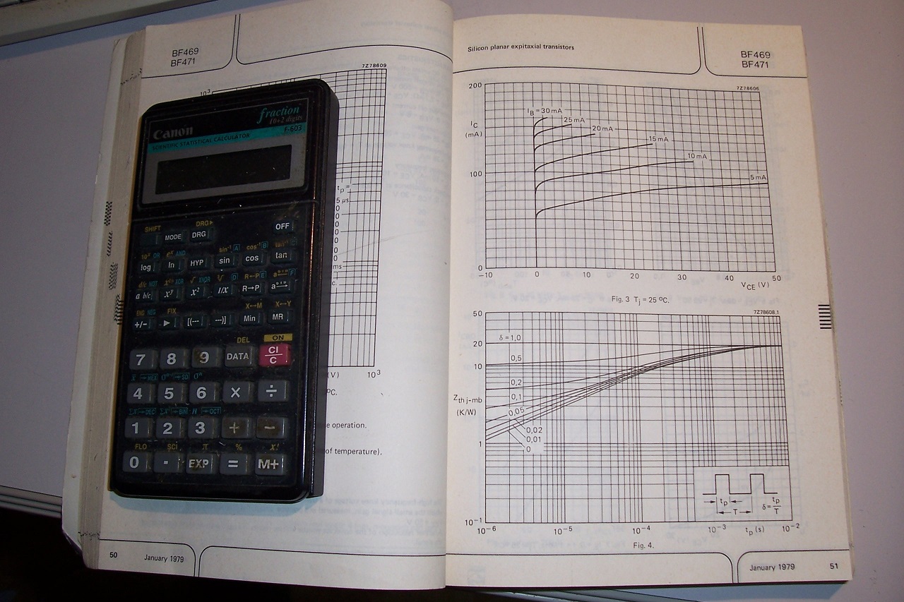

Someone with transistor tracer could do that.
I have even better: the unabridged paper datasheet from the epoch they were released (thank hoarders like me!).
It is true that the characteristics are seriously sloped, considering that they are HV transistors, but at that time, simply making complementary video transistors was a feat in itself, and honestly on a video picture nobody notices moderately severe amplitude distortions.
Of course, the datasheet makes no mention of Vaf or any other spice parameters, but it can be guesstimated from the graphs: I reckon it is a little over 50V worst-case for Ib=5mA.
These are typical curves, and maybe in the spice model they went for the worst-case?
That said, they probably refined the process in the subsequent years, but they kept the initial model based on the historic type; they probably didn't care too much about spice, because they have their own in-house modelling: Mextram

It's a shame they don't show lower base current curves. For some Sanyo parts at 1mA the output conductance is much lower, compared to 5mA and up. See the datasheet for the 160V Vceo 2SA1507 and 2SC3902 for example. In fact the slope is not monotonic, but that may have been a drafting error.
In any event, for high Z at a collector, control electrode recycling is your friend, if you can manage the stability issues.

I can see on the lowest curve it starts to level out but not by much. And think about it, it takes >30V already to get out of quasi-saturation, so your last 30V of headroom will still suffer.
Base current recirculation does work, but it can be a lot of work. You will need several more components, and you will also have to set it up so it won't impact PSRR. And the stability problems - I wonder how many people actually fully understand that issue.

I spy 10V over 10mA which means collector impedance is 1k or a bit more at higher voltage. Not very good at all. I would want something more like 100k.
What did I tell you Bonsai? ;)
Nothing at all. I am not questioning the device performsnce - merely the fact that you picked a very old part and expect characterizations that were never published.
As noted, for TV/monitor applications, VAF is of little consequence and at the time these were released, Philips would have been the largest supplier of semi's for that market.
