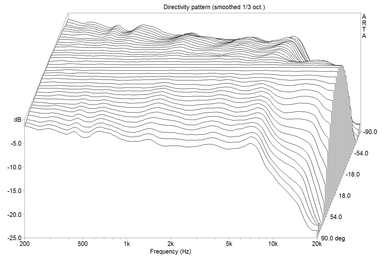

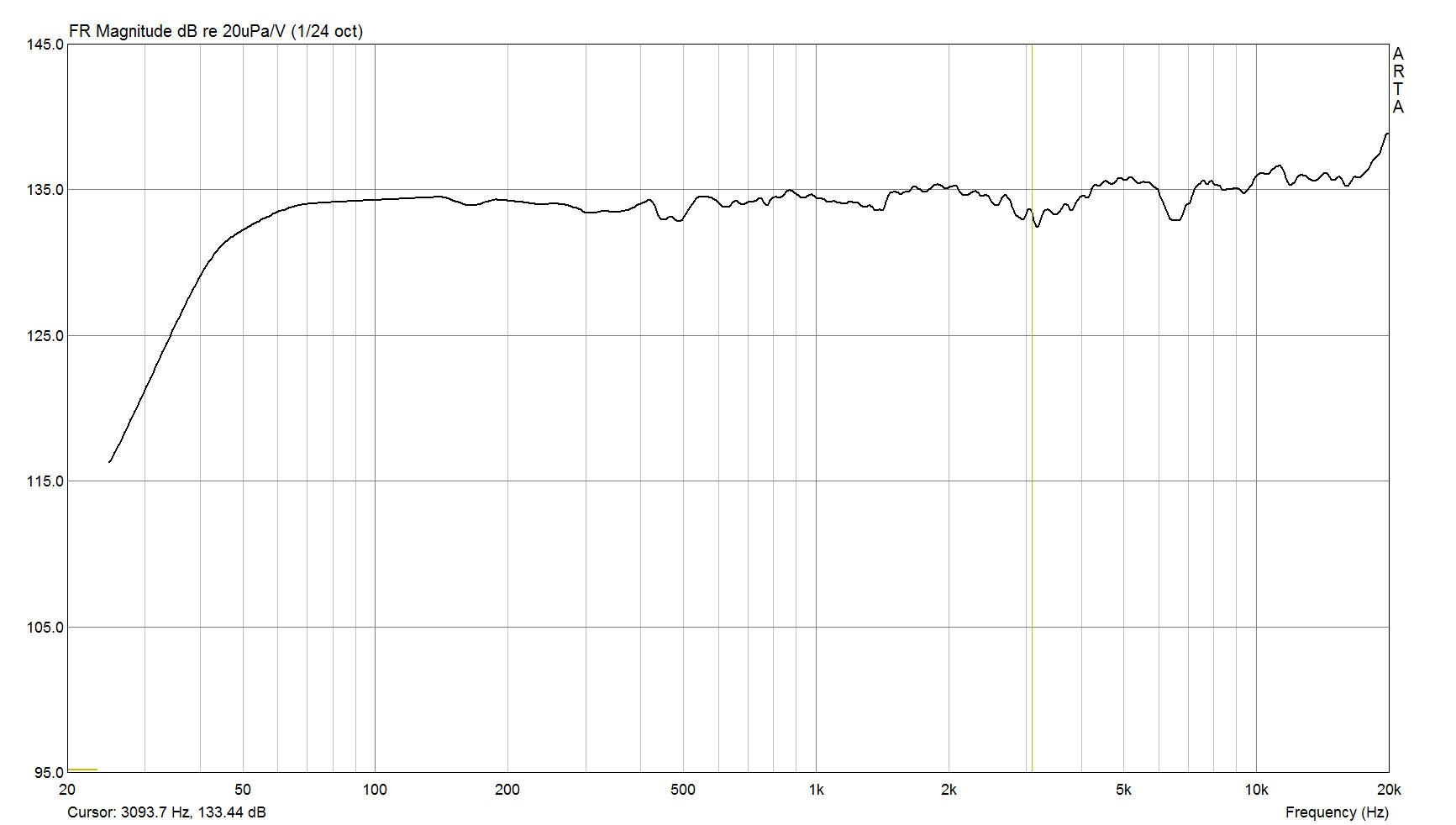

Why not something like this:
Not quite as flat as the JBL, but not far off, and not bad for using off the shelf drivers. The directivity pattern is unmatched by anything other than MBL's, I gues; it is almost like a 5/8 inch point source in the front half.
Tom Danley recently remarked about the virtues of having a point source, and I can't agree more. For stereo imaging and loudspeakers magically disappearing, this is what you want. Unfortunately, a 5/8" tweeter is already pushing the limits a bit, and what you see from the directivity pattern is mother nature at work with a 5/8" diaphram. In spite of this off axis roll off at > 10KHz, there is virtually no way of telling which way the speaker is pointing towards you.
I have almost sorted out the IP on this speaker, which I hope to start auditioning this fall in the US. Jan Didden is partnering up for this part of the trajectory. So, hopefully soon in this theatre ...
