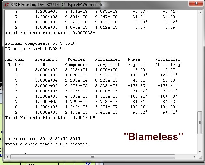

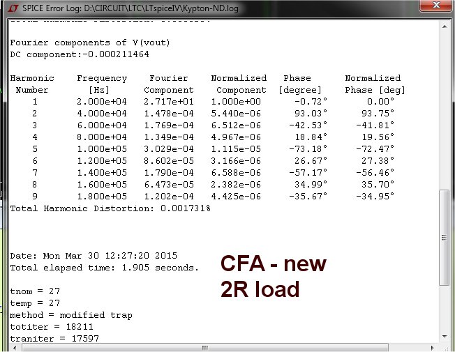

I don't see that "current feedback" amplifiers promise anything for audio use
That is quite the statement. Someone should send the man a good 200W
CFA - let him listen for a day !
Then he goes on to say that a VFA's oscillation is "tamer" than a CFA's.
Oscillated both - quite the opposite.
Asymmetrical slew on a CFA ? - also , quite the opposite.
:D:) then lazy cat get's into it - oh boy ...
D. Self says a CFA is not "blameless" grade ... both my CFA's
are @10ppm @ >90db psrr (below 2).
I like both type amps , personally - but a CFA can easily match
(most) VFA attributes. But , instruments are better "placed"
with a CFA.
Performance wise - I get the same with either VFA/CFA (below 1/2). I
can't imagine why a CFA would get a "not valid for audio" (assertion).
PS -
Cambridge audio looks like a bunch of overpriced junk !
Cheap PS's and "wimpy" output stages ..... :eek:
I WANT my Parasound's ...:D
OS
