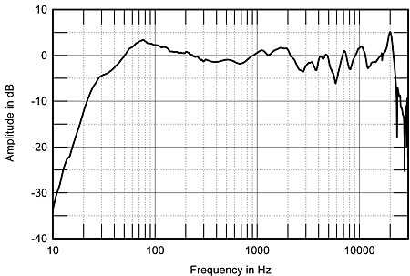

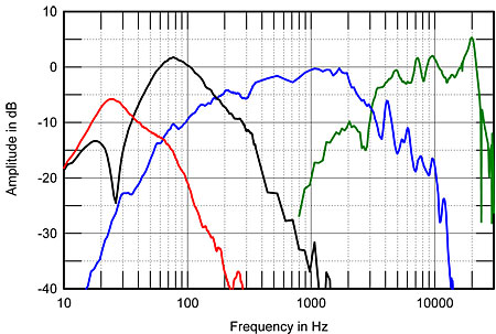

I believe in extended bandwidth, without a sharp cut-off. I hate CD filtering, and when I can, go for SACD or DVD whenever possible.
At first, the Sasha speakers that were measured to have a 20KHz or so response, even a slight peak at 20KHz, were measured by 'Stereophile' to roll off after 20KHz very quickly. At first, these tweeters bothered me, and I almost put a cloth in front of the tweeter, as I had with my earlier speakers with a similar tweeter. However, the sound has now smoothed out and is OK, more or less. Still, I would like to add the 'super-tweeter, just to note any differences that I might appreciate. You never know! '-)
"I believe in extended bandwidth, without a sharp cut-off."
If one were to take Heyser's view that "time", not as in seconds but down to fractions of wavelengths were more important than generally assumed, then in addition to a change in amplitude, the sharper corner also "acts like" more of a change in time which might be audible AS WELL AS the change in amplitude.
Here are a couple of measurements from 'Stereophile' of the speaker I am now using, including the tweeter:
