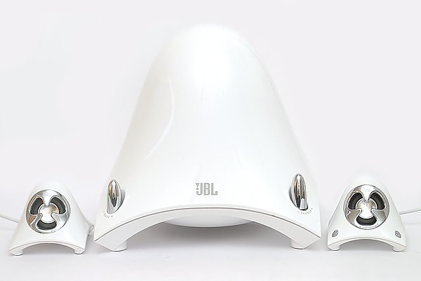

When Harman was getting its computer speaker business off the ground, despite being responsible just for electronics, I poked my nose into the cabinet bracing a bit and suggested a sort of Penrose tiling of the interior of the plastic boxes. As he didn't think of this himself my boss was customarily dismissive of the idea. The shame was we had a full-time FEA guy on the staff who could have modeled it and determined the characteristic resonances.
A much later loudspeaker pair, initially having some industrial design spin connected with putative ETs and named accordingly (Roswell was one, Area 51 another, Creature a third), but later renamed the neutral "Duet", had, for a change, a felicitous shape for both cabinet rigidity and decent off-axis behavior. I listen to them at desktop still quite happily, and wish that they had an EQ-changing subwoofer line level output---a feature that studies showed had an almost zero attachement rate, so it was elminated :(

I see it is in a substantially restyled version now. One of the sad things about them is the "grill" messes with the response. When the tech measured them the satellites looked beautiful. Unfortunately he probably mixed up files, and what I had to work with for EQ later was far less promising. I tried to get the three-pronged thing to be made out of mostly a screen material, to no avail. However, everybody including the iLounge guy seemed to love them, and it would get plugged as a comparison when he'd review some roughly comparable three-piece system.
