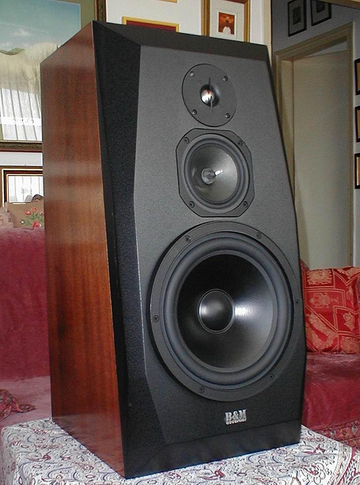

I personally have never seen any Masonite as thick as ostripper has mentioned unless someone glued together a bunch of sheets. Perhaps in another country that is available but I don't know where you would purchase 3/4" or 18mm thickness material.
I have a local source for MDF up to 1 1/2" and 5' X 12' sheets, I don't speaker projects but just curious is 1 1/2" thickness useful or just overkill?
I'm no expert, just limited experience regaular guy. In my experience, regarding the baffle, which has to deal with like 90% of the generated mechanical energy, I finally used glued together 3 MDF boards, each 22 mm (app.0.87 inches) thick. This was our third go, started out with one, then tried 2 and finally settled on 3. Key reason - the thicker it got, the cleaner my bass lines worked. And of course, the heavier the whole box, its actual weight now (with everything inside is 28.2 kilos or app. 62 lbs for a nominally "bookshelf" format speaker, i.e. needs dedicated stands to be on the floor).
The other reason is that such thickness allows you to sculpture the sides and decrease refraction as in, for example, Avalon speakers.

II finally used glued together 3 MDF boards, each 22 mm (app.0.87 inches) thick.
In my enclosure, i used 2 boards glued together. One MDF, one of less density. and a foil of lead covered by Blakson paint inside. it is a big mistake. It is very mat, but so heavy: i had troubles at each of my relocation.
It is way better, on my opinion, to put many cleats between walls inside the enclosure, to dump the walls. Or, and, to think at creating a vacuum between the walls that we can garnish with dry sand...
That is the way i should consider my next horns: two walls in resin filled with sand ? Massive wood is perfect, and good looking, but sooo expensive !
Scott,
I have built a bunch of cabinets with double layers of 1" mdf glued and screwed together for front baffles. As dvv says it does help damp the front panel and can be easily sculpted and when you consider all the cutouts of a multi-driver enclosure it does help to stiffen the front face. It does get real heavy fast though and as Eperado has just pointed out for most things I would use internal ribbing or complete panels with cutouts to attach all the walls together to stiffen the walls and even the face panel. Of course you end up cutting parts of those reinforcements out so the air can still move inside but if you look at some of the older ideas of honeycombed internal spaces that I think either B&W or B&O did years ago that would be the extreme. Plywood wood be stiffer by nature but the only plywood worth using is the imported Baltic Birch and then you still can stack layers to make it stiffer. As Christophe noted constrained layers with multiple density materials and even damping layers of some elastomer or fulled with sand has also worked for many who don't mind needing three people to move them. I have a friend who went as far as to use tension and compression rods in large PA enclosures to stiffen the enclosures. Some people won't work with mdf as the resin used to hold it all together is often a formaldehyde based resin and they think the dust is to toxic, I just wear a mask.
