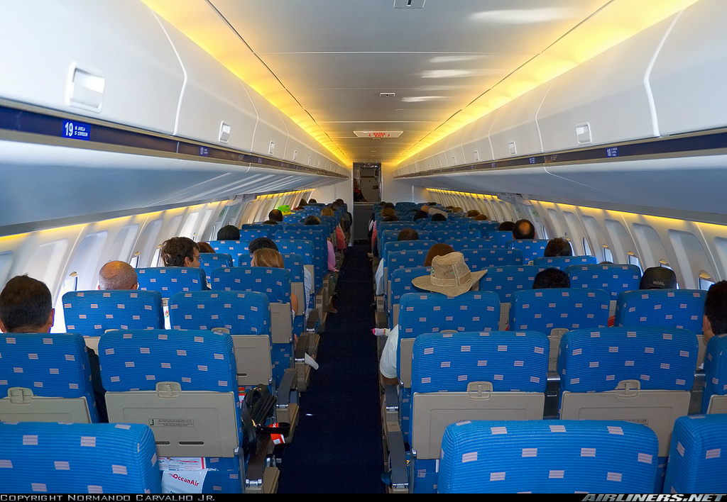

All I know is my racing dinghy (FD) is built in that technology and is stiff as hell..
Picture of overhead luggage lockers in a Fokker 100.
2-side kevlar laminated honeycomb (pre-preg vacuum autoclave), foam edges, sheeted with plastic foil.
A 1000 bucks for a single front panel, five grand for a complete locker unit.
Stiff as hell, ultra-light, unsuitable for loudspeaker cabinets.
And acoustically opaque ?Stiff as hell, ultra-light, unsuitable for loudspeaker cabinets.
