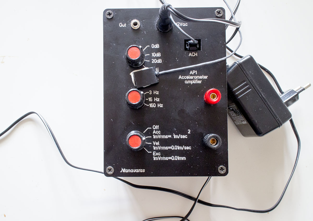

As to cheap vibration sensors, the other famous Greek audio George, George Ntanavaras, produced a kit for an accelerometer that works really nice. PM me if you are interested in his coordinates.
Oh, one of these days, someone will write a program to can use the accelerometers of mobile phones for this purpose ?As to cheap vibration sensors
