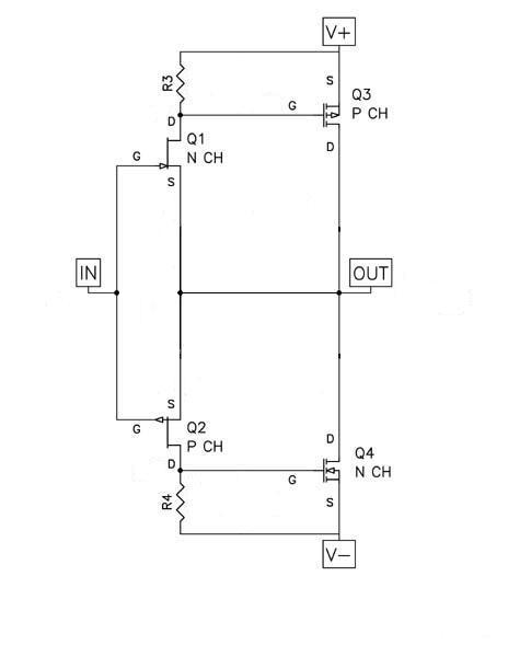

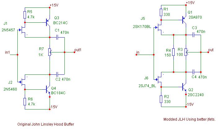

John,
What do you think of this as a power (unity gain) buffer ?
Q1,2 are 2SK170/2SJ74; Q3,4 2SK1530/2SJ201.
Drain resistors ca. 600R, source resistor for Q3,4 say 0R22.
Bias for Q3 ca. 2A. +/- 16V rails.
(I thought it must have been done before, but search and google did not return anything similar with FETs, only with bipolars).
Patrick

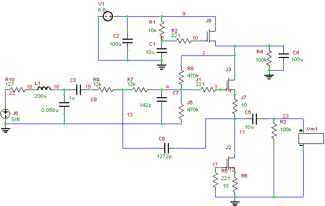

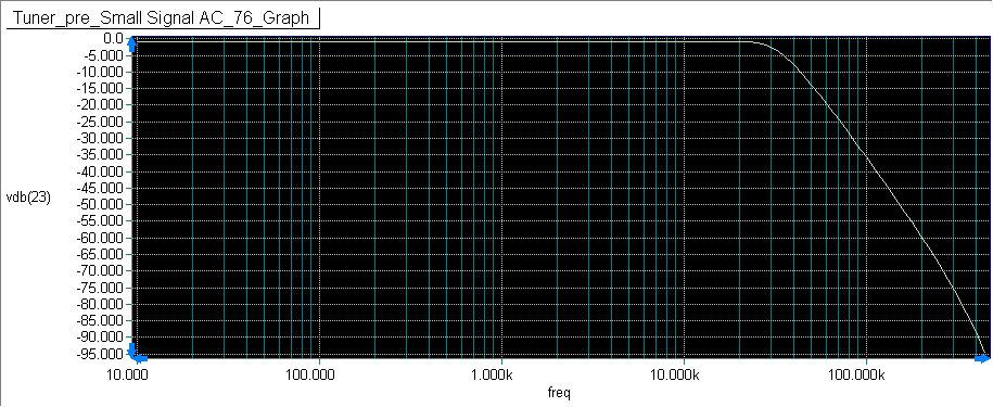

johnloudb, I like your ckt, but maybe 100uH would be better?
It takes about 200uH, and changing C8 to 0.58u and R10 to 127, to get a sharper response. Now down to -35dB at 100kHz.
I think increasing the Q of the S-K circuit (now 1.5), and some more experimenting with the R10, L1, and C8 could give a sharper slope and maybe reduce the value of L1. I'll see what I can come up with.
So far I've avoided S-plane math and deriving the transfer function and I hope to keep it that way.
john curl said:johnloudb, I like your ckt
Oh yeah, thanks! Nice to hear. The input I got here helped a lot ... I don't have the experience most people here do.
