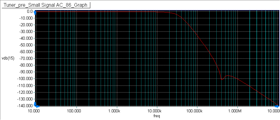

Here's the response in Spice.
attachment.php
Well, best I've got so far.

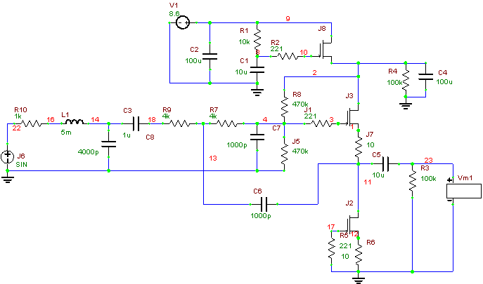

I agree, but what would you estimate the gain bandwidth of fet follower to be? That is why I am thinking of choosing it, instead of an IC.
John, are you asking me or Simon? The GBW of my buffer is 8Mhz using a BF862. When you say a FET follower did you mean a circuit with gain? I thought you meant JFET buffer. I don't know if a buffer will have enough gain in our system ... it will be close I think.
But, I can always adjust the gain of our preamp, which doesn't have much right now.
Here's the circuit I simmed:
attachment.php
