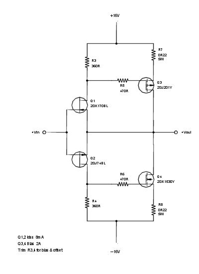

I think that johnloudb's approach is the best path (IN THIS CASE) for a number of reasons: First, cost. We are modifying a $75 tuner for goodness sake. Transformers, good ones, cost real money and can be physically rather large. Of course, they could be mounted OUTSIDE the case. Then hum pickup is almost inevitable, without serious shielding. Inside, what would the RFI internal environment do to an unshielded transformer.
Second, we only have 8.5V and 7ma or so for both channels. Most IC's would starve the output stage to speed up and quiet the input stages.
Third, the jfet follower, properly done is almost perfect for a hi Z load of 10Kohms or so. 600 ohms, NO WAY, but 10Kohms, OK.
I not only use this topology for impedance conversion in the Parasound JC-1 power amp, but we first used it before the Blowtorch preamp was made into a product. The biggest problem was lack of voltage gain, not sound quality.
We don't really need the extra gain in a buffer stage for this Sony.
That should be enough reasons.

Joachim,
Schematics as promised.
Thx,
Patrick
PS
The graphic conversion blurred things.
The input JFETs are K170/J74, Idss 8mA. Drain resistors 360R.
The drivers are K1530/J201; source resistors 0R22, gate currently at 470R.
I should have added a load at the output perhaps, of say 100R or less.

So the signal goes out of the drain of the output transistors ? I whould add a trimmer between the sources of the input Fets of ca.50 Ohm. The middle pin whoud go to earth and you can conveniently adjust offset.
Offset will probably change with temperature. Servo is better.
