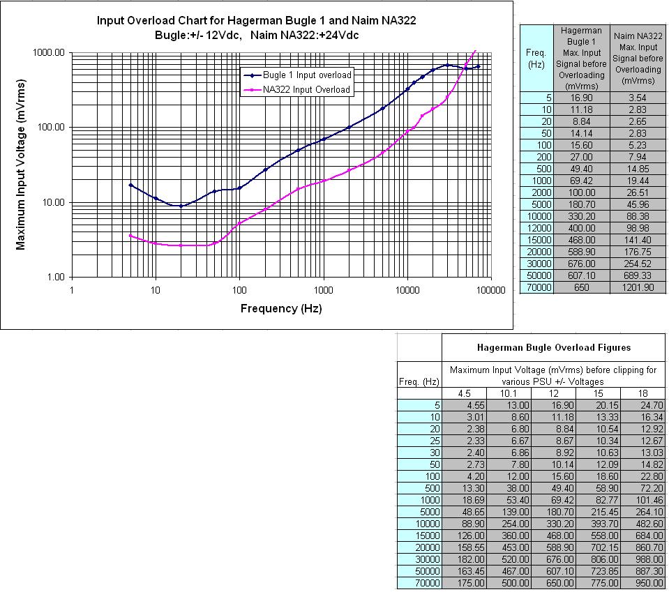

However, all else being equal, a higher voltage dual power supply is better than a lower voltage one. We usually start with +/- 30V from a remote location and step it down slightly with a final power supply buffer on each stage.
:cool::)
My line stage and passive RIAA, way back in time, used +/- 24vdc with local reg. Use as much voltage as you can.
Here is THD from a 'simple' 4 transistor circuit I am playing with and studying at different PS voltages. .18v in and 1 volt rms out into 100K load....1KHz --
+/- 12v = .14%
+/- 15vdc = .003%
+/- 18v = .0015%
+/- 24v = .00045%

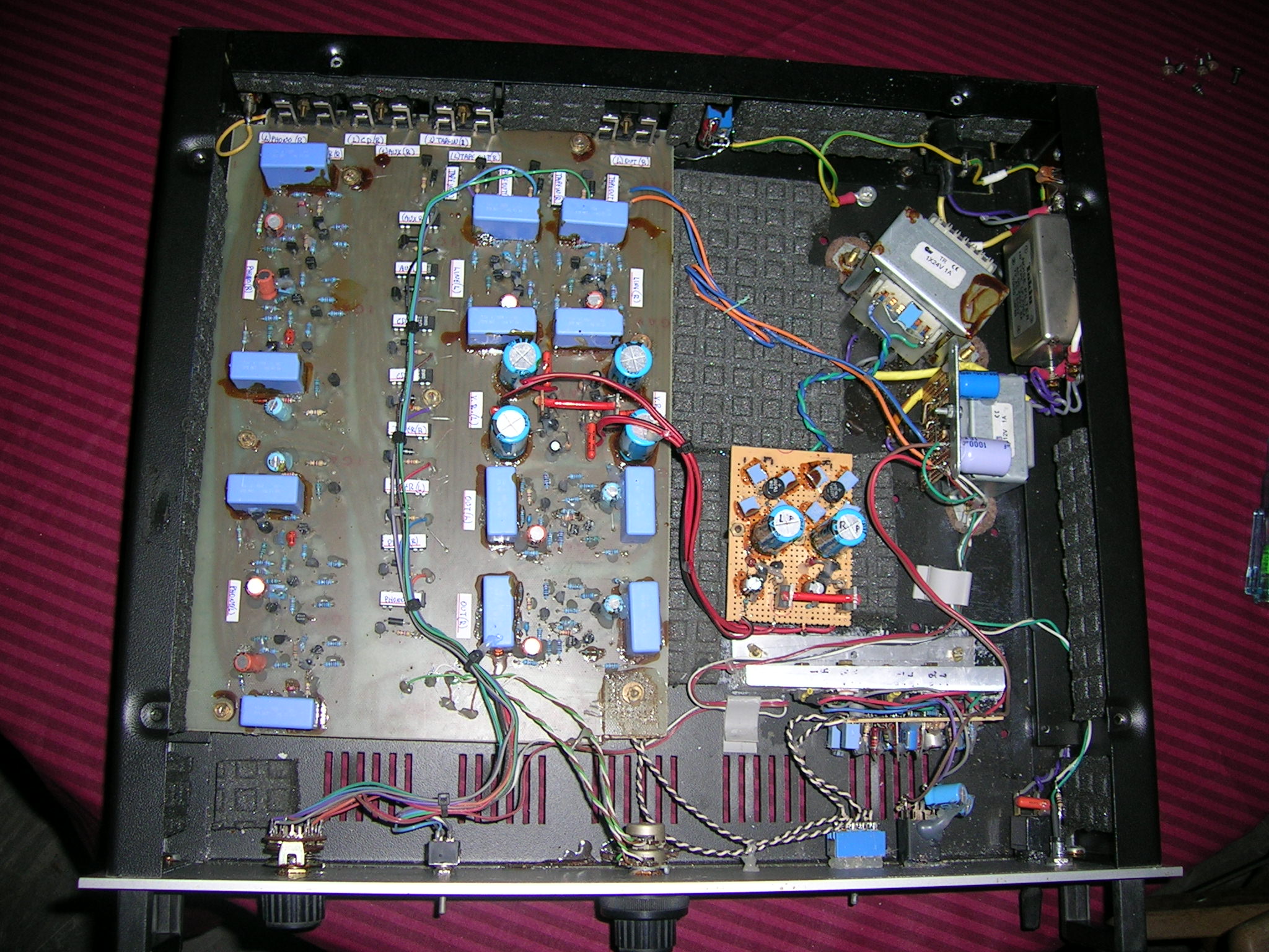

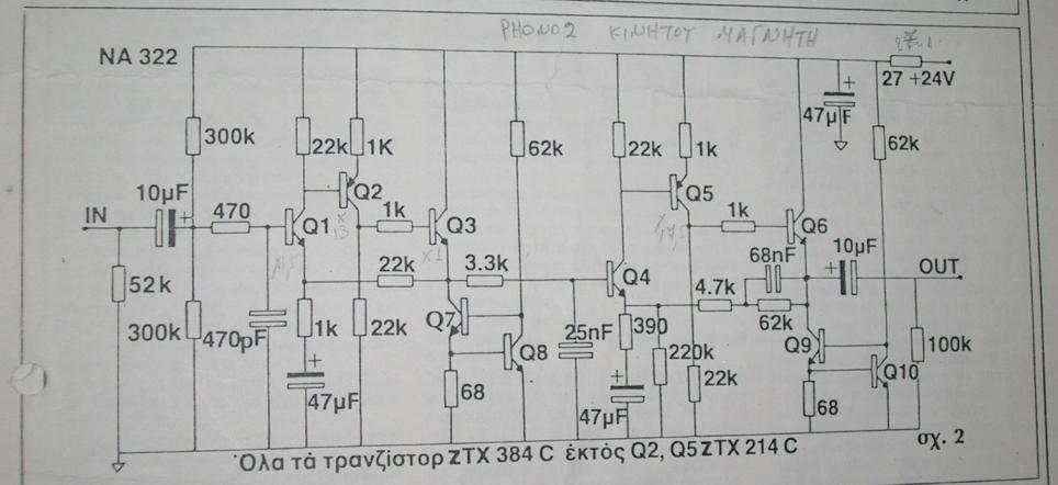

One of the preamplifiers I had built during 1990 was a clone of Naim NAC-32.
The MM RIAA circuit of this pre had the code NA322. That was (and still is) a fine circuit.

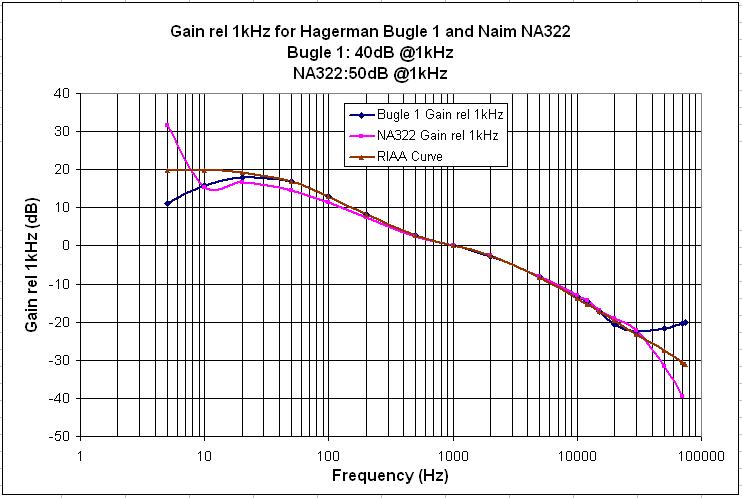

I had measured it then, found my notes and drew some plots. You will notice that it has an issue with overloading , particularly at LF.
For comparison, I plugged in the measurements from Hagerman Bugle 1 MM RIAA that I built some 10 years later. It too is sensitive to overloading but not that much. Additionally I have shown the change of input overload with psu voltage for this preamplifier.
There are 2-3 more SS preamps I built back then with different topologies. I’ll look deeper and see if I can show some measurements of them.
