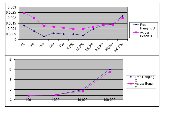

The capacitance is odd however, the proximity to the bench reduced it? Weird. Is it possible that whatever you used to hang the cable introduced capacitance?
jn
I forgot to answer the capacitance question. For the free air test it was connected to the fixture at one edge of the wooden bench top. The other end to the edge of an adjacent bench. Three foot clearance all around.
Dave
Thanks Fitzfish. I think you are on to something!
My pleasure. The question has long attracted me for a non-audio application but it is interesting to ponder in the context of speaker cables. Need to figure out how to characterize a few to see if cable Ls changes significantly with current. If it changes much using sine wave excitation into an LCR instrument di/dt step induced field changes could be well worth exploring as JN alluded to some time back.

I also have D and Q (fewer points with Q as I did it after the original measurements) if interested.

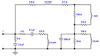

Has anyone in the pass thousand years or so developed an electrical model of a speaker which includes the nonlinear back emf generator? Not a mathematical model... an electrical model so we can use it as a load on amplifiers.... for SIM use???
THx-RNMarsh
Stereophile published this - Real-Life Measurements | Stereophile.com
