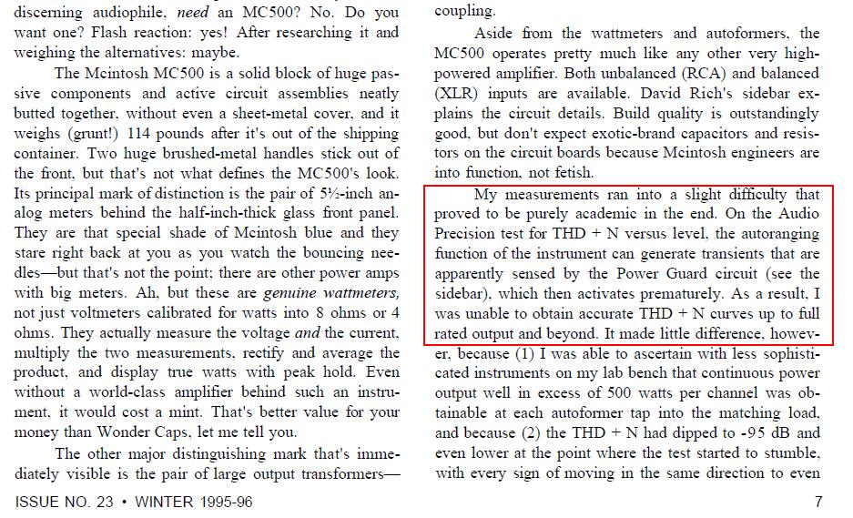

See Issue 23. He gave it a great review.
http://www.theaudiocritic.com/back_issues/The_Audio_Critic_23_r.pdf
Have a look at the attachment.
Anyone from the owners of an AP here to check what these transients are?
