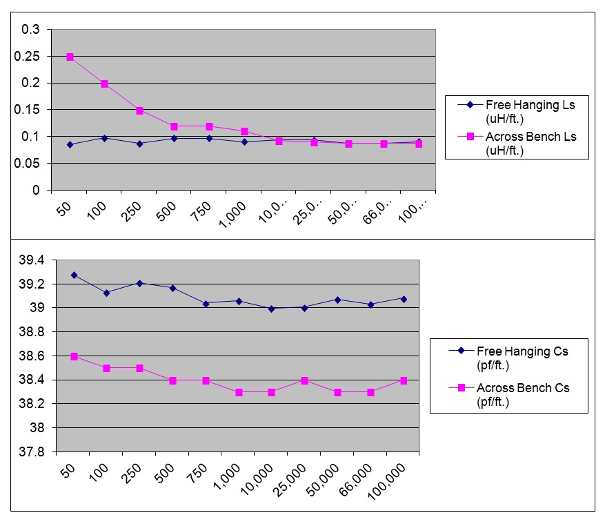

I was fishing a bit to see if there was some experience with proximity or other parasitic effects to a cable under test beyond the normal error sources. Attached are a pair of graphs showing the Ls and Cs per foot of an old ~9awg cable measured in free air vs. sitting on top of a wood and metal bench.
Dave

Jn will come and provide his valuable comment on this.
My side-comments: If higher current increases the network losses, measurement system’s noise figure will worsen.
I want to hint on the –measuring instrument dependent-risk that the resulting higher voltages at the input of the instrument may increase intermodulation distortion products. This effect is not as easily verified as the effect of input overloading, which may also occur.
I would suspect linearity with level. If metals with permeability are involved, then the BH curve will introduce level dependent changes.
jn

A rise in inductance at the lower frequencies is certainly indicative of a metal benchtop with permeability to enhance the field.. So I would expect the metal to be magnetic. At the hf end, I would have expected a drop as the metal began to exclude the magfield.
If you repeat but use Ls/Rs, I suspect you'll see Rs increase at the upper frequencies. If you feel like doing it, that'd be great.
The capacitance is odd however, the proximity to the bench reduced it? Weird. Is it possible that whatever you used to hang the cable introduced capacitance?
jn

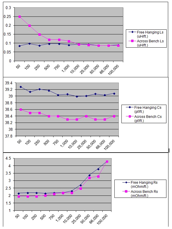

JN,
Your analysis on the bench materials is just about spot on. It is a wooden door top over a steel frame. There is a steel drawer set under the area where the cable was sitting for the test. Perhaps the distance on the HF end contributes to the lack of rise at the high end. The cable is the star quad alluded to earlier.
Easy to oblige as I recorded all of the data at the same time. I also have D and Q (fewer points with Q as I did it after the original measurements) if interested.
Dave
