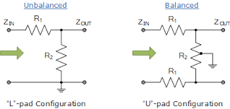

Incidentally, simply adding a series resistance in the circuit is not the right way to attenuate a signal. Use a pad which approximately matches to the circuit impedances, like one of these:

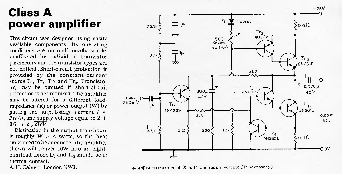

I do wonder about the high value resistor on the input to TR1. JLH will have had reasons for using the values he did. If built bear that in mind.This is the other version. It has it's interesting aspects
Where a diode is used as it is some circuits use the BE junction of a small transistor. Not sure if there is any advantage really but may be to remain at the same temp as the transistor. That's the aspect to think about. One circuit used a ZTX part and from memory their cases are thinner than others.
Some of the TR's are available. The odd numbered PNP isn't. Maybe the pnp version of the lower npn would suite. Check the specs. Power tasnsistors usual problem, not available. Spec's can be found.
The most interesting aspect of this circuit is how close it compares to the JLH 1969 with the alternative quiescent current control circuit published in Wireless World 1970 fig 2 on page 608.This is the other version. It has it's interesting aspects
The main difference in the cicuit submitted by A.H.Cavert is the omission of a 500uF base modulation cap between Tr2 emitter and base. The omission converts a push pull system into one that is single ended, one less efficient, and devoid of the distortion cancellation properties of push pull operation.
Chronologically the JLH circuit predated the Calvert circuit idea also published in Wireless World and unlike JLH and Nelson Jones earlier, whose works warranted full articles the privilege of publication of a full article was not accorded to Mr Calvert.
The power transistors he chose came in TO36 packages which are round. Thus the heat sinks would need isolating from the chassis and the devices have far worse frequency characteristics than ones chosen byJLH even 2N3055H are better.
As JLH has a large following on balance I doubt anyone apart from you would consider building Calvert's circuit.
