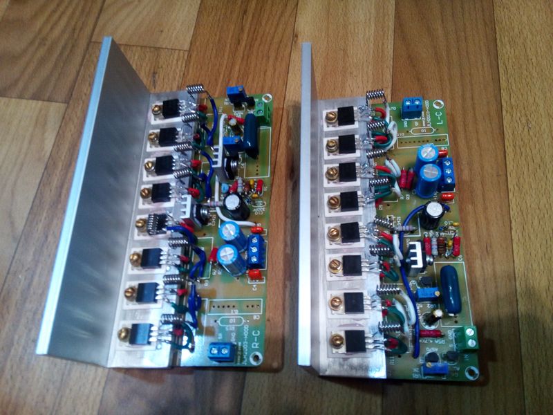

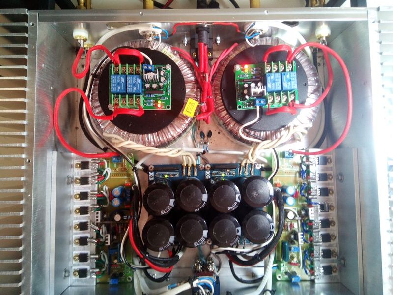

thanks, but for me this is already a passed stage (see attachment) getting a serious sound from JLCH will not work in principle, but something can be improved, so try to improve something ...
