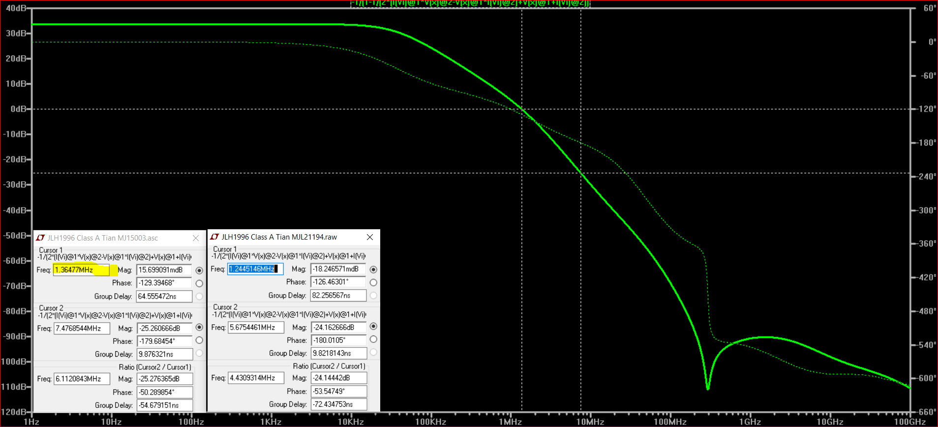

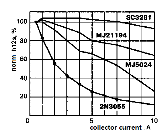

I will concede that MJL3281A has a greater Hfe than MJL21194. A stability plot for this used in combination with a BD139 rather than the 2N1711 phase split will be stable as the BD139 has a lower fT than 2N1711.Well, I don't disagree. I've also posted, some time ago, that one instance of JLH I built with 3281A output devices needed a 33pF compensation capacitor to stabilise. I don't however, recommend JLH's proposal for compensation which he wrote about later using three additions. The 3281A or 5200 versions have given the lowest distortion of the circuits I have measured.
I'm not sure about your comment "similar current gains". The datasheets I have suggest that the 21194 gain has a minimum of 25 (typ. 50) compared to the 3281A at 75 (typ. 100). Though the 21194 could be better for low load impedances compared to earlier devices like the MJ480 or 2N3716. Since the JLH is a minimalist design, higher gains are beneficial, as JLH noted in his original article.

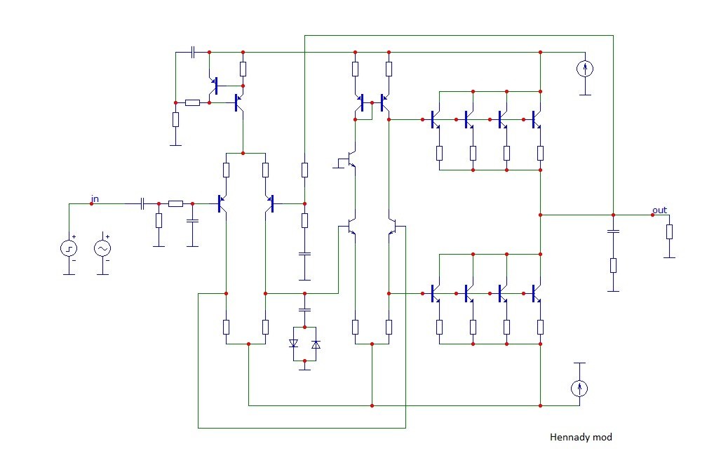

Naturally repeating the model of 1969 is a step to nowhere, it stands still, you need to move and develop the topology and quality.@Hennady Kovalsky, if you want supa lo THD and slew rate, JLH 10W is not for you.
Even the 2003 and 2005 models are a slightly improved version, but this is not enough.

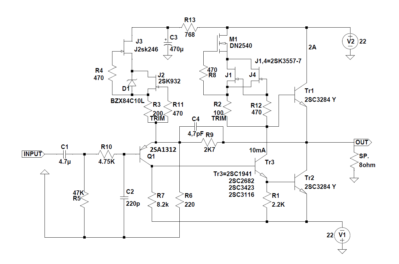

I got a similar distortion value, which is why I actually took up the modification. In the attachment, the version of my modification is much superior to the original version, while it has a greater output power and at least 10 times less distortion in the entire frequency band. By the modification itself, it can be seen that there are no significant changes in the signal flow in the topology, but the result is simply many times greater than the original.The distortion figures I reported (0.,15% at 20kHz) were using an 8 ohm load variant, and it gets worse still for the 4 ohm load.
if you erase the attachment, much becomes clear without words. it is very difficult to understand hams still using the 3055 in class A.
indeed a 33pF capacitor in parallel with the 2.7kΩ Feedback resistor was shown in a JLH 2005 implementation paper on transistors 2SA970, 2SC3421, and two pairs of MJ15003.
I found my data on a modified version, with an output power of 31 watts (6 ohms) 0.048% (1 kHz and 20 kHz) only the 3rd harmonic. With an output power of 1 watt into a load of 6 ohms, distortion is 0.006% (1kHz and 20kHz) 2nd harmonic, 0.0015% (1kHz and 20kHz) 3rd harmonic. As you can see, the level of distortion did not depend on the frequency.I reported (0.,15% at 20kHz) were using an 8 ohm load variant,
P.S. for topology JLH, load with an impedance of 4 ohms is strictly contraindicated.
Wonderful idea!Naturally repeating the model of 1969 is a step to nowhere, it stands still, you need to move and develop the topology and quality.

I have looked into the stability of the 3281 version, and suggest a slightly different arrangement for stabilising if putting a capacitor across the feedback resistor is considered inadvisable (Bob Cordell suggests this, though I have not foud any particular problems).
This is to use a version of the compensation technique used by Bailey, with a 100pF capacitor connected to the emitter of the PNP input device in series with 100 ohms connected to the driver collector, and accompanied with 47 ohm "sprog stopper" resistors in series with the 3281 bases. Tian plot I ran showed no 180 degree phase shift, but a gain increase and phase reduction beyond 100MHz due presumably to forward conduction through the transistors capacitances. Otherwise, phase margin and gain margin were 80 degrees and 30dB.
in the proposed modification, the diffcascade isolates the emitter from the electrolyte capacitance in the negative feedback circuit. There is no need to have a trained ear, as the electrolyte degrades the sound quality in the original JLH.The summing of parts, especially active parts (the differential amp, the "positive" feedback-loop and so on), brings the sound down.
I have a musical education, in my youth I played in an ensemble, all works projects are tested for listening, including blind ones - so the subjective opinion becomes more objective and really helps to determine successful topological solutions in power amplifiers.But my experience: 9 of 10 parts are unfit for audio! A lot of work I do see.

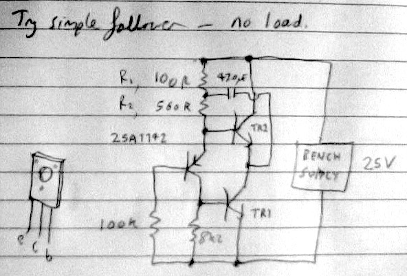

Just discovered.
I would continue this path. For instance Tr1, Tr2, Tr3: any others in TO-126. I would try a lot of transes: these do sound very very different, 9 of 10 are unusable for audio;-)-;
Remove the bootstrap C and put R1 and R2 together.
Trimmer between output and base Tr3.
10 - 20 V supply will do.
You could use as follower, as 1 step amp, as 2 step amp.
I prefer the 1 step amp most.
