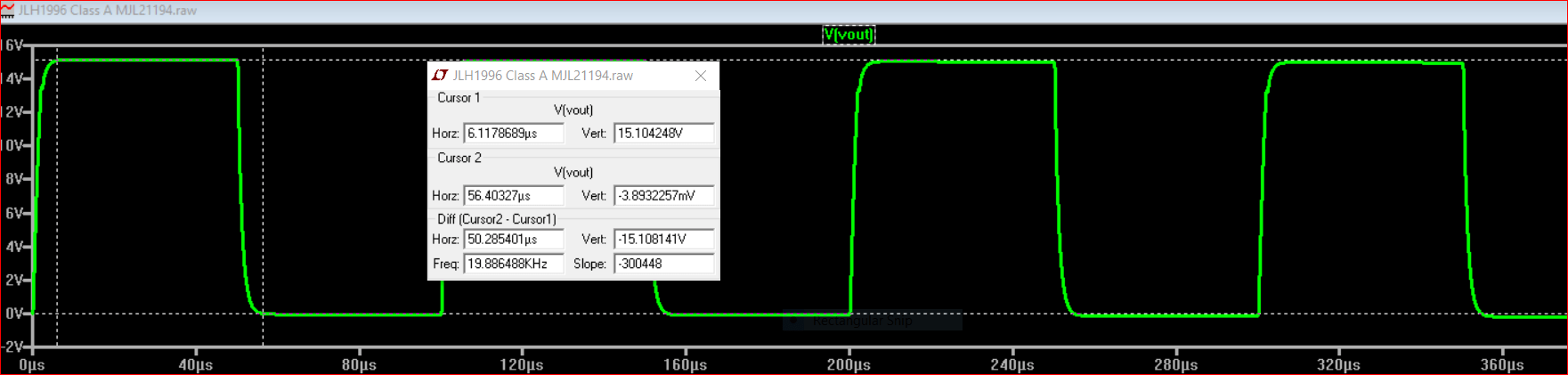

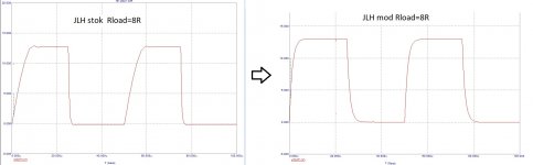

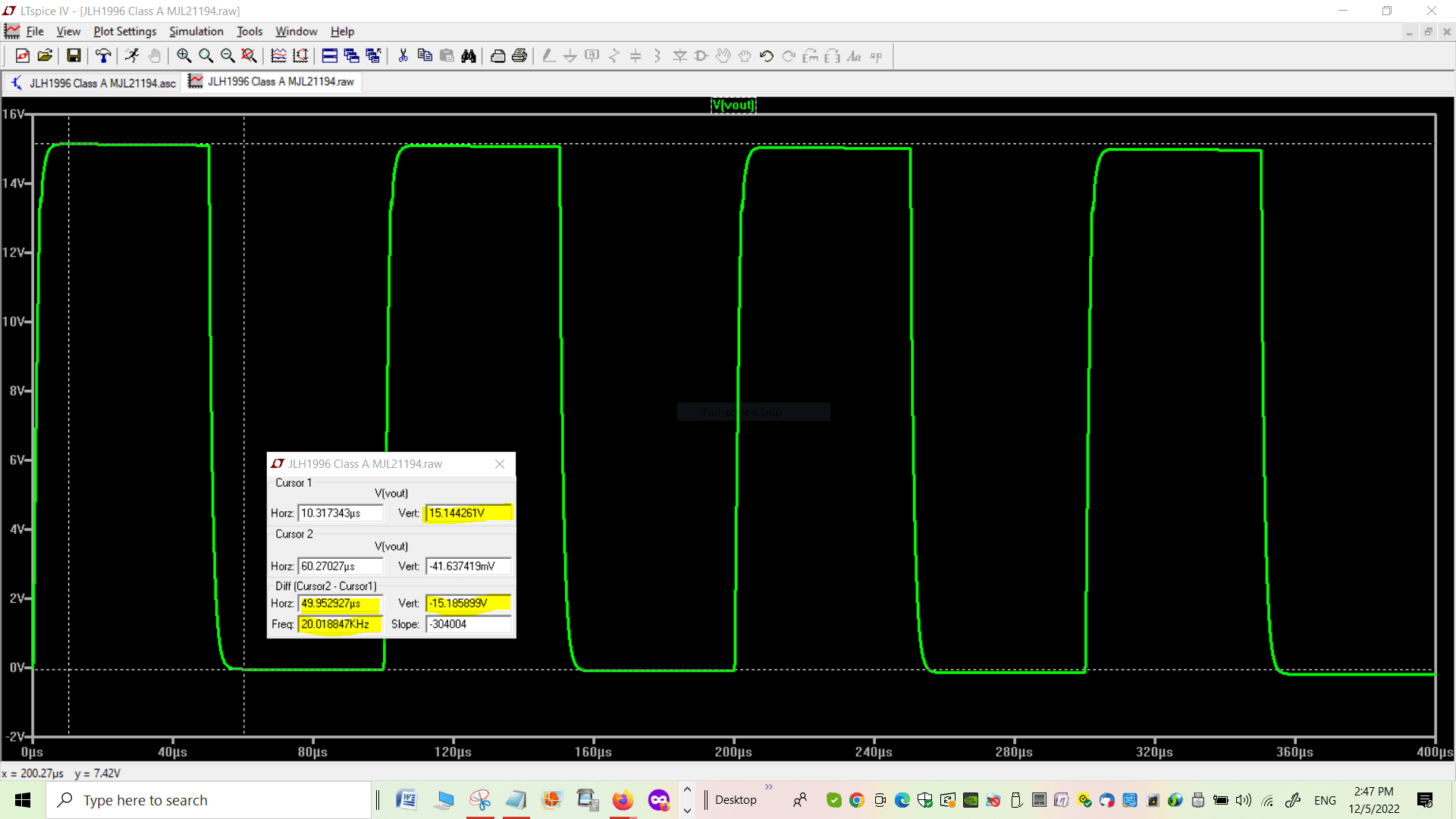

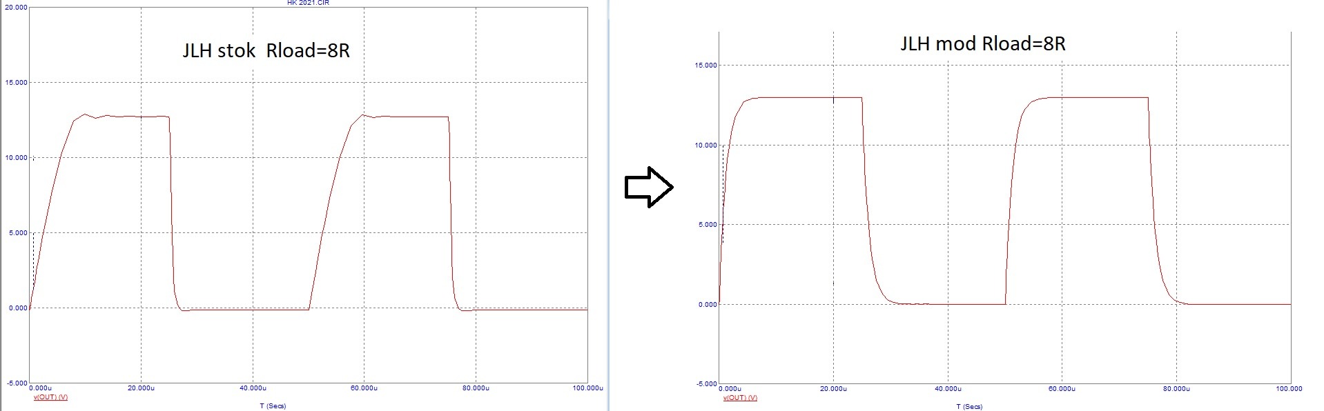

The image shows rise time and settling time - you did not include a cursor for the latter.It is better to see once, in the attachment of the meander of the stock and modified versions, the current of the power transistors is the same, the sensitivity is the same, the load is the same, only modification is necessary to get a modern sound.
If you had done this you would have seen the time difference between these points equates to a frequency of 20kHz at high power output for the whole amplifier. If there was a slew rate issue due to the Vas stage as you have inferred that would not have been possible.
See attached image for 15 volts peak into 8R - bottom left hand corner of Diff time 50uS and frequency 20kHz horizontal cursor 2-cursor1. The small deviation in these results is due to dc offset of 6 mV.
do not write nonsense, the settings are the same for both versions of the circuits.The image shows rise time and settling time - you did not include a cursor for the latter.
Seriously? did I assume something to the Vas stage?If there was a slew rate issue due to the Vas stage as you have inferred that would not have been possible.
you seem to have deviations from understanding the essence of the process.The small deviation in these results
It was assembled of in fact 4 options the JLH, the reason for the modifications is the insufficient quality of sound reproduction on the reference acoustic systems. The meander was looked at on an osfilograph, the shape of which corresponded to what was in the simulator without any "cursors", and only from the 4th modification did the sound become more / less decent. further modification required a complete redesign of both the topology and the printed circuit board - no one agreed to finance this work, because. there are more versatile and much better subjective sounding schemes.
