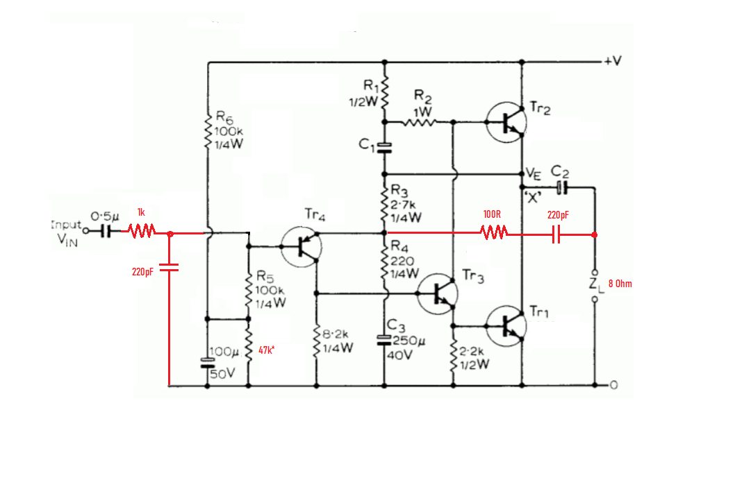

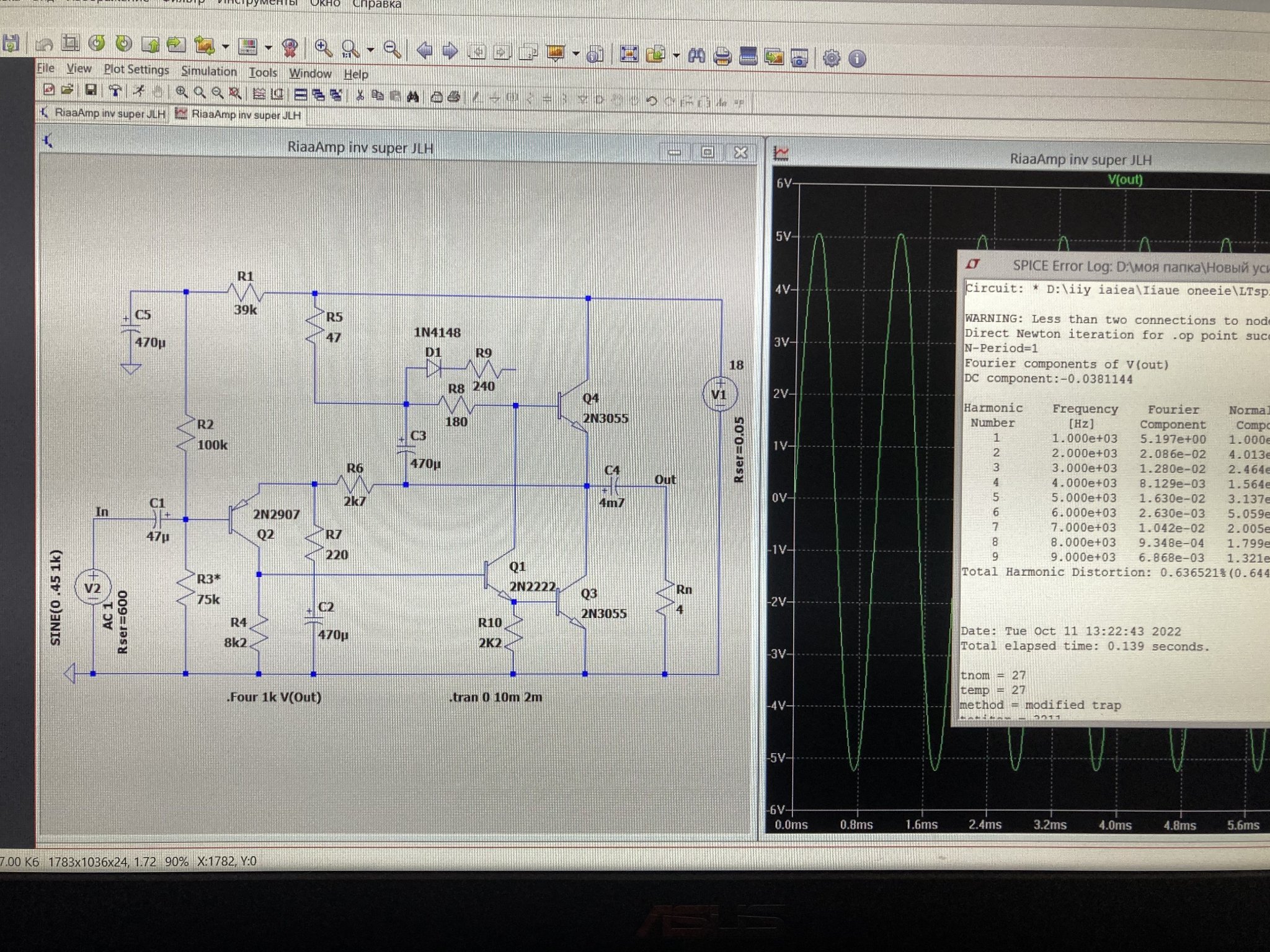

Limiting the signal bandwidth is seldom discussed here. Perhaps that's because of a common notion that supersonic bandwidth is somehow better. So, what characteristics or design would you suggest for this type of limiting filter?
the input RC filter limits at a frequency of 0.72 MHz, which is less than the frequency of unity gain per octave, and RC in the NFB circuit approximates the gain reduction to the unity gain frequency to a drop of 19dB per decade.
I focus on the transient response, see attachment.Thanks for the suggested details. Where there are problems with local solar power, industrial power systems and radio transmitters etc, I expect RFI and EMI would be reduced significantly too.
Yet I run into "design engineers" who think that, as long as the PCB matches the schematic, nothing can possibly be wrong with the layout and routing. What hope do poor amateurs have without some rules of thumb ?I'm not sure whether you're agreeing or not. Of course I'm not suggesting that a badly designed board is going to work.
For the record, I worked with boards that simultaneously carried GHz RF, microprocessors and DSPs, analogue audio, and switch-mode power regulators. Then I had to get them through EMC testing. So I'm well aware of parasitic coupling

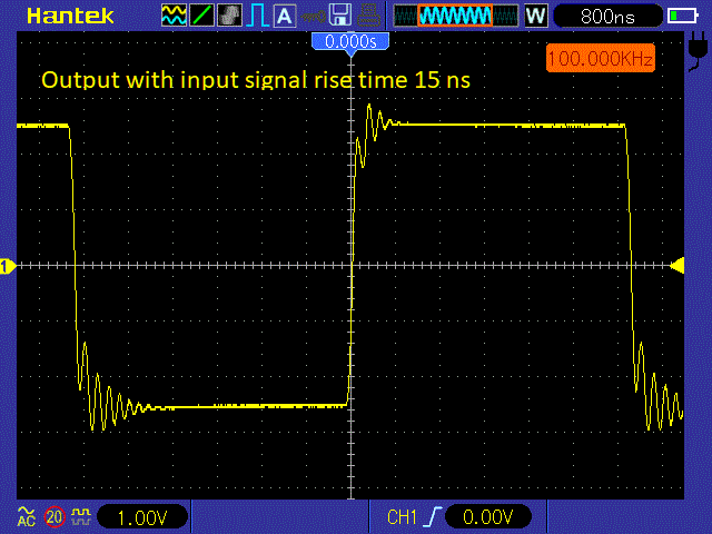

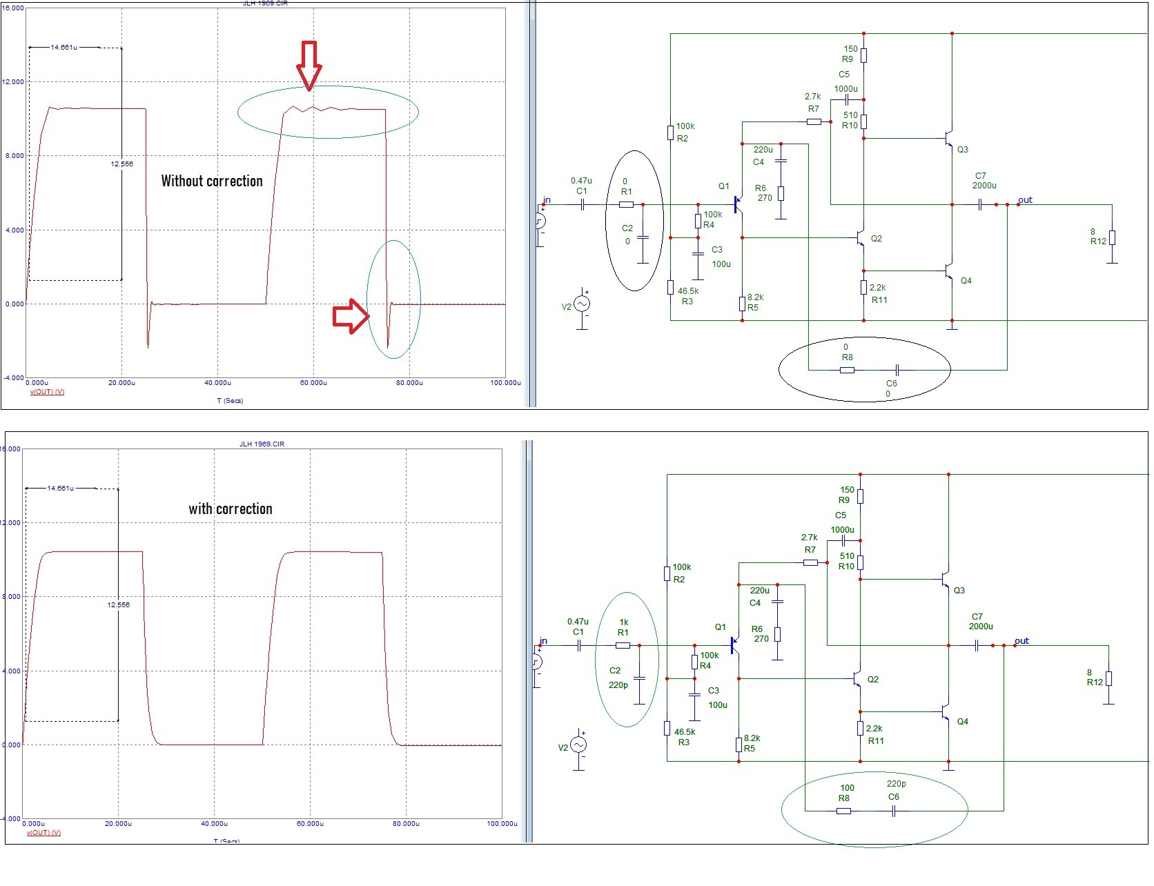

To illustrate benefit of input signal bandwidth limiting, here is measurement taken on simple diamond buffer with CFP output stage and measured power bandwidth of 1.6 MHz (220 ns rise time). This is unity gain buffer with no GNFB.
As this is prototype assembled on the breadboard, there are enough parasitic inductances from long wires to introduce solid resonant gain peaks at very high frequencies.
Square wave input signal with bandwidth above 20 MHz (15 ns rise time) will trigger all those parasitic and effect is visible as ringing.
Now, if we limit input signal to 200 ns rise time, amplifier output signal is clean, with just slightly increased rise time, while no changes were made on the amplifier circuit. Input RC filter does just that, limits input signal rise time, as was done using controls on signal generator.
Usual audio signal can’t have such fast rise, but if someone is fan of NOS DAC with unfiltered output (leaving filtering to rest of audio chain), it would be good to consider eventual consequences.

Thanks Hennady! I will try! Today my circuit looks like this:I focus on the transient response, see attachment.

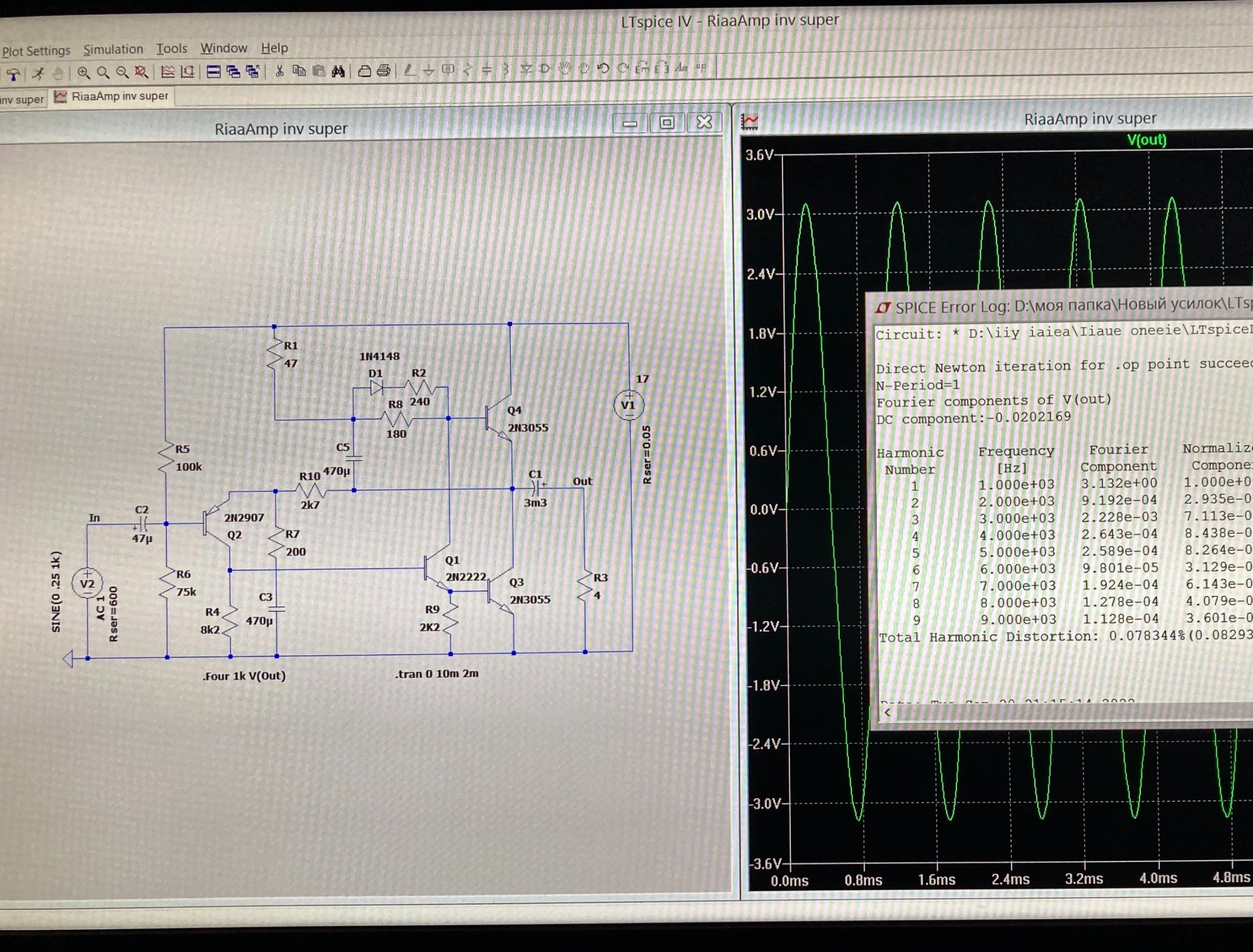

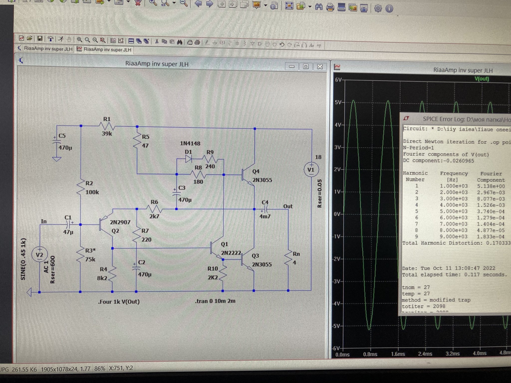

Modeled JLH again. The basic parameters are somewhat worse than in the amplifier that I previously set. But I made an attempt to improve the standard JLH, and the attempt was successful. The added D1 R2 circuit in the Q4 base circuit halved distortion and increased the maximum undistorted output voltage. You can add it to your ready-made amplifiers. 👍
You're right. I haven't used it for a long time. Here is the original scheme. And in this case, the presence of the D1 R9 circuit allows you to correct TND by changing the resistance of the load circuit Q1 for positive and negative half-waves.

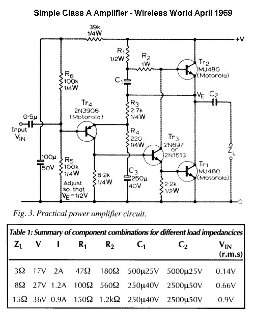

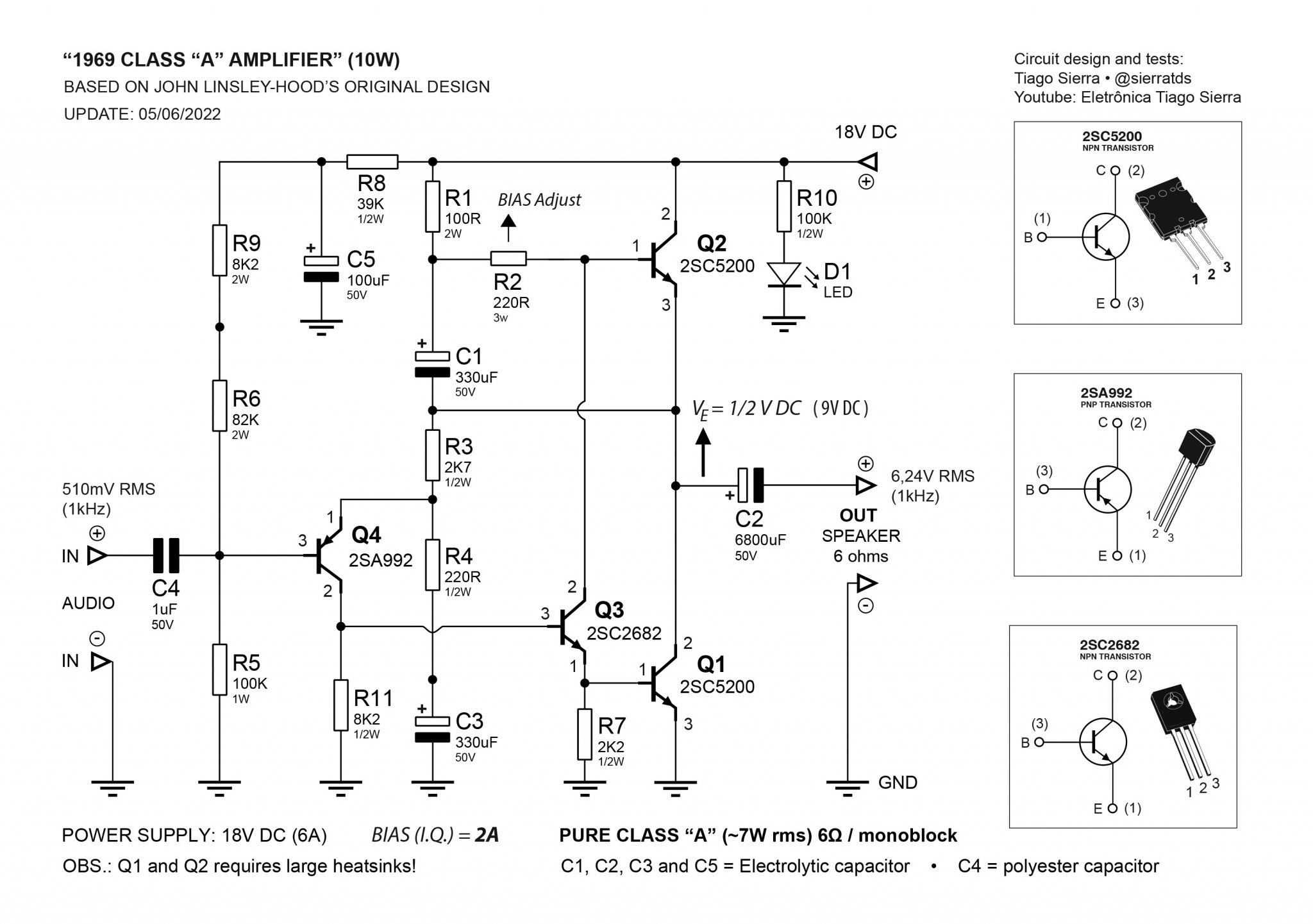

I note the use of high Ft output transistors 2SC5200 and discussions of low pass filtering at the non-inverting input to avoid intrusion of environmental hf signals from inter-modulating with audio signals.
It is easy to overlook that an inverting input exists at the emitter of Q4, with potential risks that environmental signals can be induced into lengths of cable or coils of wire such as loudspeaker coils and crossover inductors. Also loudspeakers are alternatively back and forth motors/generators.
The JLH design has no internal capacitors limiting the frequency range of the voltage stage. This needs to be reduced to less than unity = 1 before phase reversal at 180 degrees.
Due to 2N3055 having lower operating frequency than the other transistors in the circuit the output devices set an inbuilt dominant lag. JLH claimed this made the circuit unconditionally stable.
Transistors like 2N3055 where the transition frequency is low can be described as slow in terms of switching times and having roughly a tenth of 2SC5200 the gain bandwidth product and longer switching times.
In a constant current Class A system there is zero switching to be done and 2SC5200 has no practical advantage. The disadvantage these have is excessive response out into the 30 MHz frequency range where modern electronic devices generate signals which have potential back door entry.
To keep dust or leaves from blowing into the house who would think of having a door 30 feet wide where one 3 feet wide would do.
To reduce the transition frequency with 2SC5200 to the same level as 2N3055 to attain the same stability margin, a common DIY approach is to add a capacitor in parallel with R3. The impedance of capacitors reduces with increasing frequency so there is a bypassing effect with R3 - this strategy can impose a risk.
A better approach would to create step response network by an RC network in parallel with R3 such that loop gain falls below unity by a safe margin leveling off somewhere below the associated frequency point.
The closed loop gain of this amplifier is quite low. If the line stage to drive this is based around an IC op.amp for the lowest THD the closed loop gain of this should be of the order of no more that 2 according to articles by JLH on pre-amplifier design.
In combination the total amplification is low if the preamplifier as padding resistor networks for input sources so the signal levels are equal when selected.
There is some potential in using devices like 2SC5200 to allow an increase in the closed loop gain of this circuit. The increase in gain will result in a reduction in frequency response.

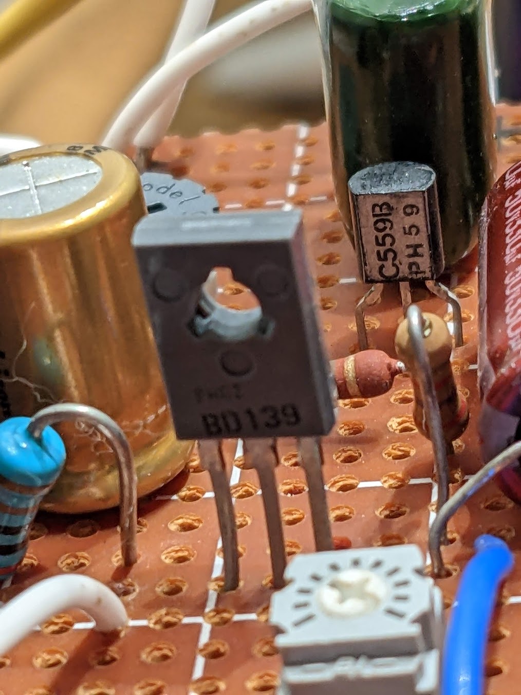

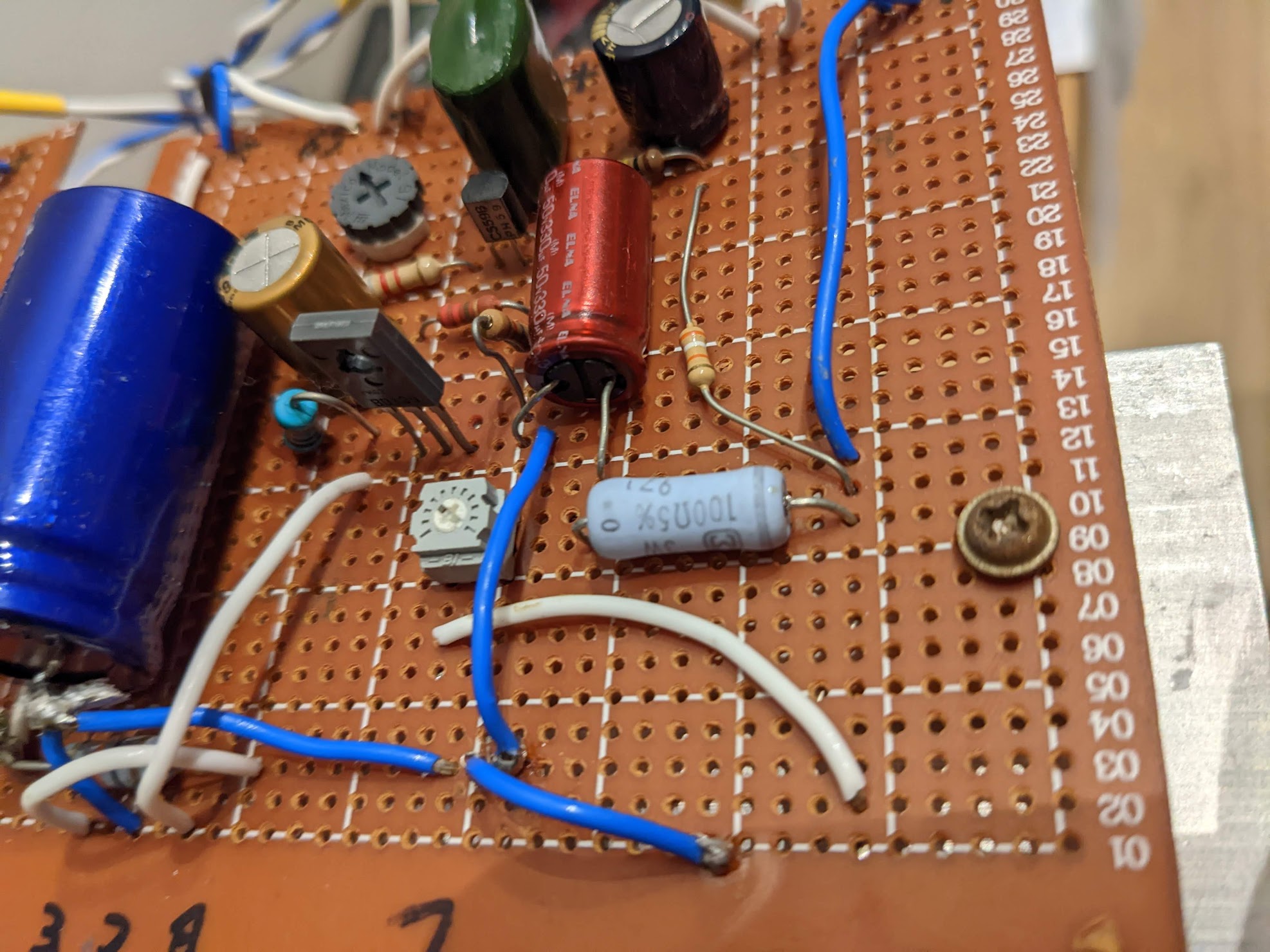

Hey all, my JLH is showing some initial signs of life but with some strange behaviours and I need some ideas
It is pretty much following the JLH69 schematics with:
Transistors: BC559, BD139 and BD249C
Power is right now an 18v / 6A laptop SMPS and my speakers are 8Ω

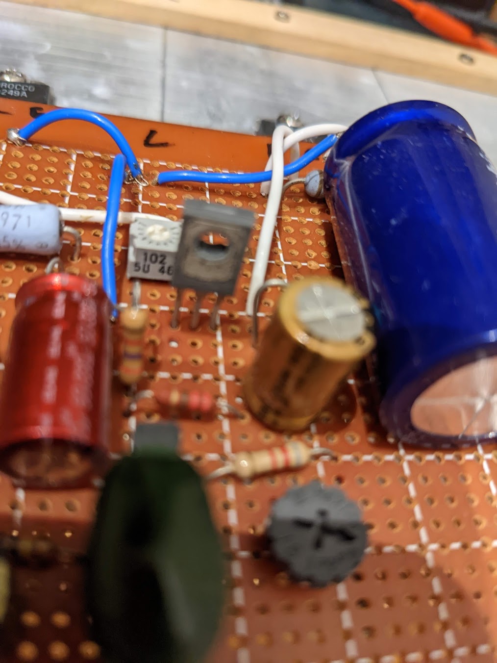

I have hooked everything up, set the Vx to half (9v) and started to test out with some music source.
If you look at the attached JLH circuit part names I have an 100Ω for R1 and 1K pot for R2.
I only manage to get clean sound when R2 is turned all the way to one end and while turning it towards the other direction the sound gets distorted pretty badly.
At the same time whats really weird is:
Any ideas or suggestions would be much appreciated!
