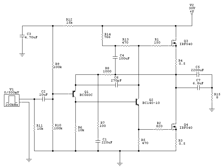

I just started my listening test of my pair of MOSFETs JLH 10W Class A amplifiers....
.:eek: oooohhhhhhfffffffffffff the sound stage is soooooooooooooooooo much better :cool: than my original BJT version..
I was chocked realy... I'm really really very euforic on this one.. it's so nice to have that 'virtual live performance quality' .. the soundstage covers allmost my whole back wall...
after several days of simulating, buying parts, blowing MOSFETs, failing soldering iron, discussing the circuit, again simulating alll night, measureing on scope, optimizing, again simulating, again blowing MOSFETs, again buying parts... .. but it was worth while..
The only problem I have now is that I can't say ' well it must be the MOSFET output stage being so superoir' .. because I used different parts, and gain sturcture.... so many factor have changed that I can't claim the MOSFETs must be the reason why it is so much better... I also spend far more time optimizing on this one that on my BJT version..
I will attache the circuit I have used for my version. I sound very very good, soundstage is fabulous, tembre sound good, but I thinks that more difficultto judge....
Thanks Millwood for the inspiration!

Hi Millwood,
my version has much higher Iq in the driver stage then yours. I think that's the biggest differernce between our versions
ActuallyI think the standing current in the driver stage is an minor detail. The current in it self doesn't help anything, but the lower driver resistors (needed for higher current) help speeding up the circuit as you have shown in simlations. But since the speed of the circuit is high anyway, going from 1MHz to 2MHz bandwidth is not nessecerraly an improvement.
What is important , is that both output devices stay in exact anti-phase. This a also invluenced by the gate-snoopers. Their value is importand and not equal: upper 150 Ohm being the minimum for stable operation, lower 820 for equal bandwidth.
Further more the high and equal source resistors (0.5R because I only had 5 1R resistors, so 0.33R wasn't possible) and the equal driver resistors (470R) garantee allmost perfect current sharing.
Than the 270pF compensation cap is neccesery to reduce overshoot. Such a compensation cap can be placed at different nodes in the circuit, but this place achieves most symmetric and highet slewrate wihtout overshoot (the 100KHz square wave looks perfect allthough a bit rounded) .
As I am typing now anyway, I will point out some more design issues: :rolleyes:
The 4.7uF input bias cap is choosen to speed up the turn-on-bump (now only a few ms).
The 100uF bootstrap cap is choosen large to garantee the correct phase relationship of the upper/lower output current. Choosing this too small causes significant currentto cross-conduct from upper output device to lower output device.
Input resistor 10K is choosen a bit low to limmit output to input couping, which can causes oscilation.
Well that's about it .... any questions.. please ask :)
Best regards,
Thijs
PS
be nice to Geoff... I'm sure there's no attitude involved..

Hi X-pro,
LOL
:clown:
I was convinced that the MOSFET version wouldn'twork etc ect ect, but Millwood pushed on so I kept on thinking, simulating and perhapts most improtantly drawring with pen and paper untill I understood....
A MOSFET JLH 10w Class A works in perfect Push-Pull.
One more time... please take a close look at the schematic while I explain...
Because the current that passes through the lower driver-resistor (470R my last schematic) must also flow through the upper driver resistor (also 470R in my last schematic).
So (drive-resistor) voltage drop across the driver-resistors is equal..
Since the lower MOSFETs' source is tied to ground, this voltage drop is all it drives
For the upper MOSFET is becomes a bit more difficult to see, but the 'not-really-a-bootstrap' capacitor is acting as a voltage source, it dictates that the upper node of the upper driver-resistor must followe the output AC voltage.. since the gate is tied to the lower-end of the upper driver-resistor, the same drive-voltage that drives the lower MOSFET, is super impossed on that, in effect both MOSFETs are driven equally in anti-phase ...
For this to happen
1]both the driver-resistors must be of equal value, and
2]both MOSFETs must has equal transductance ( 0.5R source resistance helpt but not really nessecery)...
3]The 'not-realy-a-bootstrap' capacitor must act as voltage source, so it impedance must be << 766R at all frequencies..
I am quiete convinced that I'm not mistaken, I've simulated it, build it, and measured it, this is how it works..It even sounds good :clown:
Best regards,
Thijs
I suspect that what the higher gate stopper does is to slow the lower mosfet down so that the whole output stage works more as a common emitter than a common collector configuration.
I am still of the view that there is no need for "perfect" current sharing, either in the original jlh or this modification.
Graham Maynard said:
There is less output power from Mosfets, though they will automatically run into class-AB in the JLH circuit.
I never understood this when tschrama mentioned it a while ago. When overdriven, the BJT version will go into class ab as well: a hugely positive signal will shut off the lower bjt. The same is true here with the mosfet version. so what's so unique about the mosfet version?
that's one of the fundamental principles of class-A push-pull,
so what exactly are all of those "fundamental principles" of class-a push-pull? Why don't we list them all out here so we all have a common frame of referrence? BTW, why are they "foundamental" to a class-a push-pull? and what referrence do you have that says they are indeed foundamental?
Disabled Account
Joined 2003
this, in my view, is the single biggest assumption and potential problem area for the jlh design. Because of the output asymmetry from the driver (higher Zout on the upper end than on the lower end), any device with high output capacitance (the driver), or input capacitance (the output devices) can cause large phase shifting between the upper and lower output. This is where MOSFET has output devices have a decidedly disadvantage over BJT.
the "cure" is to run higher current through the driver, like I did. However that has its own evil: it tends to overload the input transistor.
All of this, I think, calls for a MOSFET driver stage. The mosfet has to be a small signal or medium power mosfet with small input capacitance (and its variance) and high current capabilities. I am looking into some fairchild mosfets to see if I can find one that works.
Actually the purpuse is to garatee equale drive impedance, compensating the different output impedance of the driver output. This causes major cross-conduction spikes at HF (sims and measurements agree once more) ..
The different gate-snoopers take perfectly care of this problem. Even with this increased gate-snooper,the MOSFET as faster than my 2N3055.
Well, a partial cure is to decrease the source impedance, the associated increase in driver current is just a side effect. Still: lower impedance doesn't help much. Actually you are moving the same problem to a higher frequency, just as severe, but more dangerous. You really have to balance them with different gate-snoopers.
Sadly, the BJT does not run into class AB, it tries, but succeed only marginally. The input impedance of the 2N3055s being the cullprit, hence the MOSFETs go into class AB very smoothly indeed.
Can you comment on your perceived sound quality Millwood? I being very very happy with mine so far..
