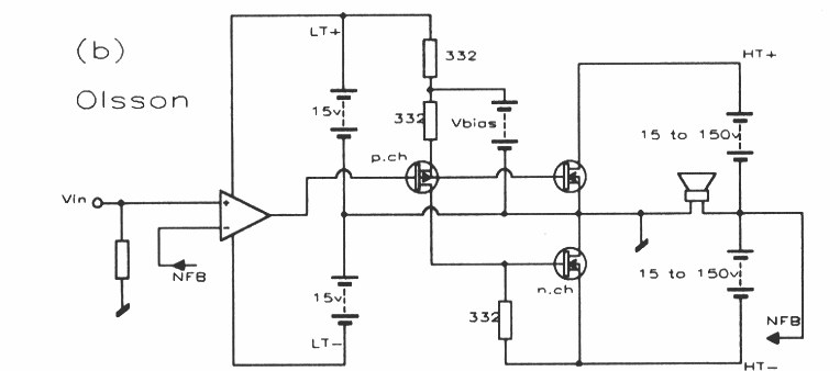

tschrama said:
Hi all,
X-pro, all your comments are right on the spot. I troubles me a bit. So what should we do? Your design doesn't suffer from that problem, am I right?
Thijs
Yes, as my design uses a current source to set the idle current, it is not affected much by the power supply variations. Indeed in the last revision of Creek Audio 5350SE integrated I did manage to maintain the idle current over supply and temperature (from 20 upto 80 C on the heatsink) variations down to less than 10% from 65 mA without any source resistors in the circuit. I've calculated that it indicates about 0.1% precision of tracking the Vgs of the output devices. I'm actually fairly proud of that circuit :) .
Strictly speaking you may try to use a current source instead of the top resistor in your circuit - it may even work better. Your circuit actually looks a bit like the design by Olsson published in EW+WW Dec 1994 - I attach the scan here (from Ben Dunkan's book "High Performance Audio Power Amplifiers" - an excellent book on the subject). As you may see Olsson used a "battery" (actually a zener-like network) instead of a bootstrap capacitor.
I can also add that my circuit actually predates Olsson's publication by more than two years.
Cheers
x-pro
