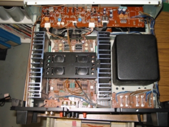

JLH in Technics SE-A5 enclosure
I'm thinking I'd like to put my upcoming JLH in this old amp case. I can use the inner windings on the transformer (24-0-24) and a cap multiplier / regulator circuit to bring down the voltage to a reasonable level. I may be able to fit some fans in above the heatsinks to cool off all the transistors (cap mult. & parallelled outputs, 12 transistors I think).
The single supply idea may also work, but as I don't have two independent secondary windings I'd have to use a full-wave CT arrangement.
Thanks for Geoff for providing me with a single-supply version of the latest JLH design some time ago. I have a prototype single channel but haven't got any further as yet.
Any thoughts?

That looks like a nice big amplifier Paulb,
are you sure that you want to dismantle it?
A 24-0-24 trannie is suiteble for single 30V supply isn't.. for a dual supply it might be a bit high for class A.. do you have any idea what the wattage rating was for the power supply/amp?
Goodluck,
Thijs
Goodluck,
Thijs

Lemme get my notes...it's rated for 160W into 4 ohms, but it has inner 24V taps on the secondary winding. For some reason, they have a low/high power switch that selects between the two transformer voltages. I figure that will give me lots of current so the transformer should be okay.
The voltage is a bit high, which just means extra dissipation in the regulator transistors. I'm planning on tweaking voltage and bias current to even the dissipation among transistors and to set whatever I can get away with before the temperature gets too high.
Odd to get about 10W per channel from a 320W amp...
I looks like you will be OK with your transformer.. (those heatsink look nice too...) ..
My Technics has a similar feature, a switch to chosse between 4 and 8Ohm, selecting different volatge taps on the power transformer.. I think that is neat...
I don't know what your plans are, but counting 12 power transistor could mean you are going for a ESL-version, with double bias current?
Well .. I sure you're going to buyild something good... keep us posted

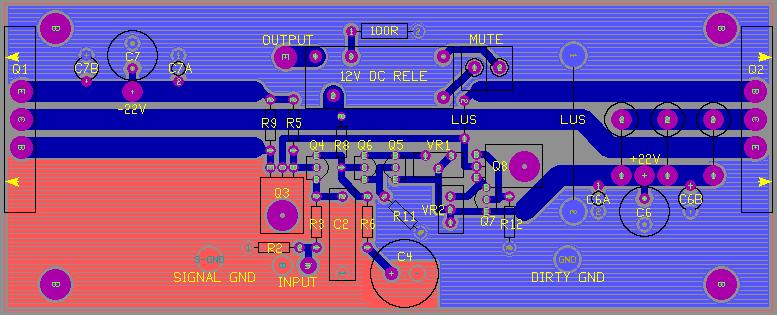

Within this string there is a pcb layout that made me go 'yeuchhhh'. It is a long narrow layout with power devices at opposite ends. I have always separated input circuitry from power plus output device connections by having them at opposite ends of a pcb. I have never needed to apply any extra stabilizing components.
If anyone is unhappy with the hf performance, there must be a reason, maybe the pcb, or maybe the comparison reference has different loudspeaker driving characteristics, as with a non-nfb triode design.

the yeuchhhh PCB
Hello Graham
That must be my Layout you talk about. but have no worry, its been testest. and after changing back to The Penultimate Circuit
it is stable whit 2 2SC2922 tranis and sound just fine.
But yes you are right it is not the optimal shape for a pcb. the thing is that i am building 2 mono block whit 1 heatsink on eatch side, so i need a long PCB to be able to mount the tranis directly to the heatsinks.
anyway here are my newest attemt. q3 and q8 are coled from the 10mm alu plate/bar the pcb is mouted on.
Hello Graham
