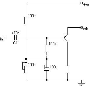

tschrama said:I do have a turn-on bump.. I thing this is because the 15K/470uF bias stabilization
Thijs
I think you are right. At turn on, due to the cap (470uf), the base of the input transistor is tied to the ground. that means the DC output point (where the output cap is attached, and the drain of the upper mosfet). So through the boot trap resistors, there is a huge voltage drop off G and S of the upper mosfet, causing a big current rush (to charge up the output capcitor).
Does the BJT version behave like that as well? Sounds like it should.

My preferred input bias arrangement for a single supply rail is attached. I don't know whether it will cure your switch-on thump though.
Geoff
i am not sure if it will do. I think it has higher input impedence than the orignal jlh. But the base of the input transistor is also tied to the ground at turn-on.

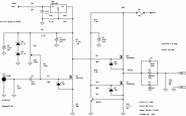

OK... I'm back.. again ...
I looks like I somehow were able to blow oneof the MOSFETs, the upper only functioned as a zener (?) of around 2.2V? Replaced it , and in no time got my amp up and running again.. but...
Still the same ringing! The amp is fast, it can produce a 500KHz quare wave still as being somewhat square... a 10KHz square wave looks perfect.. allmost .. the ringing is there,barely visible since its at ?700KHz? maybe even higher ... I tried a 390pF across the 1K FB resistor but now it has gone into spontanious oscilation at around 4MHz(?) ...
What should I do?
Thijs

"Do any of you have a better suggestion how to stabilize the amp in a simple way,safely?"
you could try 47pF between ip tr emitter and driver tr collector as a starting point.
JLH gives details of a more comprhesive network. it's a bit drastic but may be a safe starting point. This can be found on geoff's site
hope this helps
mike

on the turn-on thump: this might be a place where the bjt version has an edge. a bjt is a current device. so to reduce the turn on, one can put a resistor in the base of the upper output device to limit the turn-on current. This will not adversely impact the efficiency of the amp.
a mosfet is a voltage device. so the only way to reduce turn on current is to put a resistor on the source of the mosfet. I used a 0.2ohm resistor and I estimated the turn-on current to be around 5 - 6 amps (I blew quite a few fuses to find it out, ).
I surppose that with a larger resistor (like 0.47ohm used by tschrama), the turn-on thump can be reduced but at the expenses of lower output power and lower efficiency.
Looks like the resistors are a must for a mosfet jlh. I originally used them as a way to measure Iq. it "accidentally" saved me a lot of trouble and blown mosfets,

millwood said:I am surprised that many people seemed to have stability problems, as tschrama is experiencing. Is there any inherent issue with the circuitry as far as stability is concerned?
This little amp when made according to the original cct, with careful selection of transistors, and with a sensible layout is stable without any compensation circuitry.
however it also has a very wide frequency response and it does not, it seems, take much to push it over the edge into instability.
from my very recent simulation experiments paying particular attention to the effect various changes have on the gain/phase margins, I would recomend the following to make things better
don't decrease the feedback resistor values unless you take other measures to improve gain phase.
try a small increase of current through the i/p tr ie try making the 8.2K res 5.2 or 4.7K. for dc feedback cct's this will mean that you have to redo the dc offset by increasing the current in the ip stage CCS.
in fact an increase in standing currents generally should help but take care to notice that increasing the current in the driver cct by reducing the driver load resistor reduces the current in the o/p cct so this will have to be re-adjusted aswell.
reducing the impedence of the i/p filter also seems to help but be sure not to make it undrivable !
If for whatever reason the above does not do the trick with your implementation then it looks like a compensation network is needed. a good starting point would be a very small cap from ip tr emitter to dr tr collector.
the final solution would be impementing the full 3 element compensation stratagy as published by JLH and available of geoff's site. this is a bit drastic and could well be moderated as it increases hf distortion in it's original form and is way more than is necessary to sort out any problem in a fairly faithful implementation of the amplifier.
however from even my simulated experients I have realised that designing compensation networks is heady stuff that could well, if done incorrectly, make the problem even worse so extreme care has to be taken to avoid damage. I would not attempt this personally if I did not have a scope
hope any or all of this may help a bit
cheers
mike

Well, I managed to blow another MOSFET.. again... happend while testing a 1MHz square wave at 20Vpp ... The square wave not pretty.. the falling egde has enopurmus overshoot.... at higher Iq things got only worse.... The spontanious oscilation is gone, it was output_to_input coupling and a bit neater arangementof the wires made it go away.... There is large HF overshoot but oscilation. My BJT behave nicely in this area, but I'm gonna check just to be sure...
If we take this samekind of argument for the driver-output-impedance, then I agree for the MOSFET version. The two MOSFETs are driven from differning impedances and this make the HF behavior nasty..I think at least.. This might very well be the reason why current consumption goes up at HF (losing correct phase relation between MOSFETs) and the upper MOSFET keeps blowing ...
For the BJT case, I don't think it is a problem. Neither for the driving-part, as for the output-part...

I just tested the BJT version with square waves... again no oscilation,absolutely stable without any compensation capacitors, but some mild ringing on the falling edge, and severe assymetric slewrate...
Going to my simulator it was shocking to see has accurate the simulator predicterd the waveform on my scope... Both for the MOSFET version as for the BJT version, the spice output was very close to my actual wavefroms on my scope... complete with ringing/overshoot/assymetric slewrate ....
Thijs
