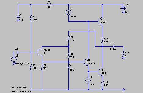

I tried it on the original jlh bjt. the lower bjt is working but not the upper bjt: it was either turned full on or full off. I used two perfect current source of 40ma each. I need to figure out why.
Note that the output BJT eat significant base-current.. so the two current source can not be equal. In the original version the upper resistor draw 40mA, but the lower 300uA.. the rest is flowing through the bases of the two output BJT... Further more the lower driver resisotor is only there to increase the standing current through the driver .. is has practically not invluence on AC current...
I allways use some high resistor parrallel to a perfect-CCS to keep my sim from crashing or giving all kinds of weird effects...something like 40k/100k.. but it doesn't seem to be nessecery now..
I used 42mA and 1mA CCS and it works.. no big improvement yet.. I guess it needs a bit of tweaking..
I could also be that the open-loop lineairity is just as good as it can be and the only improvement is to increase open-loop gain...

tschrama said:
my sims tell me that for optimum current sharing between the MOSFETS you need the make the upper-driver-resistor 0.85 * value of the lower-driver-resistor
In my circuit this means 850 Ohm upper, 1000Ohm lower..
I swapped the resistors in my simulation and having a higher upper resistor yielded slightly better THD. But I will investigate later.

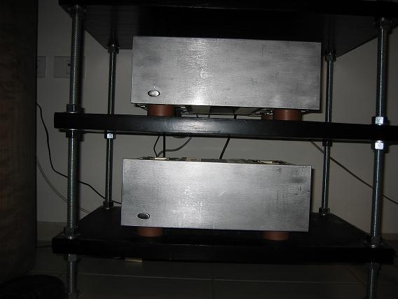

my JLH
I just got a digicam, so here is a picture of my JLH Amps.
Tnx, Geof for all your help and support.

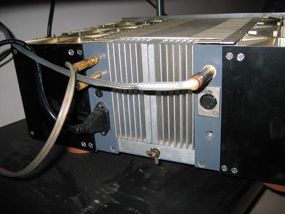

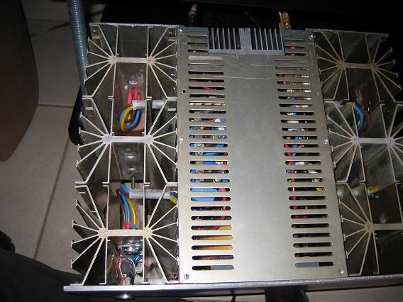

Chris,
The amps are the ESL ones with the modification of the feedback takeoff point. I tried the C4 mods and did not like the DC offset effects. Since I installed jumpers for those mods they were easy to reverse.
the Amps are not Ballanced but this is a thing I would like to try
so I put the connector just in case.
The hole below the connector hides a socket for power control
enabling to switch to standby mode from the preamp.
I do not use it since I had no time to modify the pre, I'm currently
busy with finishing the speakers for the system.
The Amps sound very open and detailed with a kind of velvety
accent. with some CDs I have I get a feeling the sound stage
extends outside the speakers. I did not expirience this with other systems I heared.
The power supply does not use regulators. I used a circuit Geoff sent me, I think similar ones are posted here.
I used 330 VA Thoroids feeding 50000uF Caps with 100n bypass.
No PS noise I could here, but I use 88db speakers.
The speaker contacts go through a relay with a delay and external control circuit, powered from a small 12v ps.
This prevents the initial DC offset variation from going to the speaker, I get around 2mv when the amps are warm.
There are allso provisions for clipping indication, does not show very well on thi pics. It's just above the power indicator.
I did not put the circuiet in yet.

I thought about this in the last week and did more simulations and here is my thoughts.
1) for the JLH to work, it does not need to be able to perfectly redistribute current between the upper and lower output devices, nor does it need the gins of the output devices to be equal.
the output current on the load is essentially the difference between the emitter current of the upper output and collector current of the lower output. so for the output current to resemble the signal on the base of the driver transistor, you need the following to be true: the base current must be completely out of phase. They can be off in magnitude, as that only impacts the (absolute) magnitude of the output current.
2) in the original JLH1969, the base currents on the two output devices are never the same but they are completely out of phase.
3) I am coming to the realization that the bootstrap on the driver may not be necessary. I took the bootstrap cap off last night and it sounded just as well. Also in simulation it lowered THD as well.
the "problem" with this approach is that it considerably lowers the gain of the upper output devices and making the whole amp closer to an "SE" amp.
But in terms of overall performance of the amp, there is no problem whatsoever.

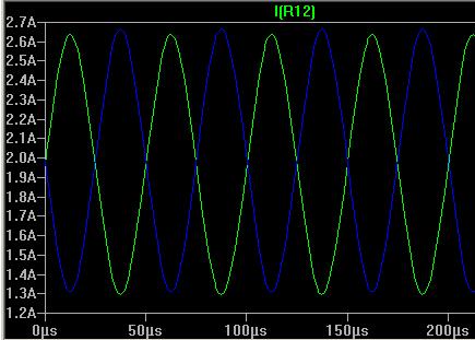

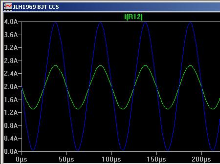

I will stand behind them anyday. And yes, they apply to the original JLH. As a matter of fact, JLH had a schematic of non-bootstraped design in his orignal 1969 article.
the way to look at this is to use the following circuitry (which was implicitly used in earlier discussion).
it is essentially your schematic, with the bottom being a current source. You can simulate this and see for yourself that the output will always be the same, as long as the phase splitter is perfect.
You can replace the Q1 (in your diagram) to see what happens when the two output devices have different gains; or you can change the value of I2; or you can insert between I2 and the base of Q1 with a current-controlled current source; or you can replace both output devices with current-controlled current sources and change their coupling coefficients to see how gains impact output.

the following is the same graph, after replacing the top current source with a 380ohm resistor. The resistor is selected so that Iq through the top output device is the the same (2a I think).
It is still a push pull, still a perfect sine wave (on the load). Except that now the gain on the top output device is that much lower.
