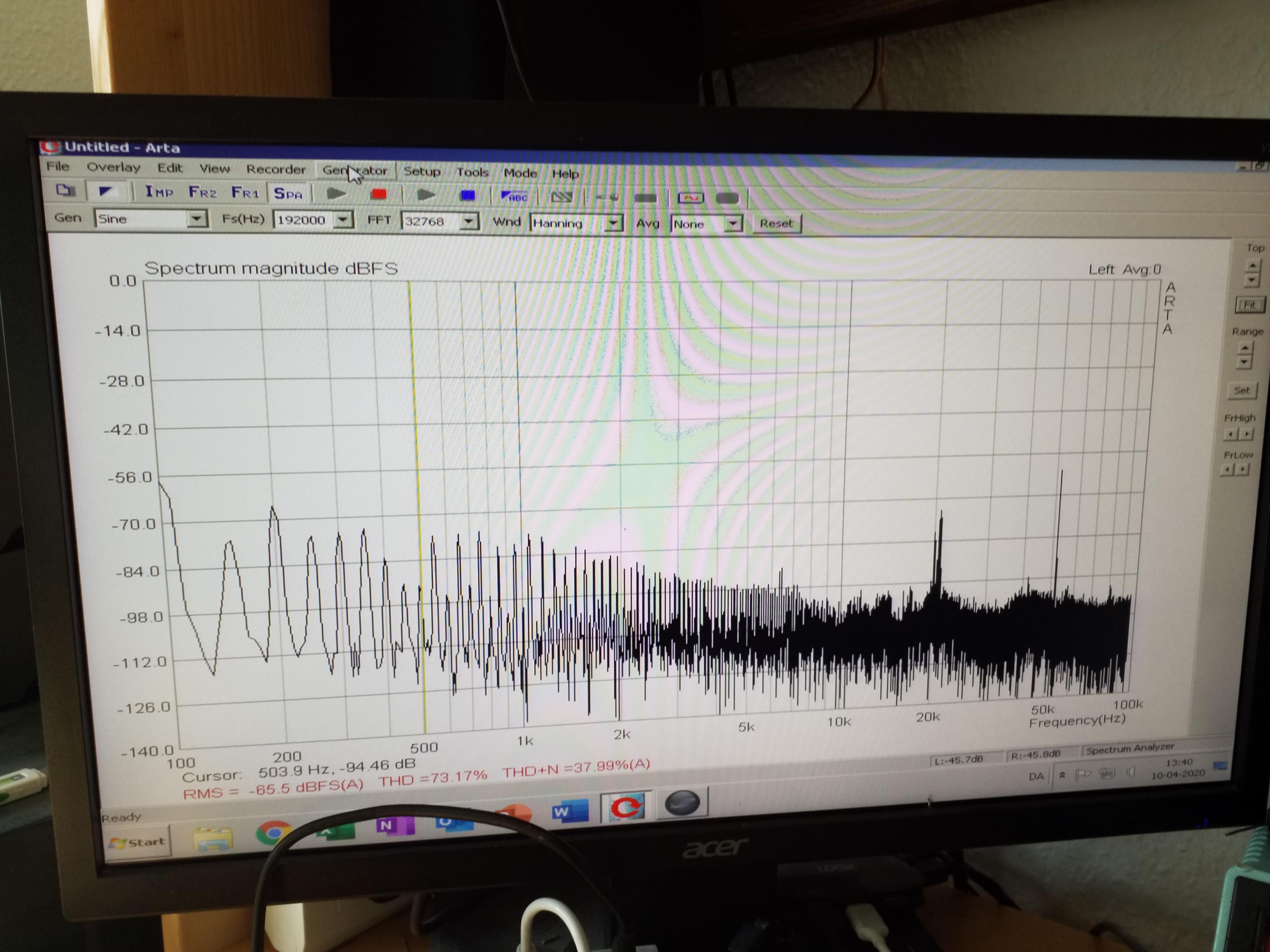

And here are two arta measurements, again at 1 amp bias and 1 volt rms across 4r7 resistor, 1khz and 10khz, I'm sure I can lower the noise floor more with better cable dressing and maybe crank the bias higher, but the outputs got alarming hot, still only using two outputs, and the insulators were some old I had laying around, I ordered some new ceramic insulators and to-3 sockets, do any of you have experience with the ceramic insulators??

I think everything looks fine for stability (others, please correct me if I'm wrong). Seems to be a lot of PSU ripple in the FFT. I have mostly been using switched PSU's or bench supplies for my JLH experiments, so they looked a lot cleaner, which means I have no idea how much PSU ripple is acceptable in the FFT. I never measured distortion with the cap across the load..
You could try the two-tone and multi-tone signals in ARTA too to get more on IMD. I actually like them better. I just check the single tone to get an idea of the distortion spectrum, but I think multi-tone says something about the 'distortion floor' similar to when it's playing music.

Yeah, looks like a lot of noise. Hopefully you can improve it when you finish your amp. Is it external or from PS? You can short the input terminals on the amp, if it's still there it's from the PS. Maybe some extra RC filtering to the low power part of the amp (everything except output transistors) could help if it's ripple from the PS. I think I did some sims on that earlier.
You can also try loopback on your sound card to see how much 'dirt' you have in that part of your setup.

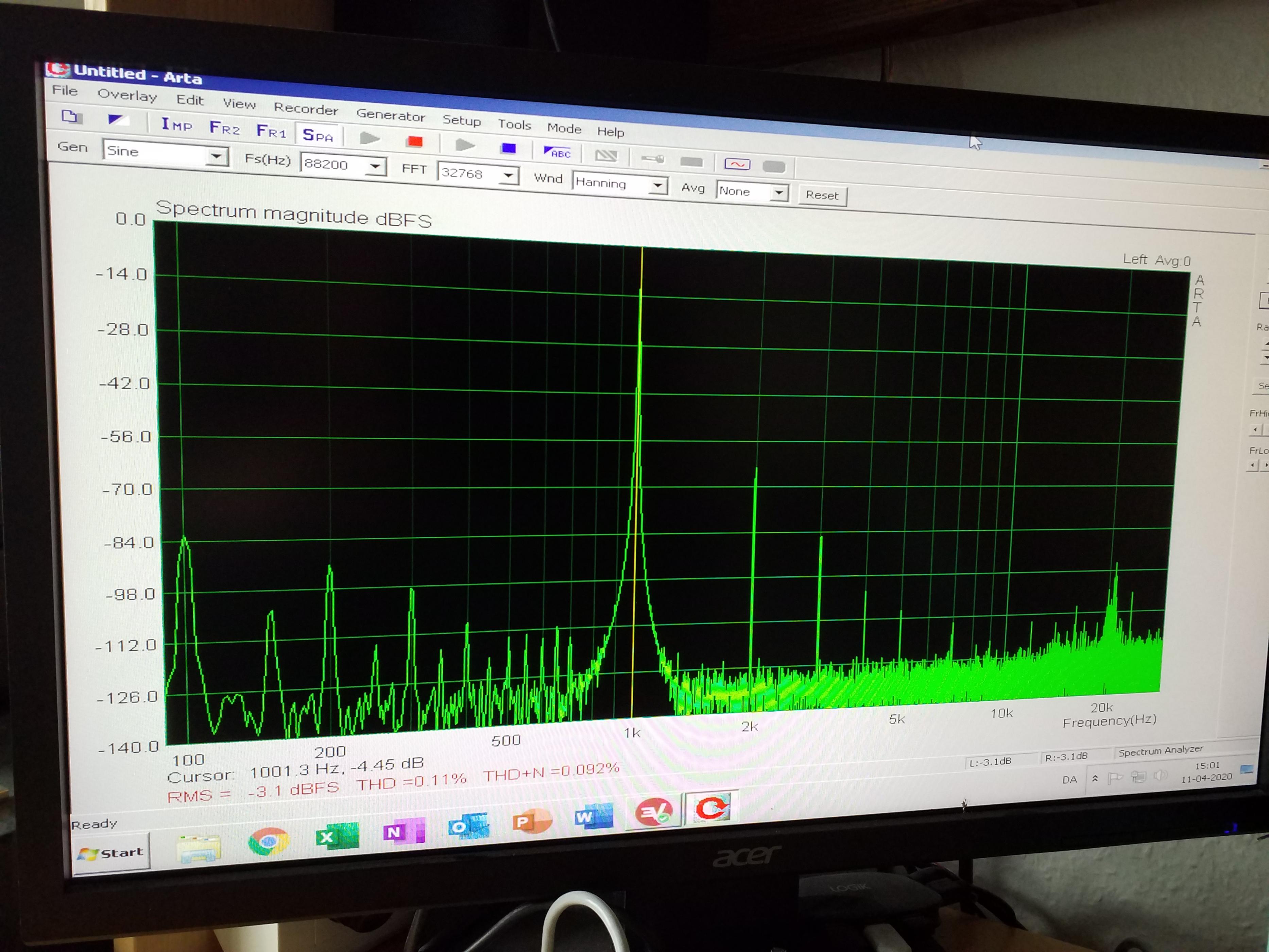

Have been working on reducing all of that noise showed on arta, the results shown in pics.
First pic is 1 khz looped back into soundcard, noise floor is okay.
Second pic is 1khz 1 watt much nicer than before, theres still alot going on in low frequency, with 1a bias theres 40 milivolt ac on rails, 3rd harmonics are better also
Now you are getting somewhere
You can average measurements to get the noise floor down a bit, but the distortion peaks are not drowned in noise, so it's not really needed in this case.
You can also change the windowing from Hanning to Kaiser7 or similar to get better resolution in the graph (you will see what happens when you change)
You can try to optimize the output and input levels to have as low distortion as possible in loopback.

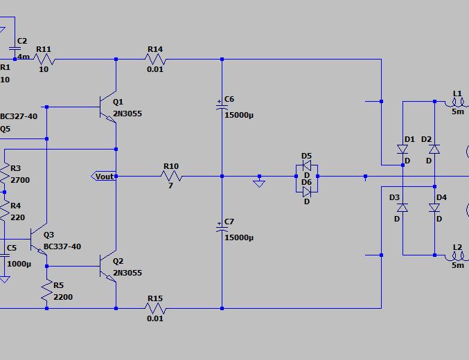

I was thinking the other day, that maybe back to back diodes between transformer center tap and rectifier caps center point would allow limited DC floating of the ground to avoid DC on the speaker while warming up. The dual supply version I tried (same one as amplidude) had more than 100mV offset at startup, slowly going toward zero while heating up.

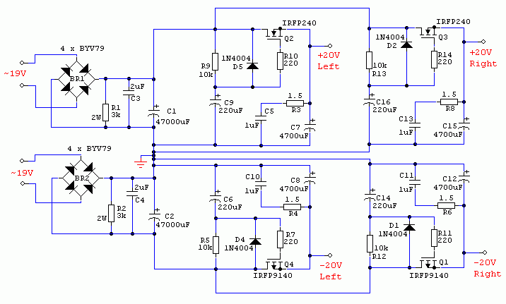

I was looking at the scheme below, I found it in pass f5 thread, and promises very low ripple, plus I have all parts already, I will study thread and schematic some more,
Your idea with diodes is unfamiliar to me, could you draw it up real quick with whatever is easiest

Something like this. Transformer to the right.
It should allow the ground to float within certain limits (voltage drop over diodes) which should be enough to cover the voltage offset seen on the output.
I'm not absolutely sure it works, but in my imagination it should, even though I have not fully thought it trough.. It would require separate grounds&capacitors (C6,C7) and diode pairs for each channel though. No problem with 2x mono setup. I'm sure somebody smarter can say yes or no really quick
