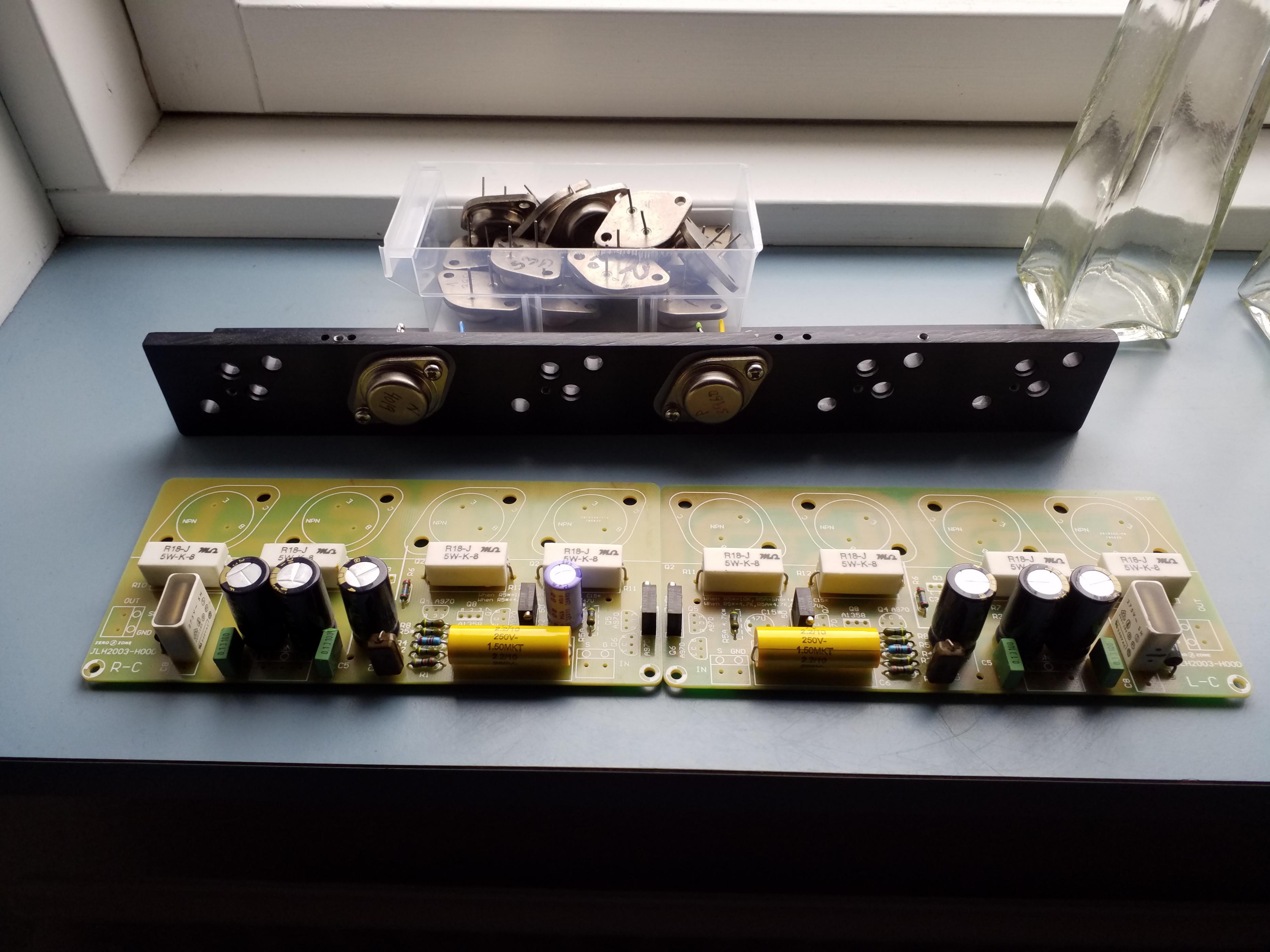

I'm currently building the jlh2003 amp with pcb from fleebay, I have a fair amount of sanken 2sc2608 could they work as output transistor?
Thanks in advance.

They could work indeed but if those semis are genuine NOS Sanken TO3 parts, they would be worth quite a bit of cash now. I think their best use would be in restored vintage class AB amplifiers, where their greater bandwidth and gain is a distinct advantage over standard power semis. However, I guess you want to keep them but haven't yet found a suitable project.
Otherwise, check that your amp doesn't become unstable with these and similar high performance audio power semis. Usually, if there is instability in simple class A amps, it can be corrected with just small capacitors shunting the feedback path but this still requires at least an oscilloscope and some familiarity with the problem to solve it properly.

Thanks for answering.
They are indeed genuine there are 12 2sc2608 and their complementary 2sa1117, but they are used, pulled from an old 90s high end amp.
I will give them a try, and watch out for oscillation, and should it happen I know where to turn...;)

I have the same boards that I tried with fast transistors, and they oscillated. It seemed to be some trouble in the upper area of the driver/ccs. After I put in 15003's it was stable. I never had oscillation problems with the older JLH version with bootstrap cap on the upper transistor.

It sounds like I'm heading for troubles,
I'm also planning to use the to3 alu angle shown in picture, cut of course to support 4 to3,
That means short cabling which also invites oscillation, but my build is low budget so I only bought a970, well it has to be tested in real life, maybe I'm lucky.
Another question i have is, how important is the 0r1 resistors value ? I currently installed 0r18, again because i had them, if it's no good i have lots of noble 0r22 5w cement, two in parallel.

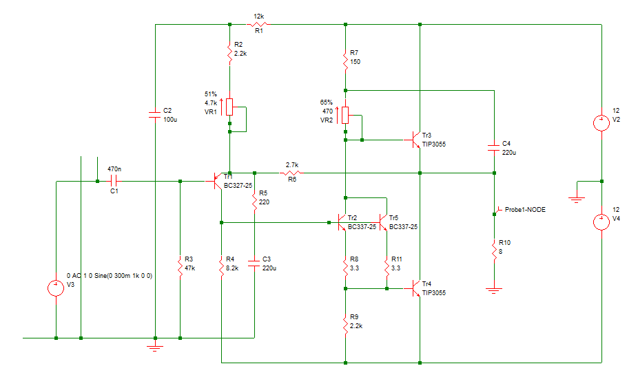

A simulation with your suggested circuit component list. Operated here at +/-12V with 8 ohm load. Distortion at 1W and 1kHz simulates at .035%.
Note that the components are rather different from the ones specified in previous post.Distortion will be higher if using 4 ohms and pots will need retuning.
Distortion with 8 ohms creeps up to 0.15% at 7W.
Actually this is one instance where the original hometaxial RCA 2N3055 works better because it had virtually zero quasi-saturation. That makes it a lot better at low voltages than any epi equivalent device I've seen - at 1kHz though. Beyond 10kHz it would struggle.
But I'm sure the simulator I'm using does not know about q-s anyway (I think it can be made to with a model/spec tweak) so is likely to be giving an optimistic distortion figure at higher powers.
