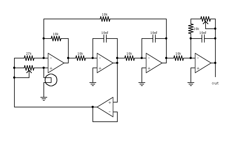

An idea. (twin leds)

Actually not. A mistake on the diag. is that 1k resistors should be 10k. The "filtering action" around the diffamp is a bit nervous and must be tuned to the osc. freq.
The diode-stabilized circuit as on ESP site would have a better behavior if tweaked around the diffamp. Especially the diode clamp would be imho better if the I/V knee would soften; there are simple ways to do that, fe. with a series resistor. A small SMD bridge would be beneficial as well. Best would be B-E transistor junctions; but using matched duals would defeat the purpose of "cheap & cheerful".
I mean the diode svf osc leaves one last opamp for additional filtering so maybe that could add some to the final performance.
With the lamp-stabilized osc, a separate 071 could be used as the lamp-driving buffer (!) also leaving the 4th opamp free to do some post-filtering and signal cleanup. Separating the buffer would also mean that the "signal" opamps be thermally decoupled (and electrically as well) from the lamp buffer amp.
The 27k "tweak" resistor could be routed directly from the opamp B in this case.
The thing to look at is where you start. A degenerated diode limiter would be about - 12dB F3, the Elektor I measured at -66db F3 ( 3rd ) at the lamp and no obvious other harmonics ( only thing I could measure, the rest is too low ). If we take 12 from 66 we get 54 dB difference in the starting point. If we remove 54 from 108 of Elektor we get - 54 dB which is about where the Analogue Cookbook SVF gets before the 91K 10 K phase summing. As you saw my version got -70db or better. The simulation posted was very interesting.

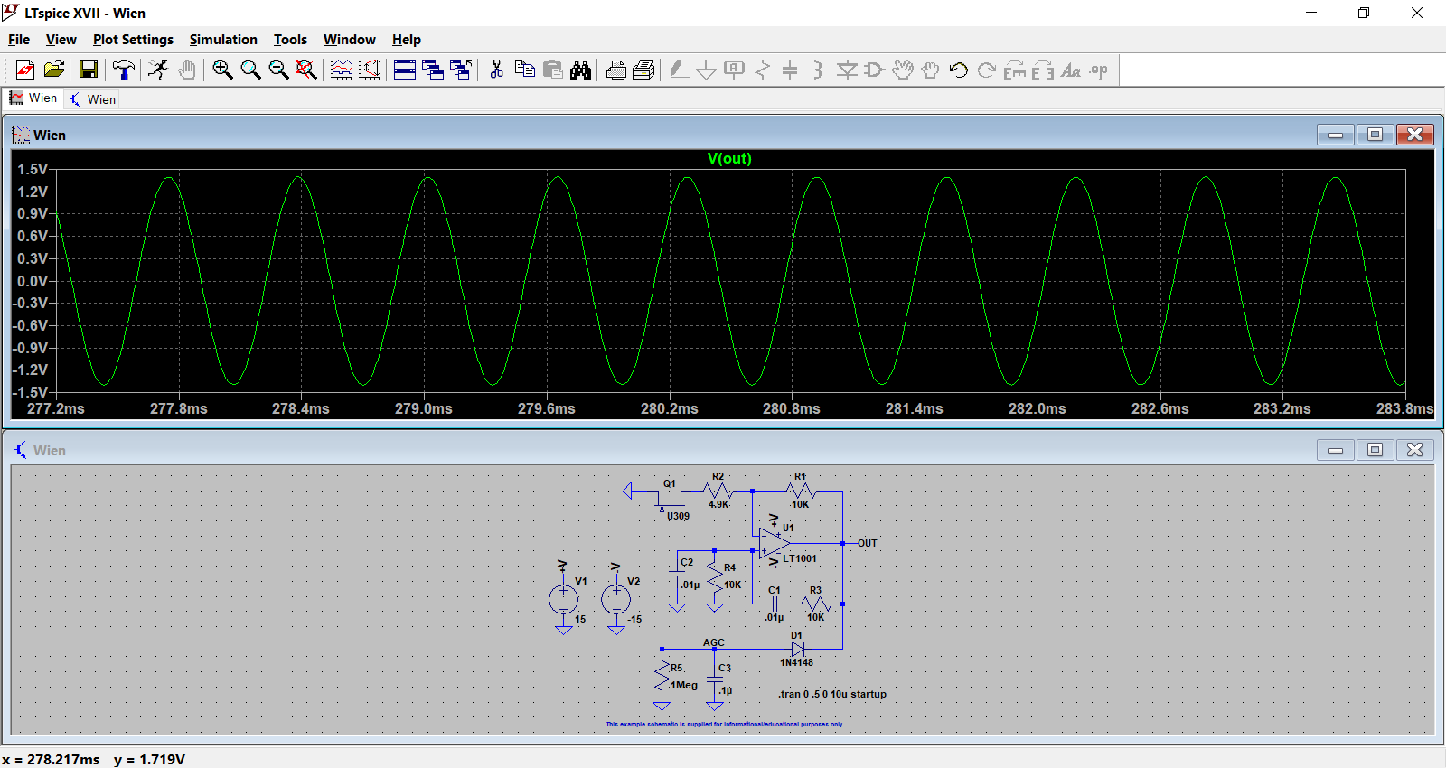

Look how good a lamp can be.
Injection-Lock a Wien-Bridge Oscillator | Analog Devices
... but they used a LT1468 turbo-opamp with it.
In above post I suggested to try a physically separate opamp to drive the "lamp". This would separate the "signal" tl074 from the buffer opamp, and free the 4th opamp to perform some additional post-filtering. Like the picture below.
Wrt the diode-stabilized circuit, a diode-quad (fe a bridge) would smooth the flat-topping by itself, but could be piece-wise further smoothed with series/parallel resistors. That would no doubt bring the 3rd down by a coupla dBs. But how much?

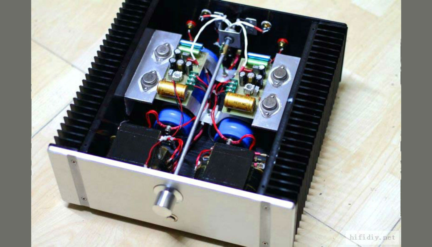

Hi All,
I am thinking of purchasing a Taobao JLH 1969 Class A amplifier, the "HD1969-2018 version", 718.00 yuan (about $113usd plus shipping). Any feedback on the photos ? I wish I had the ability to build the JLH 1969 Class A amp myself, but I already have too many unfinished projects.
Also found this website on the JLH 1996 Amp on a Russian website, any thoughts ?
Thank you !
P.S. I would would welcome any suggestions for a builder to help me complete some of my DIY projects.
