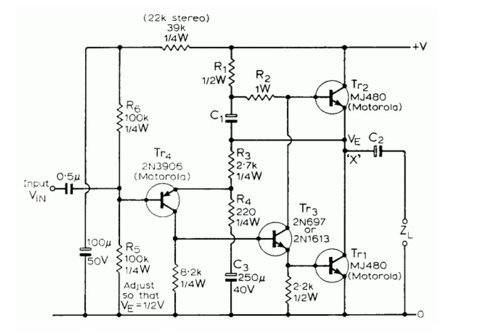

When I tried to adjust the voltage, the trimmer (100K, left on the picture) was not sufficient to have 1/2 V between transistors. R4 is 75K in the kit (instead of 100K) and the original 39K is 10K. The correct value for R5 with these values seems around 104K. I put 103K, but voltage is not yet symmetric.
JLH in his 1970 article fixed R4 and R5 to 100K and replace 39K with 12K.
He wrote "The necessary value of resistors R5 and R6 to give an entirely adequate accuracy in the mid-point voltage setting can be predicted, and the suggested amended values are shown."
I work now on a second version of the amp, and I'd want to calculate the value of R5. I can put a trimmer, fix voltage, unsolder... But it's not really easy with metalized holes on the pcb (I damaged the pcb I'm currently using when I unsoldered the 100K trimer). So I asked if somenone know the calculation.

Calculating isn't easy (due to current gain differences between transistors) but the values needed are derived empirically like this...
The emitter of the first transistor (TR4) will be around one volt less than the midpoint voltage needed. How do we know that ? Because the current in TR4 is around 350 to 400uA which would drop around a volt across the 2700 ohm. The voltage across the 8.2k is the total of the two base/emitter volt drops of the two lower transistors. Say a total of 1.5 volts. That gives a current of about 180uA in the 8.2k and a similar current will be flowing to the base of the driver transistor give or take... depending on the gain of the devices used. So two times 180uA is 360uA total which is in the ballpark mentioned above (350 to 400uA).
From there we can say that the base of TR4 will be another 0.7 volts lower than the emitter (the standard Vbe volt drop for a silicon transistor). So we will need to set a voltage on TR4 base of around 10.3 volts if running on 24 volt rails.
10.3 volts gives us a definite voltage to aim for with the resistor network and so the resistor values can be calculated. If R5 is 100k then we need a current of I=V/R which is 10.3/100,000 which is 0.000103A or 0.103 milliamps or 103uA.
The two other series resistors, R6 and what was the original 39k therefore need to drop 24-10.3 which is 13.7 volts. Ohms law then gives us a total value for these two of 13.7/0.000103 which is 133009 ohms.
How you split that value is up to you ;) but the original 39k seems a fair choice. If you did that then R6 would need to be 133009-39000 which is 94k
So the original values seem close to the mark... even more so when you account for the fact that the base current of TR4 will syphon of a tiny bit of current from the divider chain.
You can flip that calculation around and say that the 39k and upper 100k are fixed. We know 24 volts is applied to one end of the chain and that we need 10.3 on the transistor base.
We have a current of (24-10.3)/139000 which is 9.85E-5 or 98.5uA.
So R5 needs to be 10.3/9.85E-5 which is 104568 ohms. Again we have discounted the tiny base current of TR4 as it has minimal impact on the calculation.
So you can see the original values are pretty much ideal.

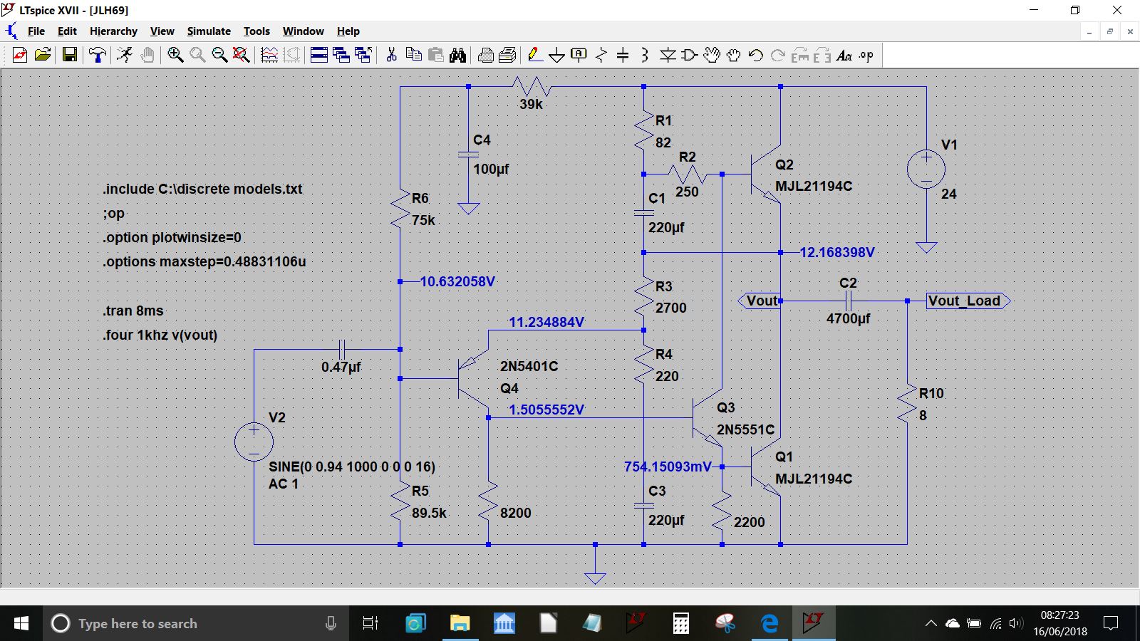

We need to be very clear that the resistor reference numbers in your kit agree with the JLH69 diagrams.
R5 was the 100k to adjust the midpoint voltage, R6 was a 100k above it and the 39k had no reference number.
If R6 and 39k in this diagram are in fact 75k and 39k then you will find that R5 needs to be lower, probably around 91k

I reverse the pcb of the kit (no schema given with the kit :confused:), and draw this schema : (I perhaps made errors)
Resistors are in this schema R8, R9 and R10. With this schema, R10 needs to be more than 100K.
