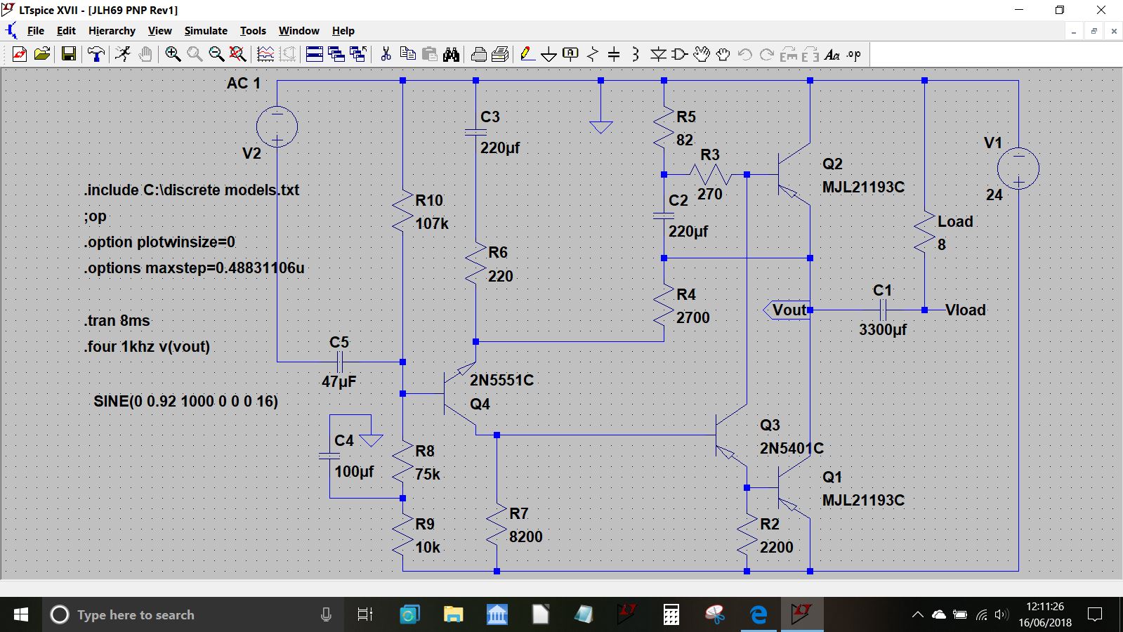

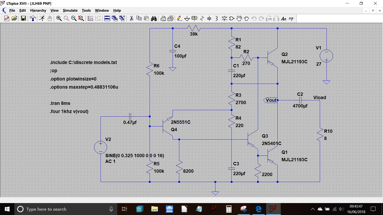

the kit is not on the same schema as the original design, because 2SA1216 are PNPs and not NPNs. But I have the original article of JLH and yes, we are talking about R4, R5 and 39K of the origib=nal schema.
I reverse the pcb of the kit (no schema given with the kit ), and draw this schema : (I perhaps made errors)
Resistors are in this schema R8, R9 and R10. With this schema, R10 needs to be more than 100K.
That's an interesting take on the design because normally if you change a design from NPN to PNP (the outputs) you would also change the design to positive earth, which this doesn't seem to do. +24 volts would become ground, and the amp would operate on a negative 24 volt rail.
Its a subtle difference but could be quite important to the way the amplifier deals with hum/ripple on the rails.
I do have a PNP simulation from ages ago and it should look like this. The rail is now a negative value, 27 volts in this case.
What's disturbed me is that when I draw the schema, R4 and C3 of the original JLH are on the same side of the circuit as C1 and R3. I looked twice, but on the pcb, (R1, C1) and (R4, C3) are connected to ground in parallel, divided by the 2.7K R3 (all the references are ones of the orignal JLH69 schema)
This shows your version. Remember that in simulation, the rails are perfect and so both ground and the rail are at the same impedance as far as AC signals are concerned. One possible problem with a real build would be that the bootstrap cap and resistor currents would not have to interfere with the input ground current.
In the positive earth version that issue doesn't exist.
The whole concept of the amp is subtly changed by this arrangement (your diagram) as such things as the collector load resistor for Q4 (8k2) is now able to have ripple and noise from the PSU directly injected into it whereas before it was at ground potential. The same applies to R2, this is now returned to a 'noisy' point of the circuit rather than ground.
In practice this will change the nature of the distortion of the amp, with the changes altering with output current. It also makes the PCB layout far more critical to minimise these problems.

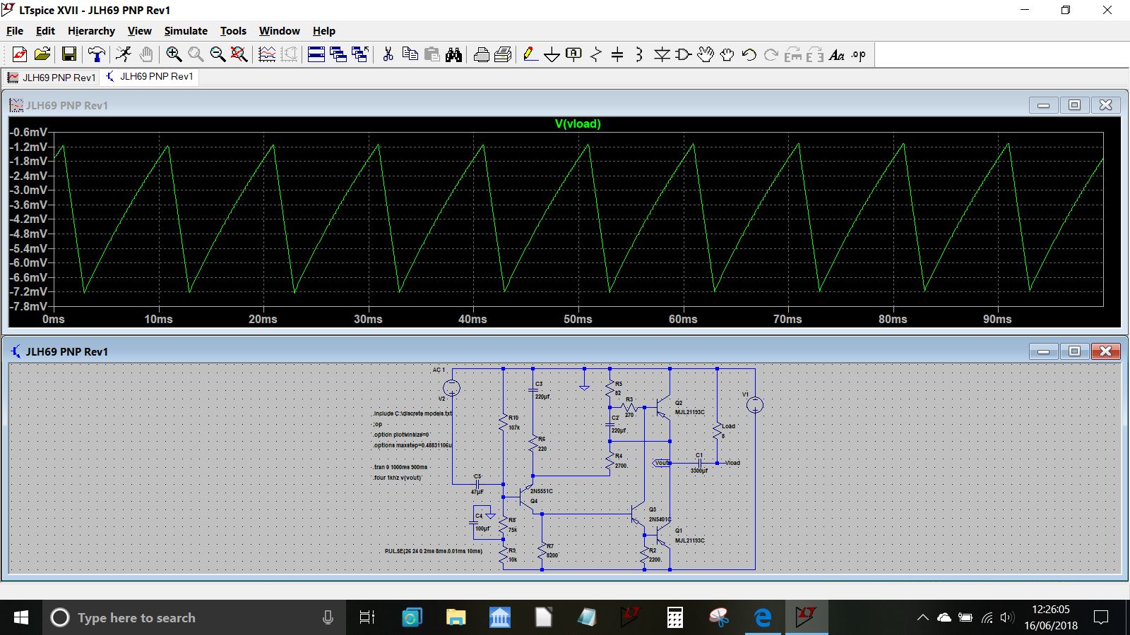

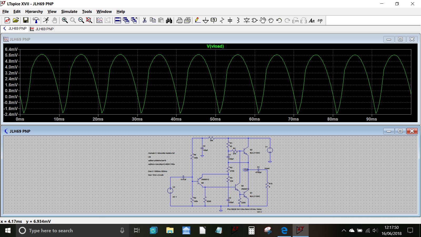

Your version and the positive earth version showing how simulated 100Hz ripple on the PSU is changed in character. The positive earth version is much less spiky in nature, your version passes the ripple through pretty much as it appears on the rail. At HF (SMPS) it could be worse.

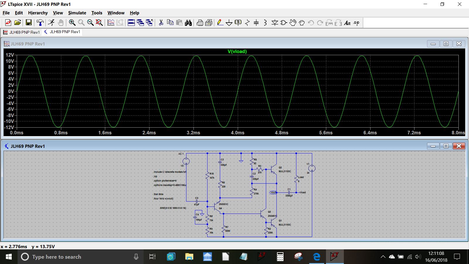

I tried your maths on the schema, but I don't managed to calculate R10 value. On your simulation, I see that the good value is 107K, in theory.

24 volt supply, midpoint of 12 volts. The emitter of Q4 will higher than this by around 1 volt. It is higher this time because have flipped all our polarities of transistors. The base voltage needed will therefore be around 12+1+0.7 which is 13.7 volts. Remember for an NPN the base is 0.7 volts or so higher than the emitter, for the PNP it is 0.7 volts lower.
75k and 10k give the equivalent of an 85k resistor and we know now that one end will be a 24 volts and the other at 13.7 volts. That means 10.3 volts is dropped across the 85k giving a current of 0.121 milliamps.
From there we can say that for our unknown resistor we need a value of 13.7/0.121E-3 which is 113k. In practice the simulation worked best (most symmetrical clipping) with a 107k. Its close though.

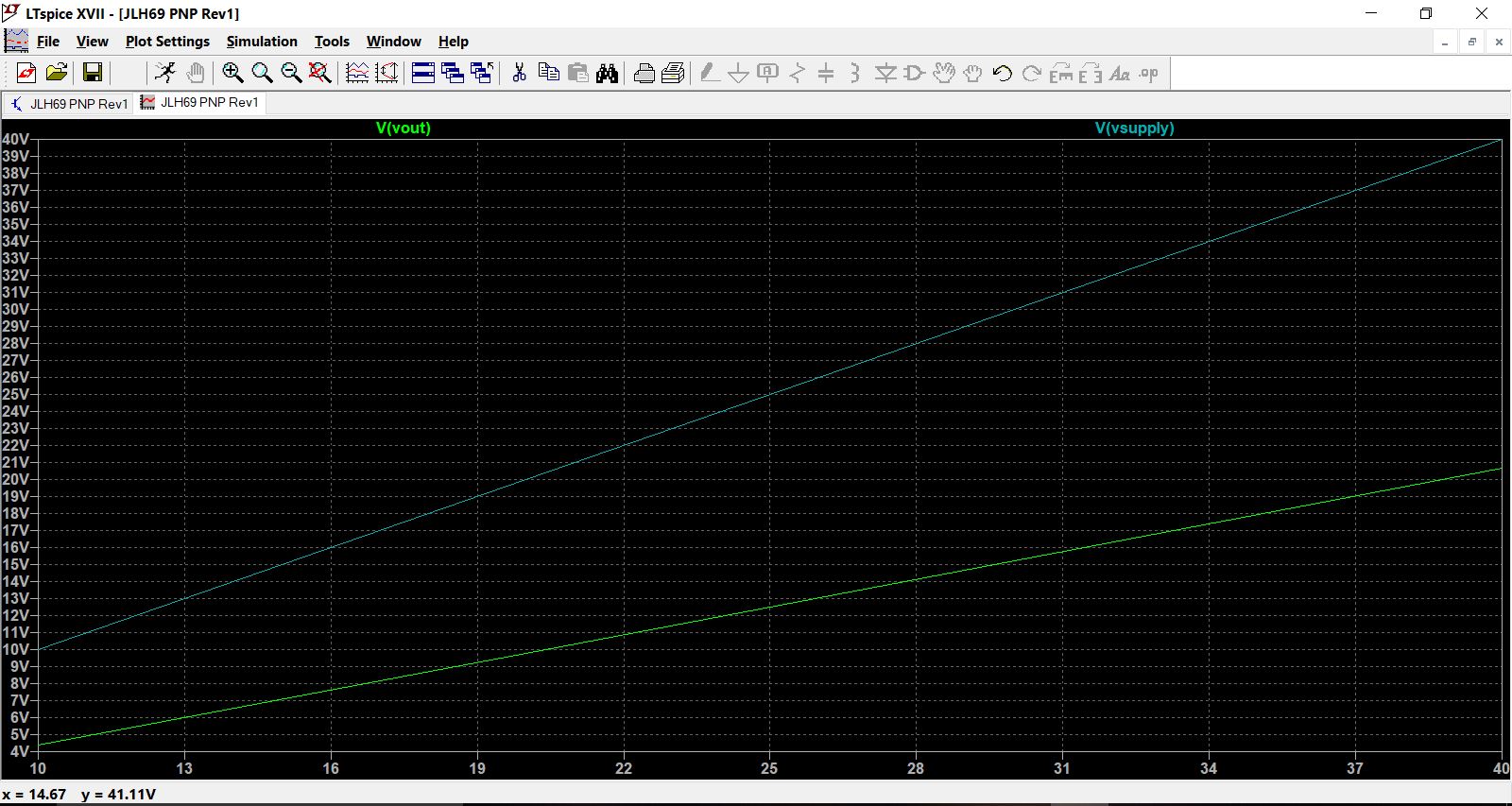

With an increased rail voltage, how this value change ?
Lets try it. This shows stepped values of supply up to 40 volts. It tracks pretty well if you read off the supply voltage and then look at the midpoint voltage.
