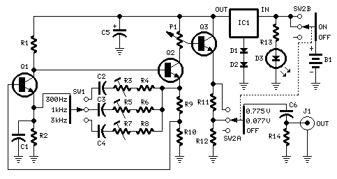

I have an aversion to CMOS logic tone generators. Goodness knows, I've built and experimented with enough of them. It's way off-topic but I suggest something that comes straight out of an audio tinkers junkbox, uses common audio BJTs and builds on a breadboard in less than hour - no fancy envelope stabilizing parts or anything to buy, for me at least. Spot-frequency Sine wave Generator - RED - Page92
My only regret is that a 5V USB power source isn't enough. Still, 0.11% THD @ 1kHz ain't bad for a simple circuit and will beat most logic derived generators.
I built a single 400Hz tone version and can scarcely hear any difference in comparison to 16 or 24bit software sources, which, if you're serious about high quality tone generation and application, is the way to go, needs no parts other than a suitable quality DAC and is often free! This site is simple, but not completely free. Go to the generator page and try a tone or two, you might find that your desktop system isn't so wonderful: Dynamic Test Tones

Ian, What seems to be lacking in these threads is simple ways of testing the end results. That circuit looks too simple to be stable. Usually a Wien Bridge needs a non linear resistance to work well in the feedback loop. Wiens can have a fixed arm R2C1, Usually ones made like this have different outputs at different frequencies,

As said Nigel, I built and used the Red circuit myself in a comparison with an on-line tone source of 16 and and 24 bit tones. I have a reasonable 24 bit DAC coupled to the PC and then to a desktop audio system based on Tannoy reveal monitors. I test distortion with a Quantasylum QA400 sound card and software which you'll find commented on and supported by Richard Marsh and other members here.
The generator is a spot frequency type, so frequency and levels are preset for any or each discrete tone. That's nowhere near the stability problem presented by general purpose analog instruments with full coverage from 20Hz -20,000kHz. On my tiny matrix board assembly, I measured 0.17% THD at 400Hz and 0.12% at 1kHz 0dBu - very close to the spec.
The point of it is that it's analog, simple, quick and does a good job of providing a clean tone where required. If a full range of tones or continuous coverage and sweeps are needed, the hardware issues like quality pots don't make this easy or cheap for either approach.

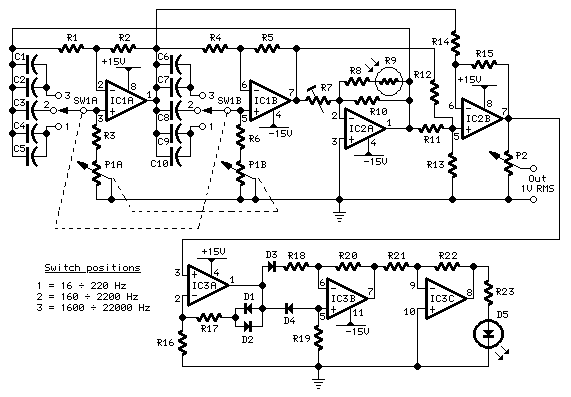

I hit an interesting problem with this idea. It will be virtually impossible to be 20 dB lower in distortion than the JLH. This is the standard usually required. 0.08% = 20Log 0.0008 = -62dB. If we take 0.03% suggested for my BC327/337-40 it's -70 dB via simulation. That needs a sine-wave -90dB pure or 0.003%. The best I will get I calculate is -75dB. What this allows is to say working well enough. I have real doubts any 1960's test gear was better than that.
Here is a design that looks very interesting. The lamp takes distortion down to - 96dB or better. Compared with a Bubba oscillator -40 dB is what it gives. And they often don't work. Same op amp count. My State Variable Filter Oscillator using diode limiter was about -65dB. The lamp pushes it down 30 dB as it always is a sine-wave regardless of where in the circuit. 2 x 1N4148 diodes gives a squared wave ( between sine and square ).

This adaptation of Rosens well-known design will get you down to 0.003% and better if you want a wide range DIY oscillator. Note the opto-coupled stabilization here. Very nice compared to my simpler build of it that uses either the unobtanium RA53, diode/ resistor network or lamp stabilization Finding and paying for a decent dual gang pot. is often the limitation though.

I just did a little layout for the oscillator using 2 x NE5532. I will risk the stability as the higher current is good to drive a lamp. The Elektor design claims claims the lamp isn't for gain. Instead it gives phase changing results. This might say how a TL074 give -108dB at 1 kHz. I only have a 28V 40 mA lamp. Hope it will work before getting his recomendation. It's a very simple circuit.
That's very much the question. He says about NE5532 in passing with 9dB lower distortion. The real example is TL074 which suits fine. TL074 is the most stable op amp I ever tried. I have strapped all of it's input and outputs together ( all in's to in's all out's to out's ) and made it work! That's because it has a resistive output and JFET input. Not many op amps get close to allowing that.
