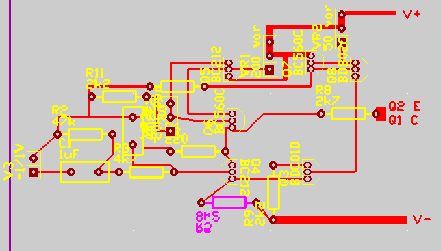

I made my first ever pcb layout today for the JLH 96 amplifier. I hope it is any good. Suggestions and comments are welcome.
Some notes:
R10 is off the pcb because this one gets hot.
The routes can be substantially bigger.
It isn't very neat.
Some Transistors have wrong device numbers.
But besides these points, would it work?

Hi LaZarus,
You may have to give us better/clearer overlay part number in order to make any sense out of it. In my experience the R10 just get a little warm, not hot to touch, what Iq are you setting it to?
I can not see where, how the R6 connect to signal ground.
Chris
P.S. What version of 1996 JLH are you referring to?
What is that R11 2k2?

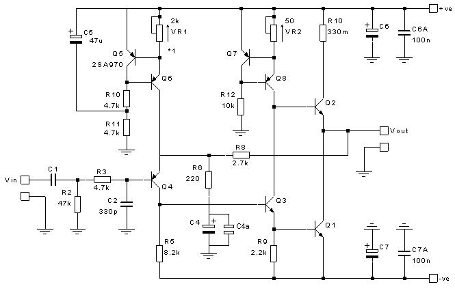

I have used this schematic, the updated '96 version.
Is it better to use a ground plane on my pcb layout, which will be connected to a star ground on my chassis, or an other grounding topology?
Here is my revised pcb layout.

LaZarus said:Ok, above is my new pcb layout, with wider tracks, place for a bigger capacitor and some other changes.
Any suggestions are still welcome.
btw, the decoupling C's still have to be added.
cheers
Depending on your grounding scheme. The way I would do it IMO is to group the signal grounds(R2,C2,R6) and group the dirty grounds(R11,R12,C6,C7) separately. Each group then join to the star ground.
Chris

Please check section(5.6 DISTORTION 6: Induction from supply rails) at Douglas Self's web site
http://www.dself.dsl.pipex.com/ampins/dipa/dipa.htm#4
That was the experiment I tried with my JLH with positive result.
Chris
