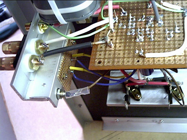

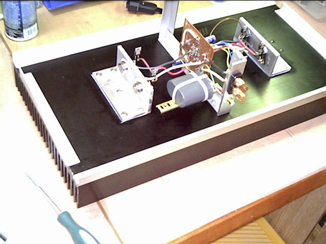

argo said:chris,
Good work indeed.
What is that big grey can next to input RCA - an input capasitor?
argo
Yes the grey oil can is a 2.5uf input cap. I don't know whether it will work or not, for I have no alternative caps around for now.
Still trying to source a suitable input cap. But if this one work and sound good, then it will stay.
Chris
