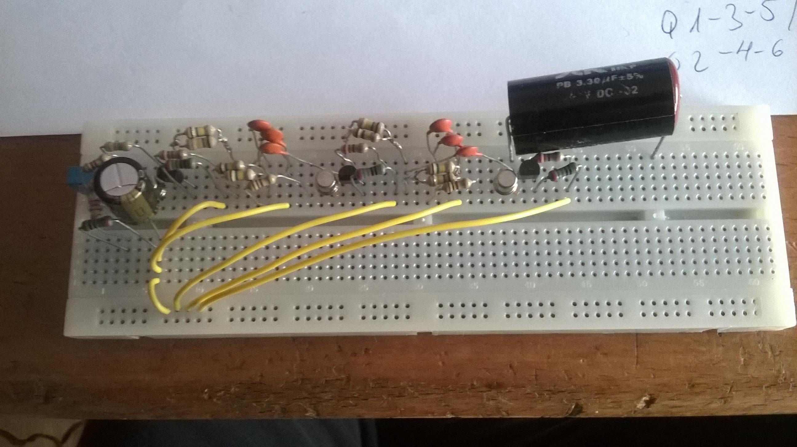

@wrenchone
My friend dai (diyaudio member) have enough stock 4393 for the followers but not for the current sources however he has some 2n5433 & 2n5434 these are long channel devices that are more suitable for current sources than the 4393 could I using a current of 5 to 10 mill amps?

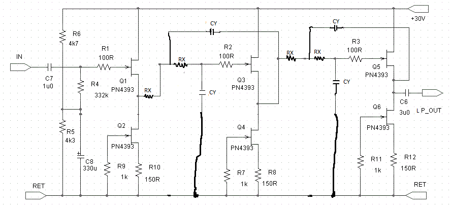

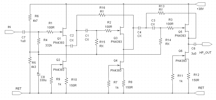

If people are opting for surface mount components, the sensible option is to try and avoid matching if possible 'cause its expensive/a pain. Recall I posted a set of mix n' match elements in posts 32 and 35. These can be cobbled together to realize a unity gain cell/follower with the components you have on hand.

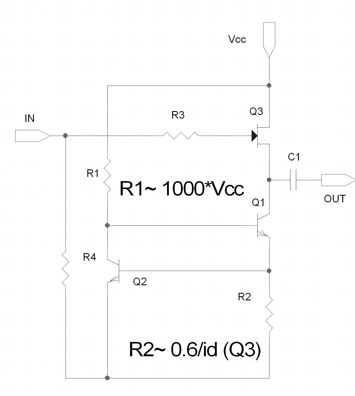

The circuit shown in the attachment uses current source "B' from post 32 of this thread, which is pretty non-critical as to the bipolar transistors you use, as long as they're NPN. I'm sure I'll get pundits yammering away that you can't get decent results without yada yada yada, but it really doesn't matter that much for this application, a dirt-stupid follower for a line-level input. What do you have? If you have a cheap VOM, these days it most likely has a function that can read the HFE of an NPN or PNP bipolar transistor, and you can select for max gain from the devices you have, if you think it matters.
The device on top of the current sink is depicted as an N-jfet, but it could be a mosfet (N-channel, enhancement or depletion mode) an N-channel jfet, or even an NPN bipolar. It's a relatively non-critical circuit with a pretty wide window for success.
R10 and Q2 determine the current through the first Follower.
measure each follower pair and add them up to determine the total quiescent current demand.
Allow for current through bias string, R6+R5. I increased these to 9k1 and 10k to reduce current demand.
The absolute maximum current demand is Iq +-Iq for a symetrical waveform.
But in practice the more likely maximum demand is ~1.2*Iq to 1.5*Iq.

If the gm and the Idss are very similar, then the 220r source resistor will reduce the Id to a very similar level.
You get that by selecting the same type, that gets the gm to a similar level.
Then you select by Idss. That gets you to a slope region on the gm curve.
Then check/measure what Id you get for that device with 220r for Rs.
That Id is your Iq.
Power dissipation (Pq) is Iq*Vds and should be <<Pmax. I aim for Pq<25% of Pmax
