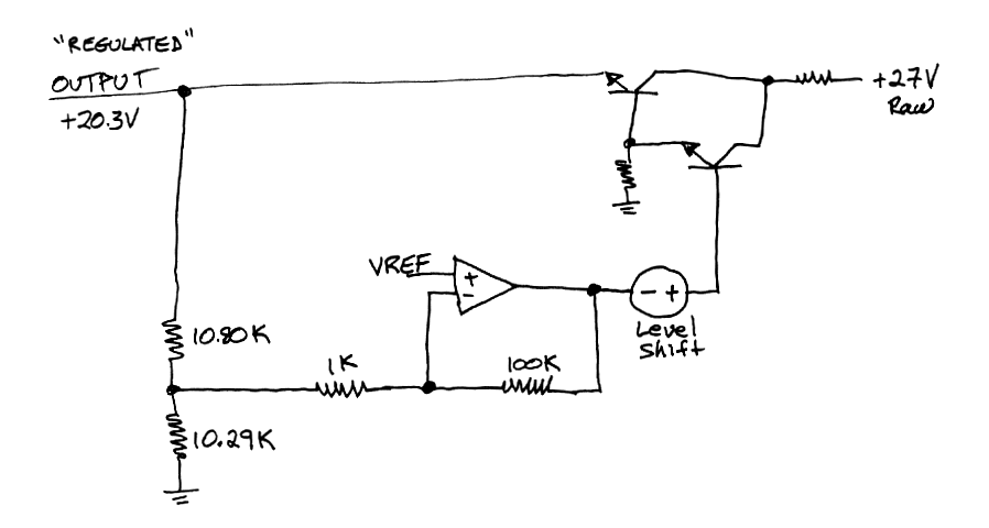

On page 52 of the article, the author was surprised the voltage regulators did not use the usual loop feedback for regulation; which is the case here. He suggested a capacitance multiplier instead; maybe the cap [100 uF] on the output of LM334Z at the base of 2N3440. Also, the author said the dual PSUs are stacked [as shown], and use the same rather than complementary components; like dual PSUs using uA723. He thought this is is beneficial.
Joined 2011
Gosh, that 100K resistor lowers the gain of the NFB path (from Vout to Darlington base) to about eight: [-7.72 according to SPICE]. The power supply's closed loop output impedance will be high but extremely wideband. Original!
Hello Mark. Is it possible that the 100 uF capaciance of the cap in the level shifter is also multiplied by the gain of the compound bjts? If yes, then this regulated PSU used a limited NFB plus capacitance mutiplication; a best of both worlds.

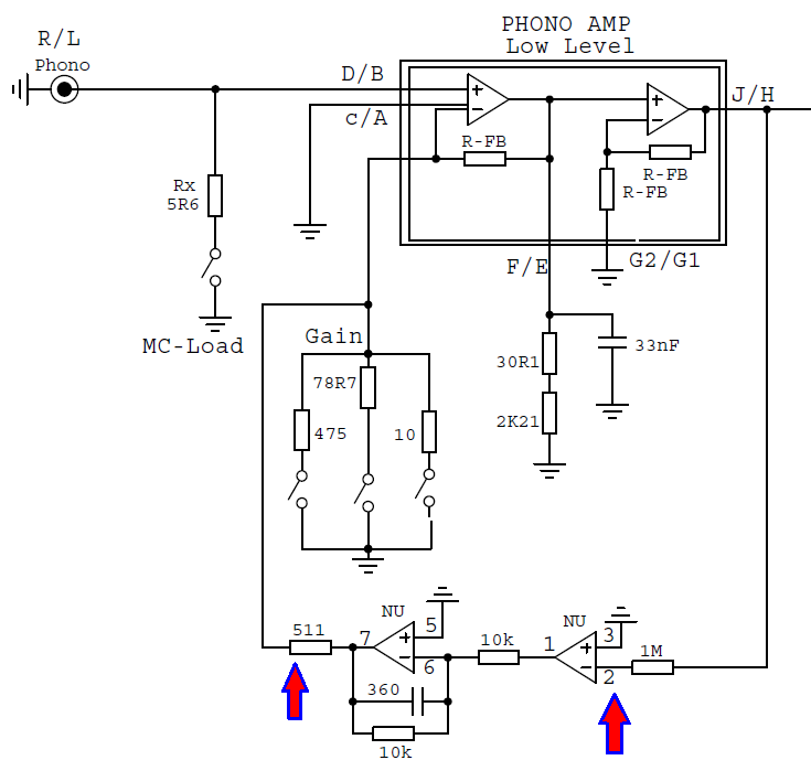

here now the schema of the signal gain stages (phono/RIAA and line amps).
The schematic puzzles me in (at least!) two places.
  1. Very low resistance (511R) between servo-out and feedback node
  2. No NFB from output to input of servo 1st stage; 1M resistor does nothing
See arrowheads in attached schematic. (I removed some clutter)
The 33nF capacitor (RIAA equalization?) directly shorting the output of the 1st forward path gain block to ground, might offer a hint about its internal architecture. VCCS? VCVS? CFB? etc.

Hello Mark. I find the circuits uncovered by Andreas quite interesting. My impressions which track your concerns above are:
  • The resistance [511R] is in parallel with that engaged by one closed switch [or none]. The resulting equivalent resitance determines the voltage gain of the 1st gain stage of the module per the standard equation[1+Rf/Requiv].
  • The first OA of the dc servo is operating open loop, and in the inverting mode. The 1 Meg converts voltage at the module's output to current so as to bias the non-inverting port. I can also imagine a ten or higher Meg resistor between the output and inverting ports from /due to leakage between the pcb traces so as to close the loop instead.
  • The second OA of the dc servo is operating as an inverter with a gain of -1; plus the function of a low pass first order filter.
  • The net phase due to the servo OAs in non inverting. The first stage of the gain module provides the needed phase inversion [reversal of dc] because the dc servo output via 511R feeds its inverting port.
  • Amazing the servo loop is stable, and must give tight servo or zero dc [no loose+/- millivolts] at the output of the gain module.
The missing circuit element in the servo first stage, is the integration capacitor. Maybe it's hidden behind something or under something, on this PCB.
Bob Cordell's book, p.160 (Figure 8.5) shows an example schematic.
Your analysis makes full sense; thanks. I should have remembered; because I've used this classic [integrator] circuit in projects for dc servo'ing.
Thank you for your advices in this schematic.
Many errors are still present. It is a mixture between several design errors from Rowland itself and my own drawing errors.
The missing resistor I have overlooked - there is a associated place present (two pieces through hole solder eyes/each resistor) - OTOH - the resistor isn't equipped (NU means "Not in Use").
The 511R resistor has the correct value according PCB - but please note: the offset servo ICs are also not in use, only the sockets are present.
I doubt, that the 33nF capacitor (RIAA equalization?) does directly shorting the output of the 1st forward path gain block. My estimate is the use of an internal additional serial resistor (like at the second filter part for RIAA - where this resistor is outside).
first update of the schema in the attachment.
No informations concerning post #53? Particularly to my first question?
